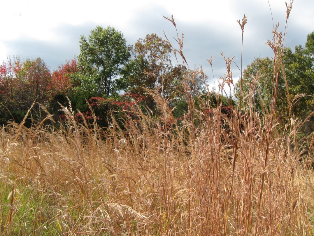

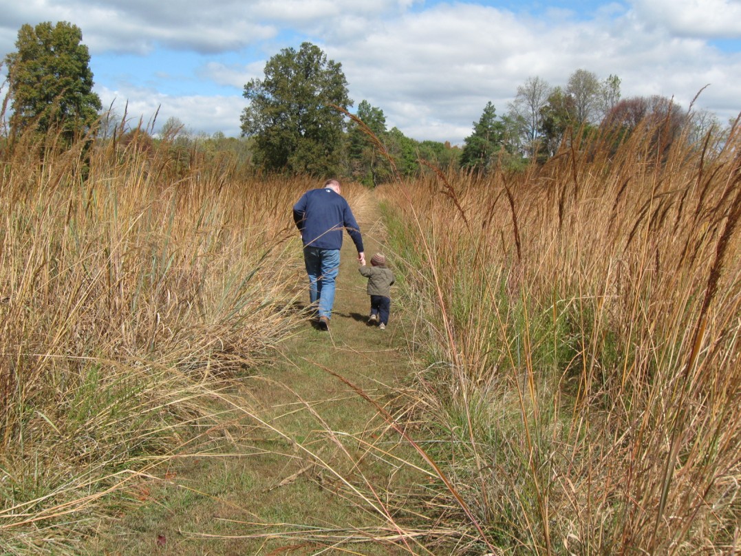

We put in 3-4 acres of prairie grass seven or so years ago and haven't been able to burn it. I've mowed it several times because of scrub trees and bushes, but that has resulted in thatch and no game birds. I don't think it has hurt the grass.
The field is surrounded by woods and I won't burn without the aid of the local fire department. We have just moved here full time after it being a weekend place for 25 years, so I hope to get a burn in this spring. I couldn't get here when the fire department was available and the weather was right.
The grass is still beautiful and gets more so every year. We haven't had rain since July and the grass has still grown. My son is 6'4" so you can see the grasses are really tall.
We love the grass and it has been well worth the cost. I'd get back in touch with the state folks and see if any programs have changed or if they could help with the burn.

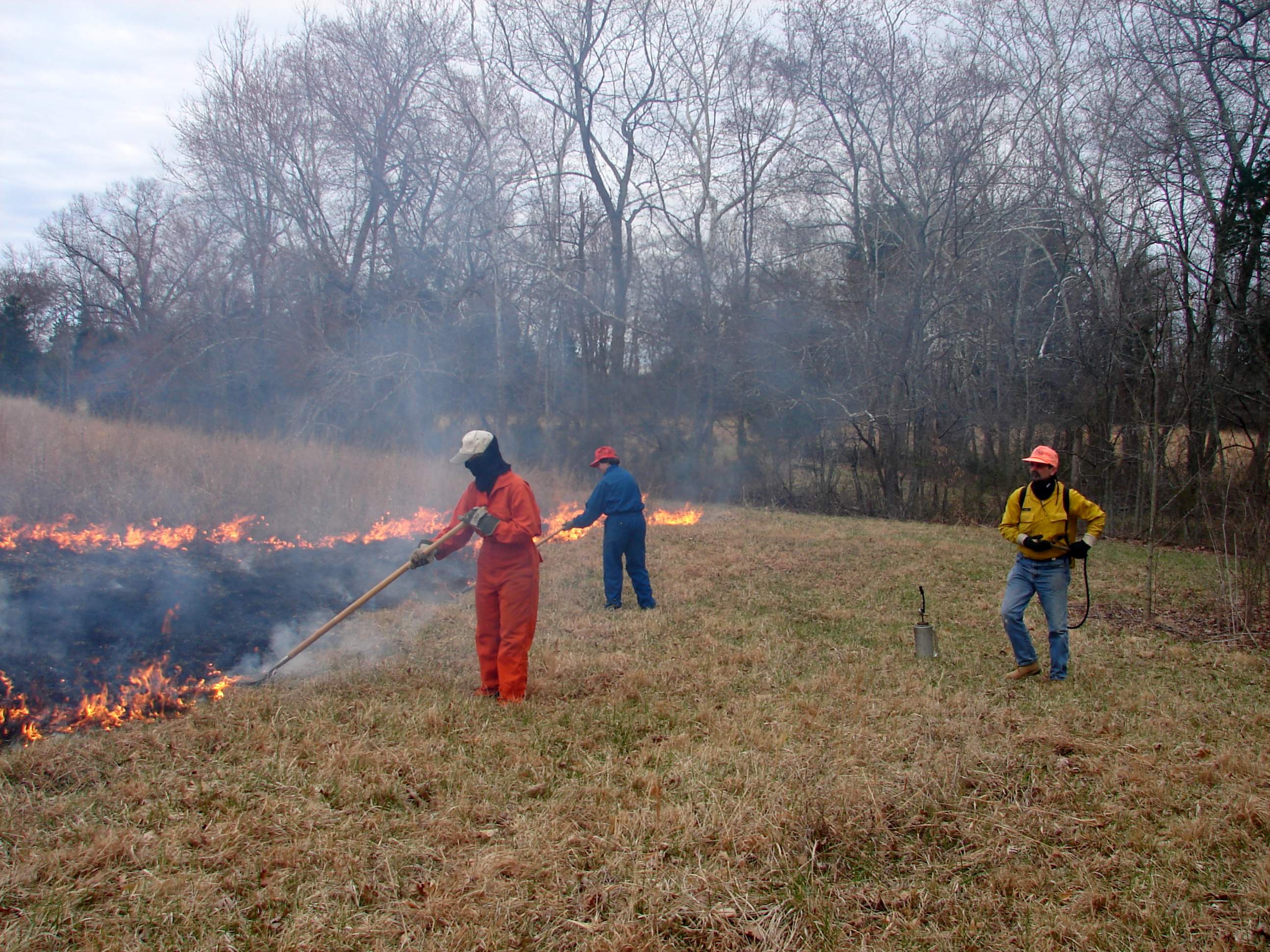

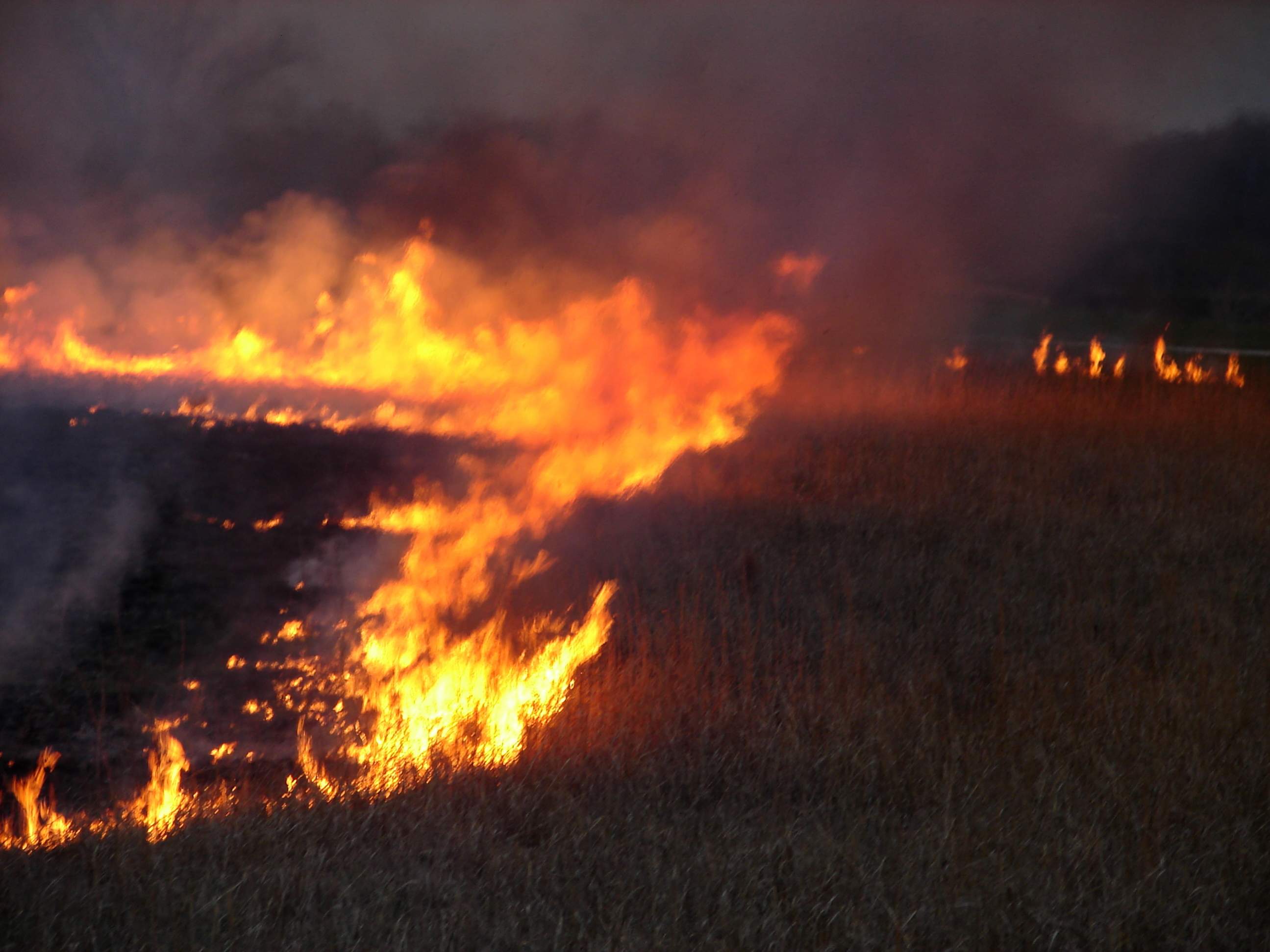

We got rid of fields of fescue (using glyphosate) and converted to Native Warm Season Grasses 4 years ago. Since then we have had 2 and 1/2 drought years but the native grasses have predominated. This year we got 2 cuttings of hay.
We have not had rain since August 23rd, and the field that was cut for hay since then is the only one in the area that shows a little green; this in the middle of (a warm) October.
Burning is essential for weed control, and to strengthen your native grasses. It is fun and exciting. Not rocket science, but you have to have the training, or someone who has, and proper fire-control equipment.
Go for it.
