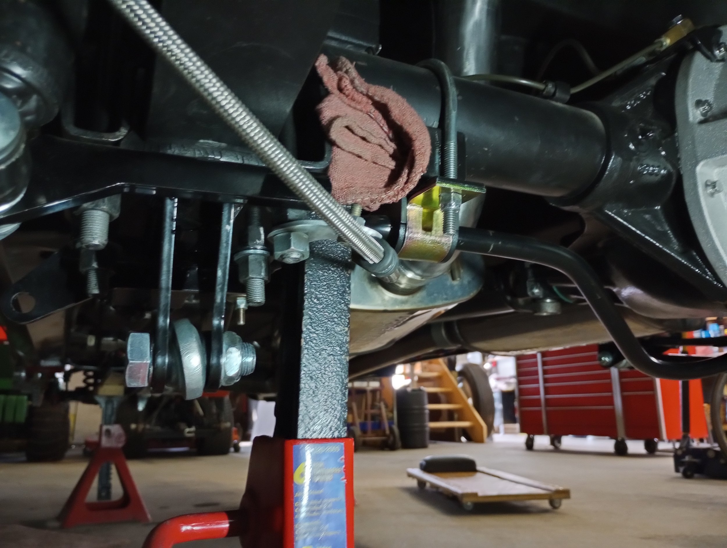

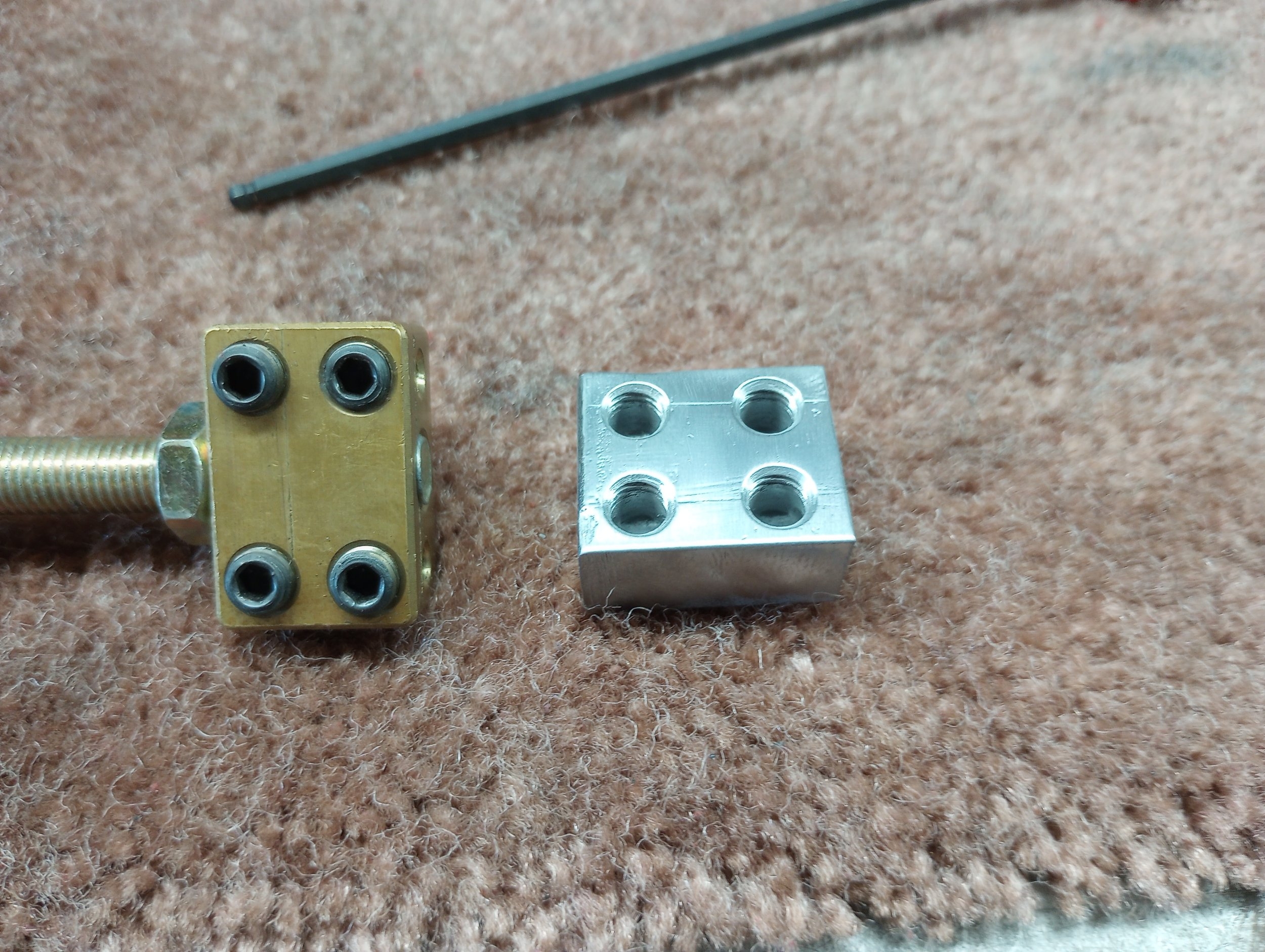

I finally have the parking brakes nearly finished up. I have all the cables installed and routed, just waiting on a 1/4"-28 bottoming tap to show up so I can finish tapping the set screw holes in the block I am using to connect the left and right cables together, similar to the factory setup. I also made and installed a couple of brackets to hold the cable housings from rubbing on anything.
Today I decided to bring the tires down from up on the deck, carefully slid them down the staircase without any issues. I installed the right rear tire on the car, just to make sure there was no interference with the parking brake cable, and everything has plenty of clearance. Should of taken a picture, but I didn't think about it until I had taken it back off again.

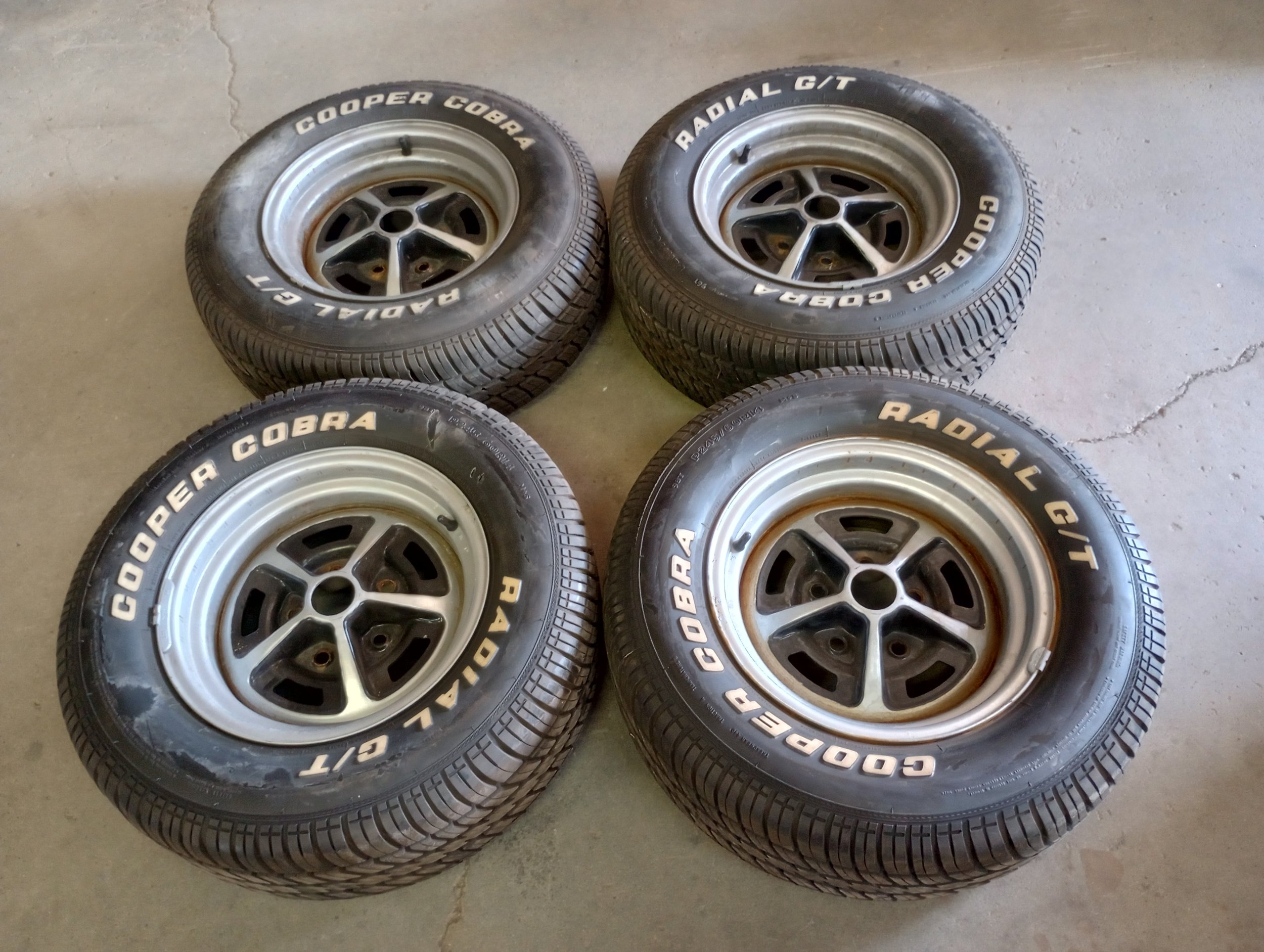

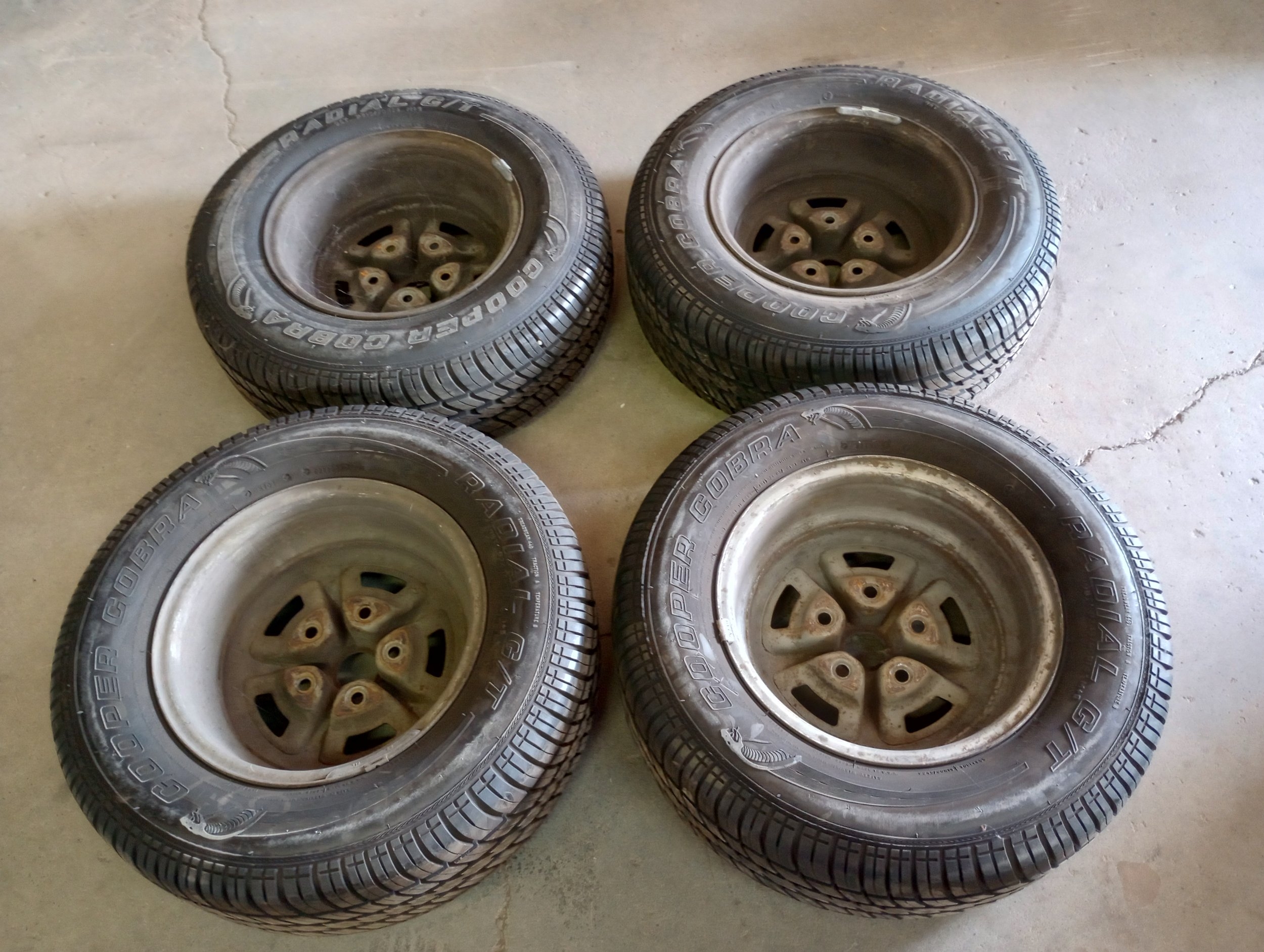

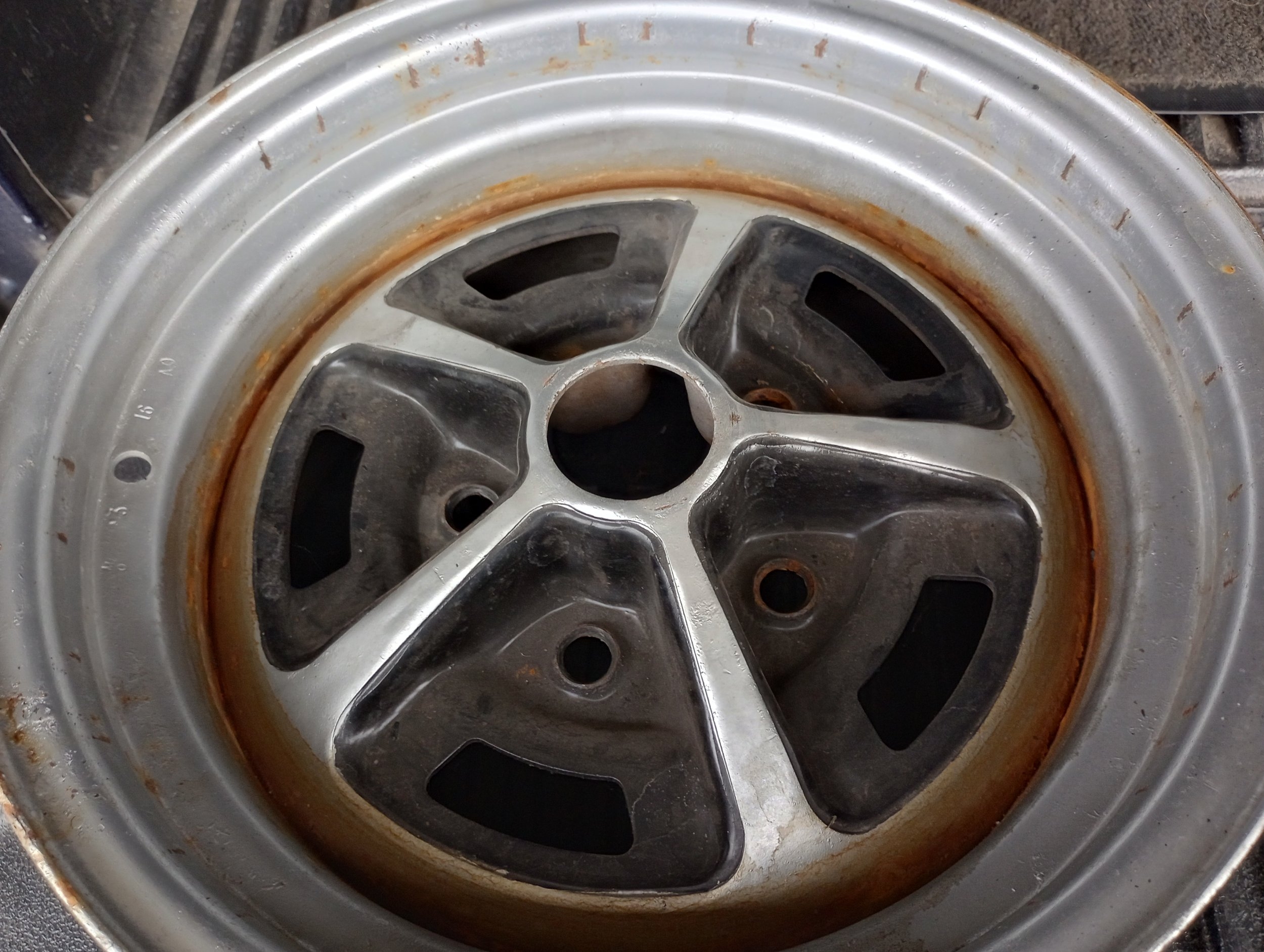

I tool the trim rings and center caps off, and looking them over, decided to get the wheels blasted and powder coated argent silver. No use restoring everything else on the car and leting the shabby looking wheels slide. In for a nickel, in for a couple of C-notes, I guess. So, I loaded them all up in the truck and went to my local tire store and had them dismount the tires, which they sold to me in 2011. They still look brand new, having been stored inside, no dry rot or checking whatever. They were even sill inflated to almost 30psi, so they obviously have no leaks.
I ordered the argent silver powder, and it should be here in a day or two. Once it comes, I'll take them to the powder coat shop and they'll make them look like new. I also ordered a masking kit, so I can paint the recessed areas black like the are now. I'm going to ask the powder coater if there is any way to do the black in powder coat, but I don't think there is, unless they can apply the silver, bake it, install the masks, apply black powder, remove the masks and then bake the black powder. Don't know, but I'm going to ask.

You can take a regular tap and cut it in half and you have a bottom tap.
I thought about that, but then I would still have to buy a new tap, so I just figured I'd get the proper tap to begin with. I have other things to do until the tap gets here.

Oh ok I didn't know if that's all you were waiting on. I've cut the end off of many taps to get threads to the bottom when I didn't have a bottom tap.
   / Restarting My '70 Nova Project
#507
I have a couple of bottoming taps, but not a 1/4"-28, of course.
