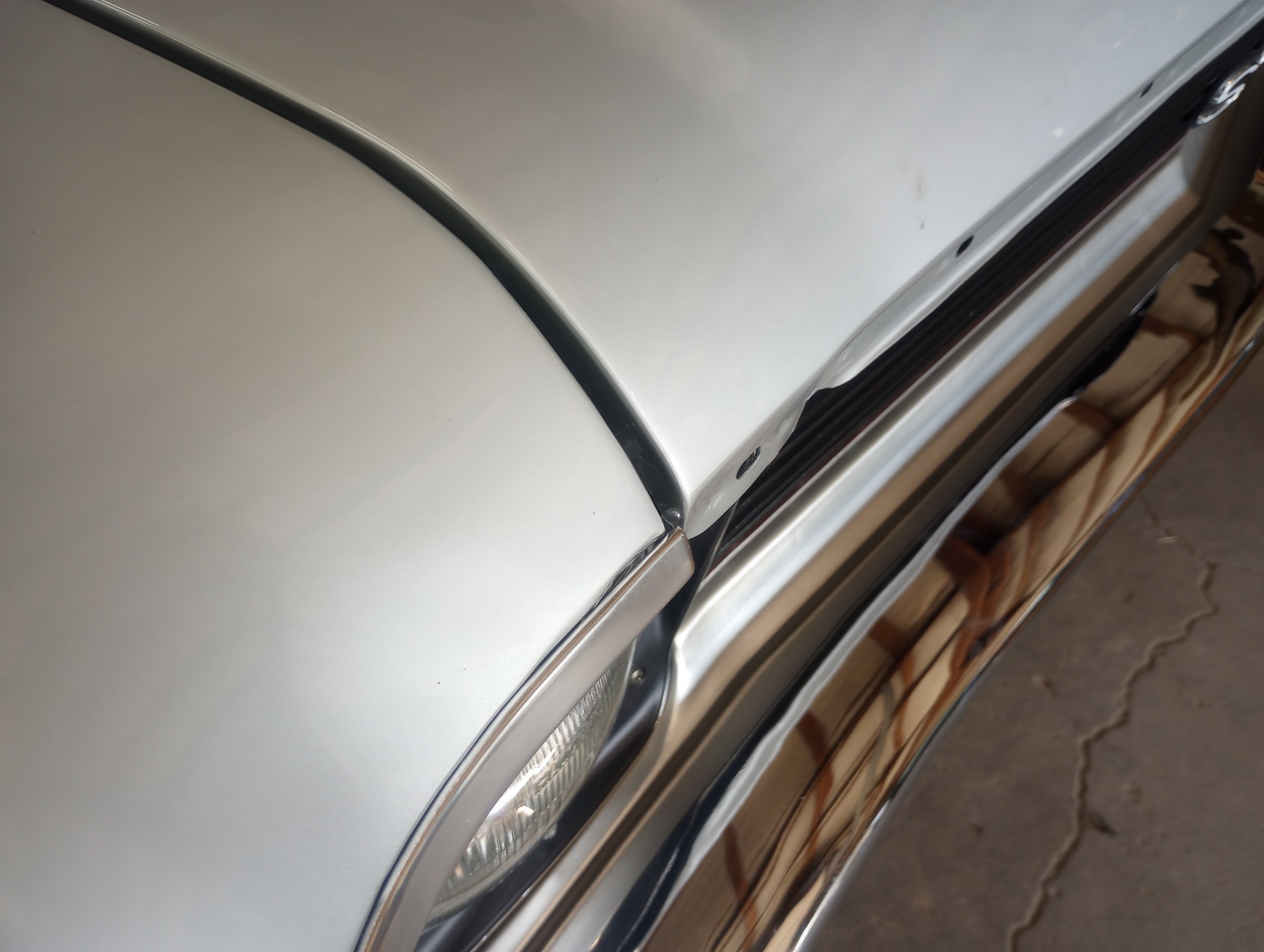

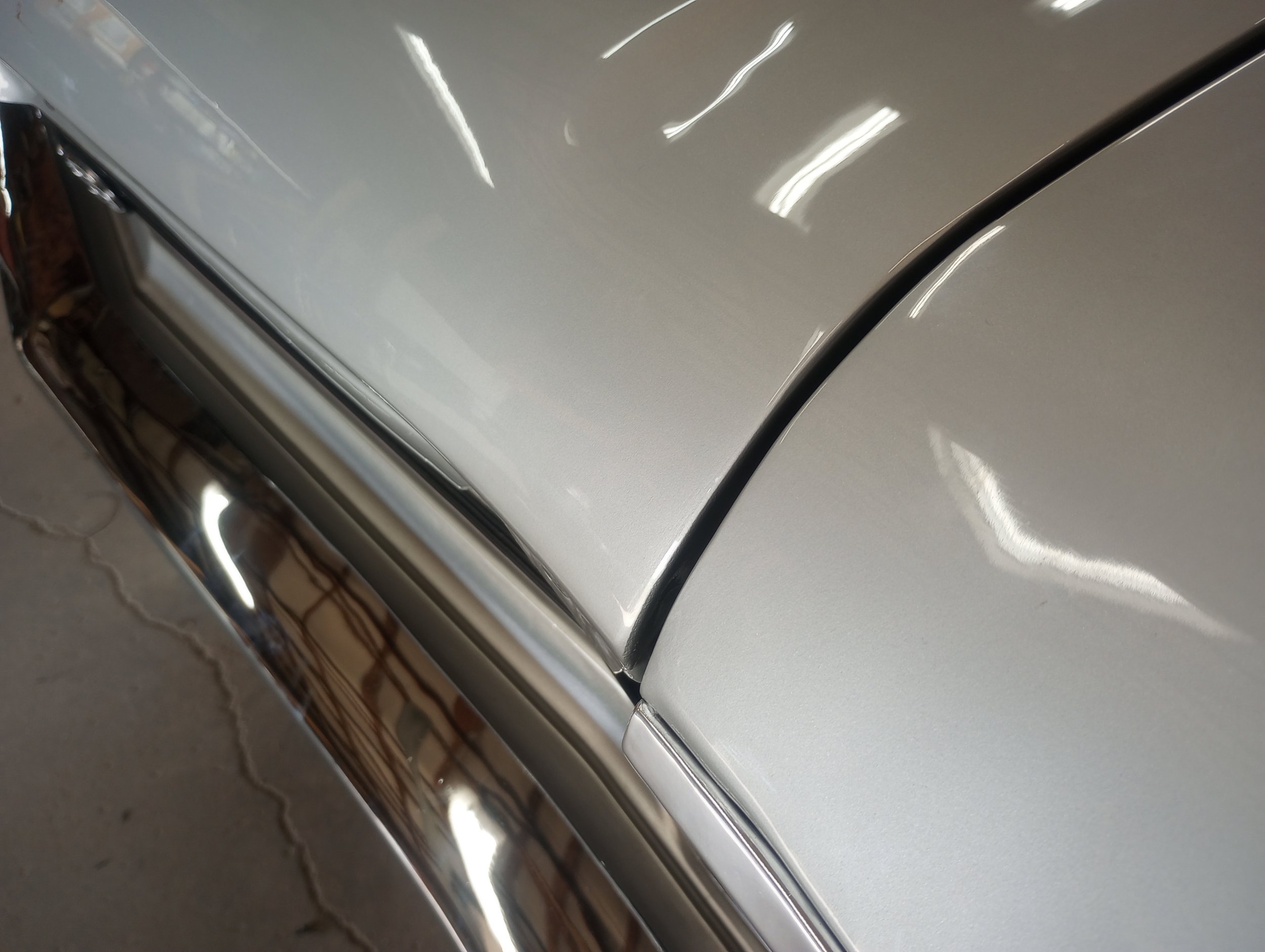

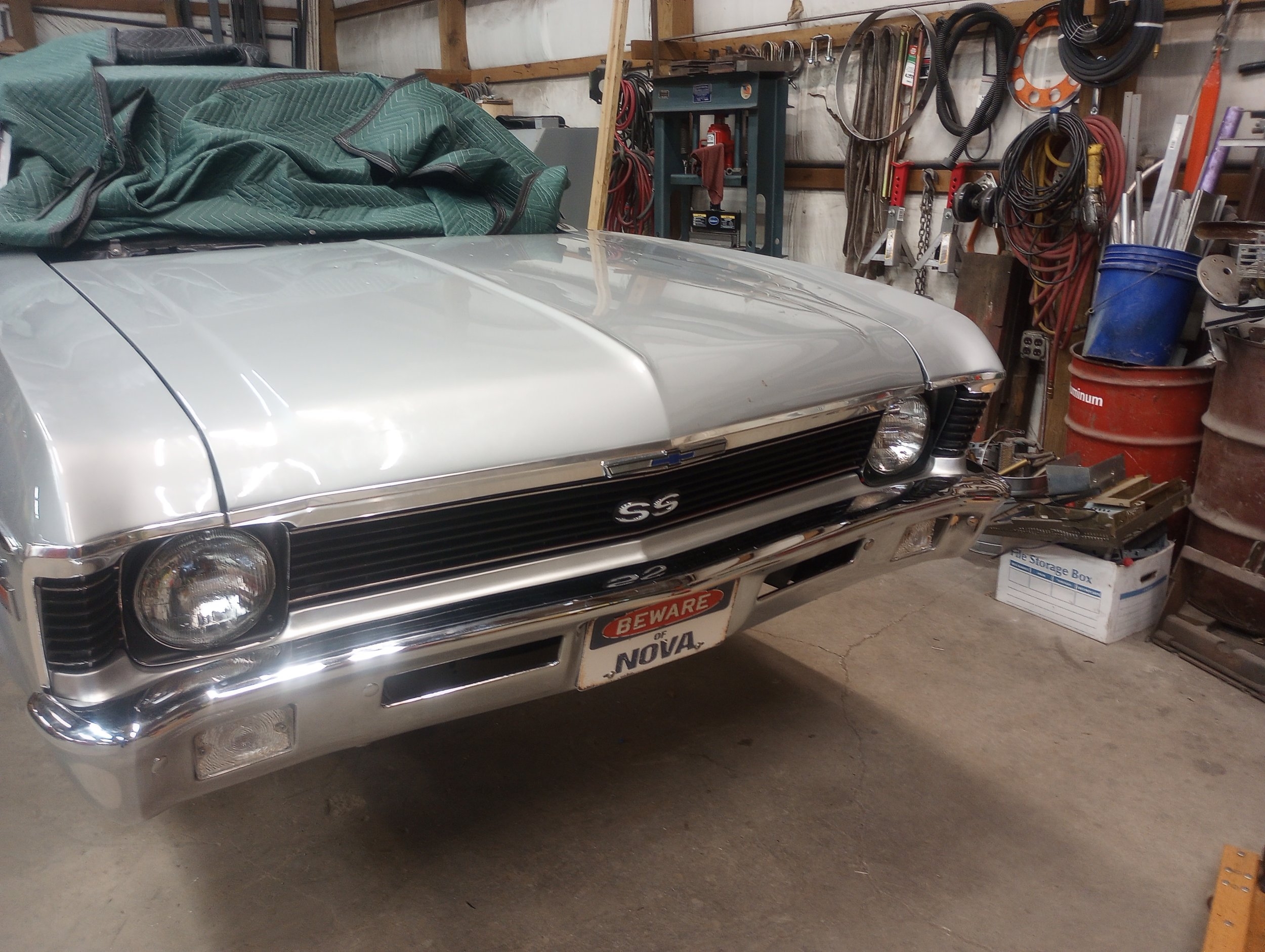

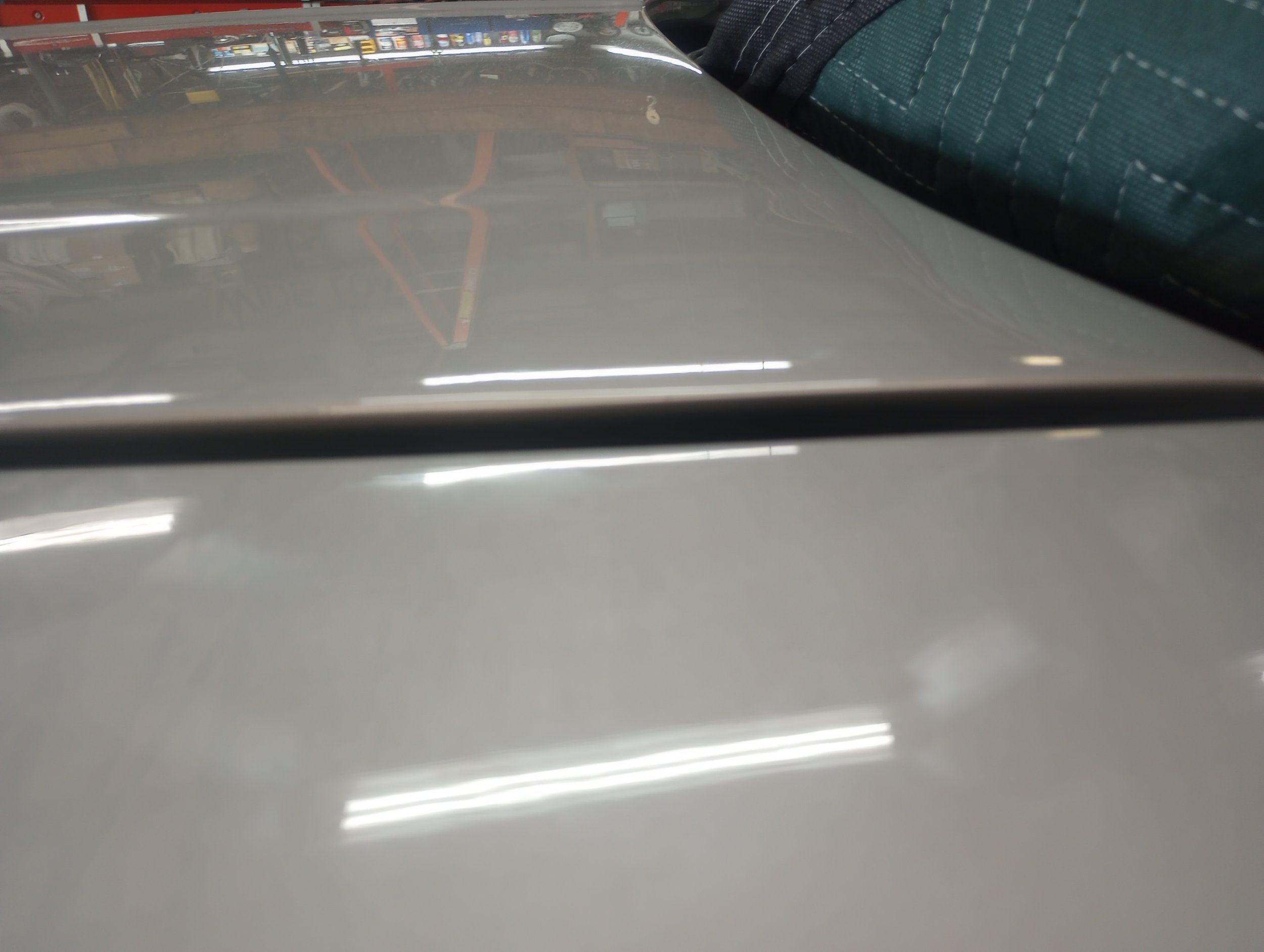

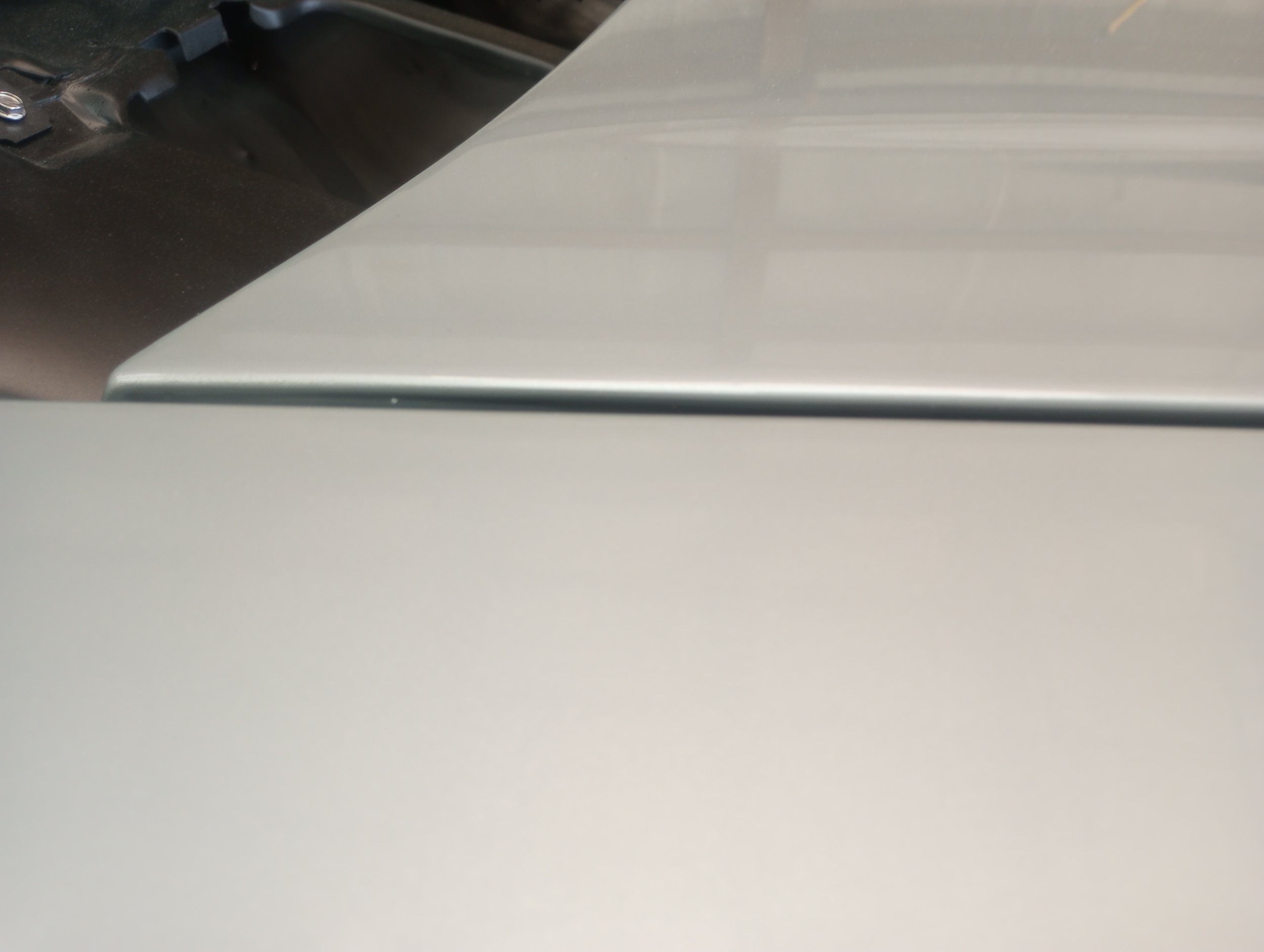

After sleeping on the hood alignment problem, I came up with the probable cause and a fix. It seems that The subframe must be slightly offset to the left side, causing the radiator support to also be offset to the left also. The error is only about 1/4" or 5/16" at the radiator support. Solution I came up with was to loosen the bolts that attach the support to the subframe, use a ratchet strap to pull the support to the right about that amount, and tightening the bolts back down. I also loosened all the bolts at the rear of the fenders a bit, so it could move at those points if necessary. after I tightened everything back up, I had to adjust the right rear of the hood and move it back a little to get it centered between the fenders. Now it's aligned as well as I had it before taking it apart for paint. I may, if I get really serious, attempt to realign the subframe. Not sure just how to do it yet, but I'm cogitating on it, and I'll have to crawl under it and assess just how to go about it.
I also readjusted the hinges on the fenders and got the rear of the hood to set level with the fenders, or at least the right side does, the left side is still a little proud of the hood, so I may have to pull the hinge and lengthen the slot for the rear bolt a little, maybe 1/8". But, it looks way better than it did initially.
I dug out the nose trim for the hood and checked the fit on the hood. It fits really well, but it didn't come with any speed nuts that thread onto the studs that go through the hood, and I didn't have any that were big enough. I may check Lowe's or Menard's tomorrow, or the hardware store in town on Monday.

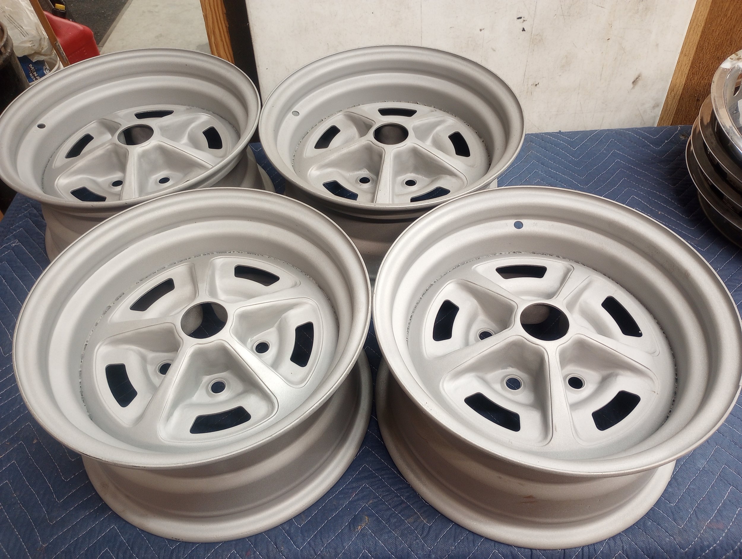

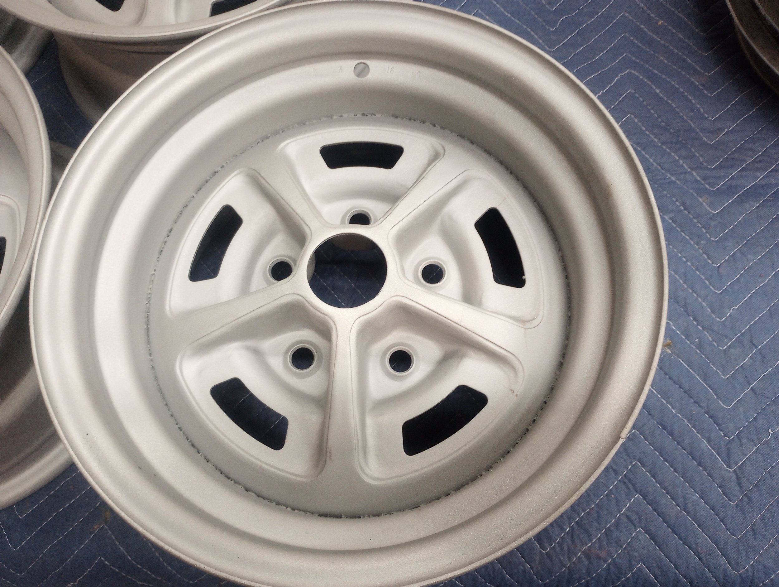

I went to the powder coat shop yesterday and picked up the wheels. I can see the material that's down in the crevice where the rim and disc meet on the wheels, but I don't know how you'd get it out I may try with my bead blaster, as I'm sure that is much finer that the abrasive they used, if that doesn't work, I may use seam sealer to smooth them out before Brian paints them for me. He'll give them a coat of epoxy primer, a couple coats of Argent silver, them we'll mask them of to paint the areas between the spokes with some Hot Rod black. That should make them look good as new.

Got the hood lip trim installed today, makes it look a lot better with that on. Couldn't find the correct speed nuts anywhere today, to I took some 3/16" ones and swaged them out a little with a tapered punch. Then they worked just fine.

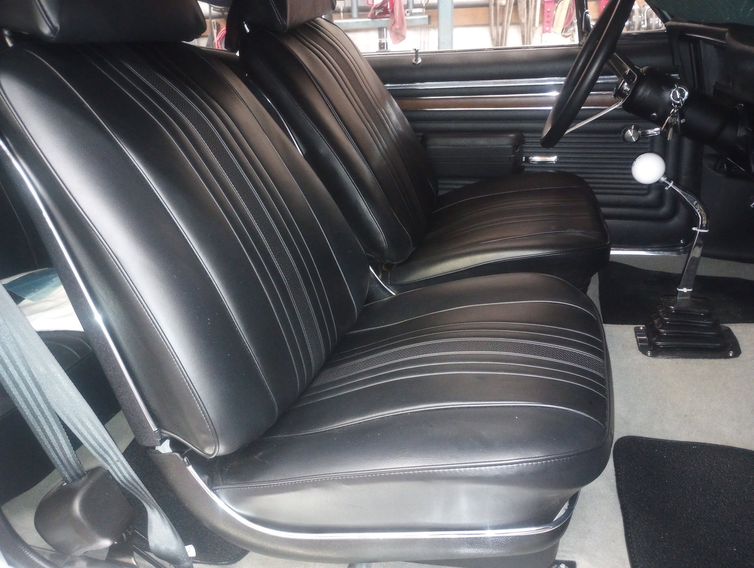

I found some 1" tall spacers and put them between the rear of the upper slider tracks and the seat frame. That tipped the seats forward, makes them look better and you sit more upright now. Damn, those seats are heavy to take in and out.

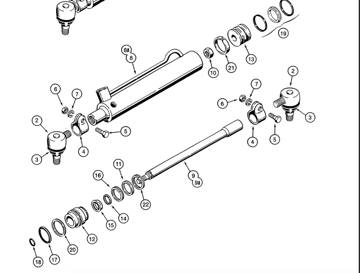

All I did was make a mess this weekend. Took apart one of the steering actuators, Someone used red locktite on the aluminum piston to the shaft. Tried heat, solvent. I was worried the aluminum piston would break. Stuck it back together and ended up ordering another hydraulic actuator.
I will still rebuild it, just did not want to put it out of commission. I will have an extra Actuator ready for is/when it leaks again.

I rarely use Locktite for that very reason, especially in aluminum. If you have a problem with bolts loosening in aluminum, I prefer to drill the heads and safety wire them.
Are you talking about the actuators in a hydraulic steering system with a cylinder attached to the tie rod?
   / Restarting My '70 Nova Project #528
yes, the piston in the Hydraulic actuators on a Case 480E.
number 13 is supposed to only be held on with the nut #10.
I have a press. I will try that once I get a new actuator.
I've always called them hydraulic actuators, some people call them hydraulic cylinders, but to me that is just a part of the actuator.

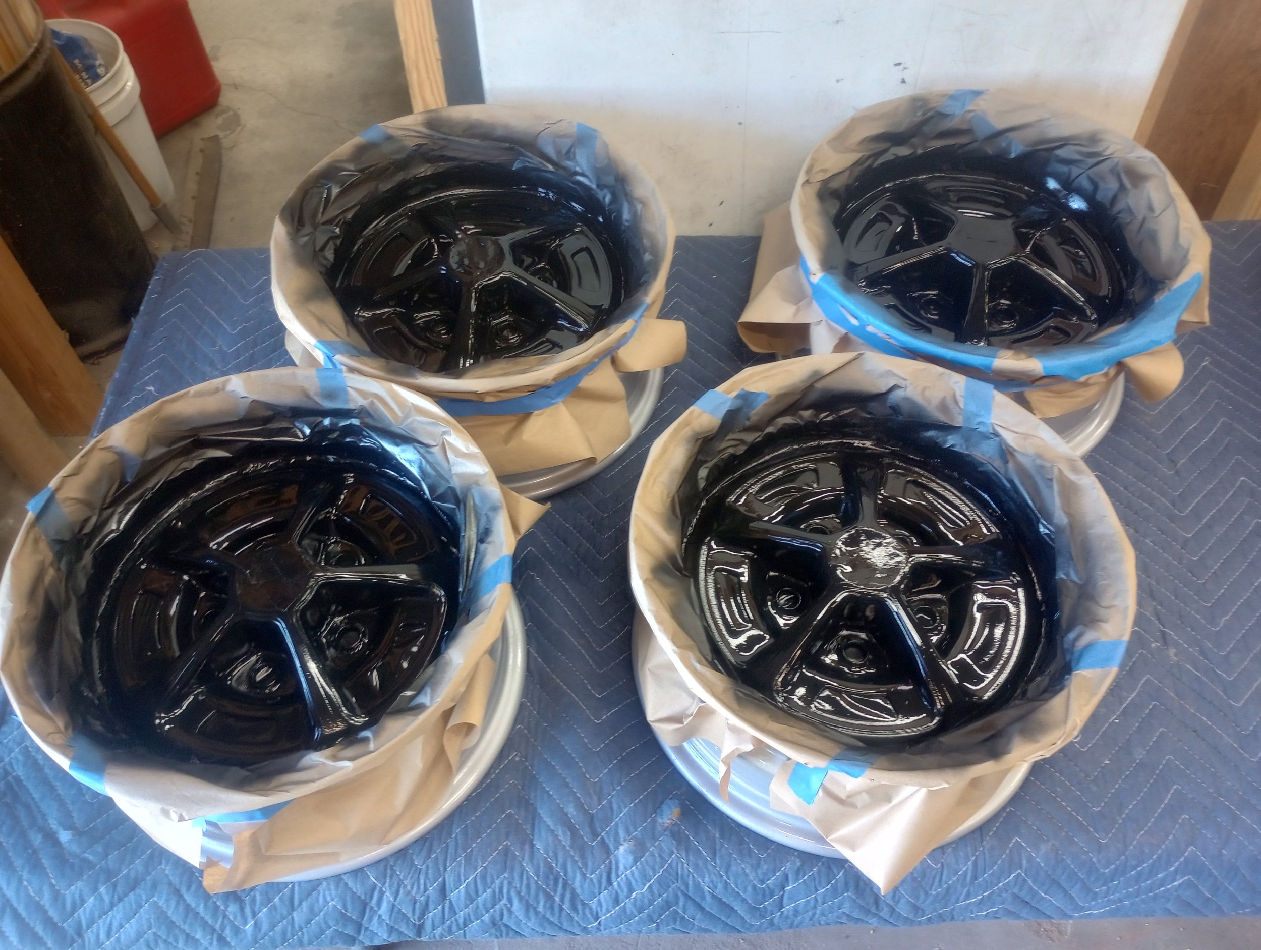

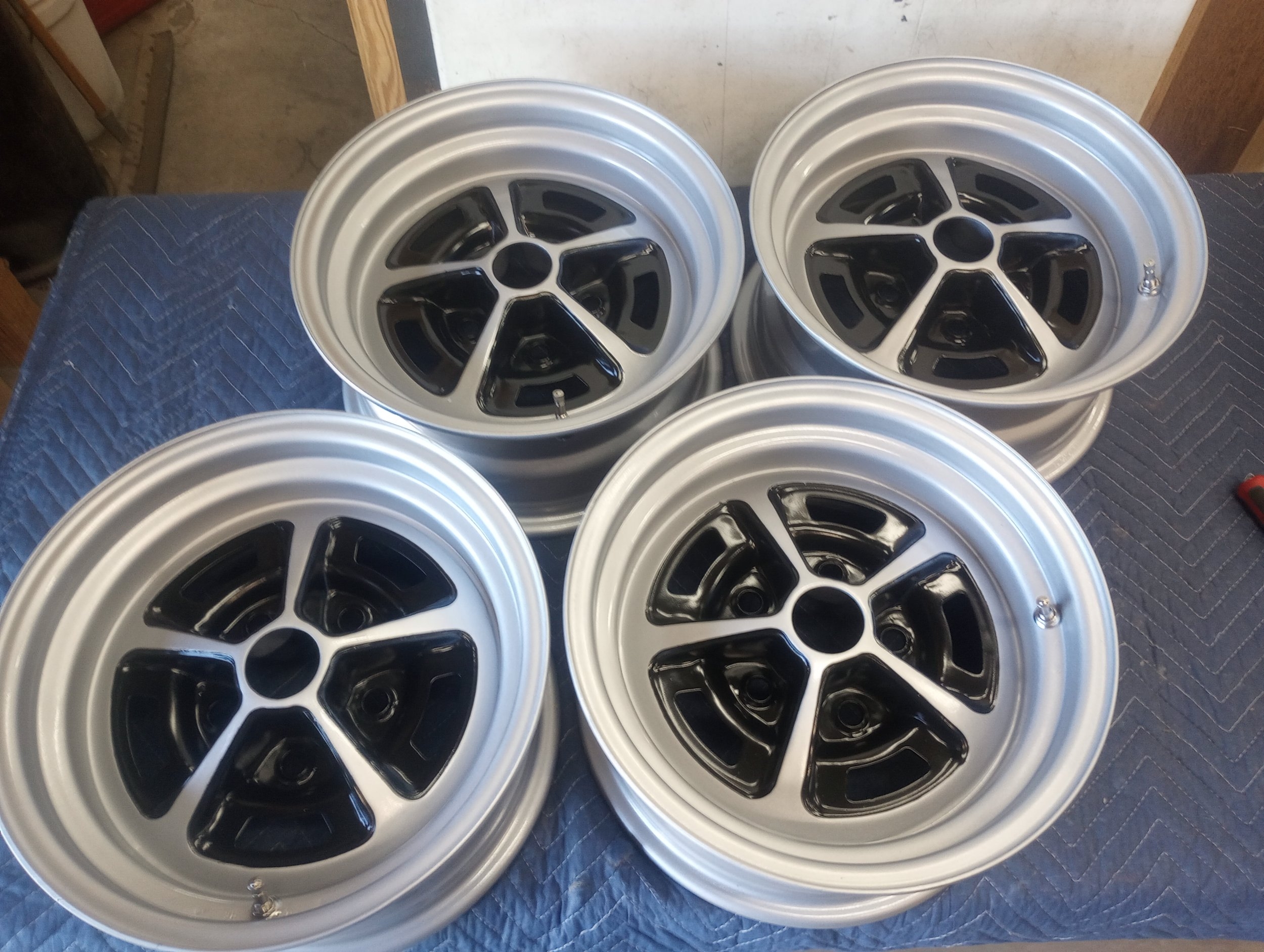

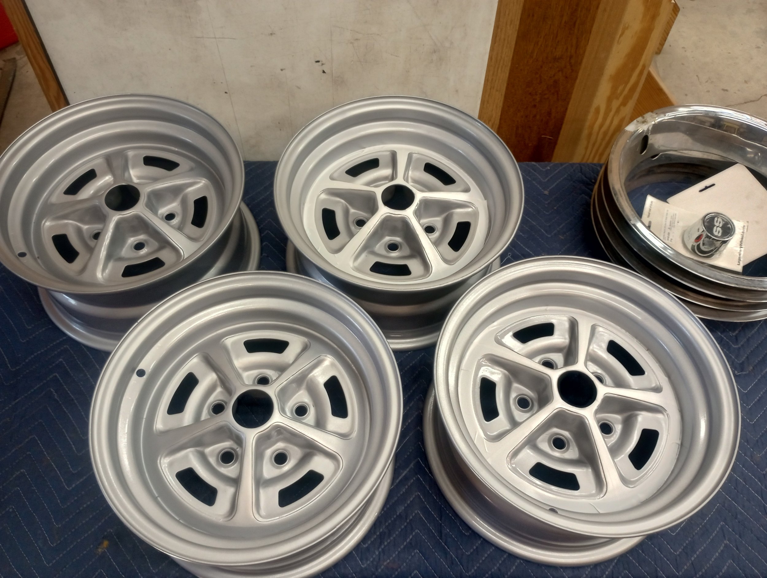

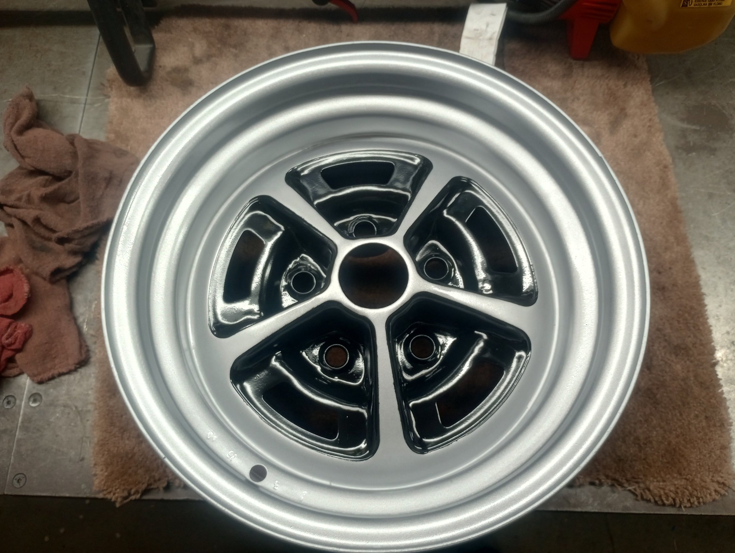

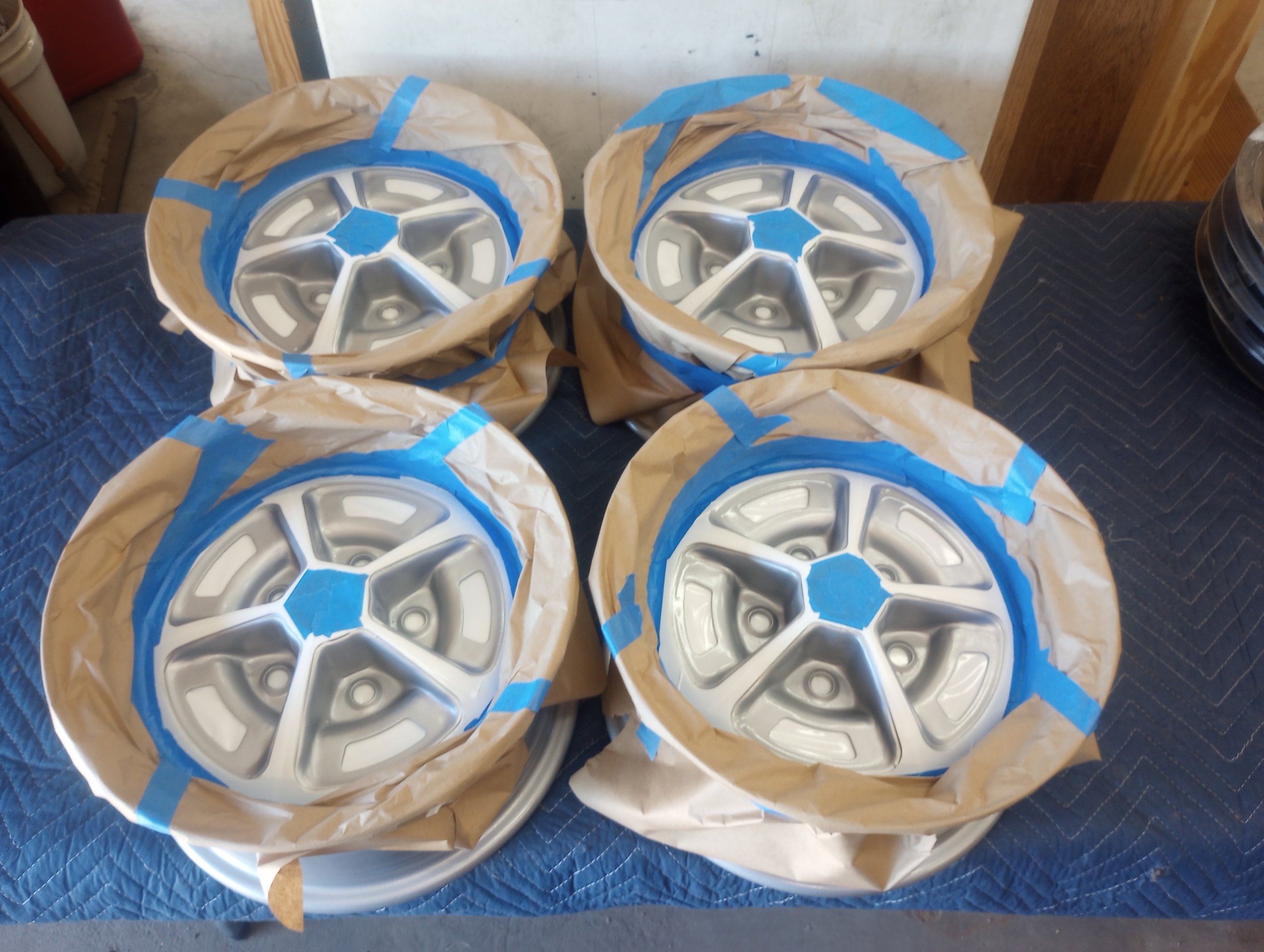

FINALLY got the wheels painted and ready to get the tires mounted on them. After the powder coat shop wasn't able to coat them without bubbles, Brian said he would paint them for me, as he had a supply of single stage argent silver. He had some personal issues that came up in the mean time, so after three weeks, he finally got them painted and brought them back last Friday. It was probably just as well, as during that time my water well decided to start pumping sand into the house, most likely from a rusted out well casing. I guess just shy of 50 years isn't too bad for an old 2" deep well. Lots of calls to well drillers made it obvious that I wasn't getting a new well any time soon. I finally got one driller to squeeze me in, and they finally got it drilled and in operation last Thursday. Both crews, the drillers and pump setters were great younger guys, very knowledgeable and skilled. Then it took most of the day on Friday to get all the sand flushed out of the system, cleaning all the plugged fawcet aerators, shower heads, toilet flush valves, clothes washer and water softener lines.
So Saturday and Sunday I got the wheels all masked and taped up, ready to paint the black on them. I had some leftover hot rod black paint, but it was not going to be enough, so I ordered a couple of spray cans of 2K catalyzed hot rod black from Amazon, and it came late yesterday. Today I gave them all three coats and after a short wait, it had set up enough the pull all the stencils, paper and tape. I think they look pretty good. Tomorrow I may get time to run them to the local tire shop and get the tires mounted and balanced. A cousin is coming over and we're going to do some work on his pickup, not sure how long it'll take. But hopefully, by the weekend I'll finally have the Nova back on the ground and able to move itself.
