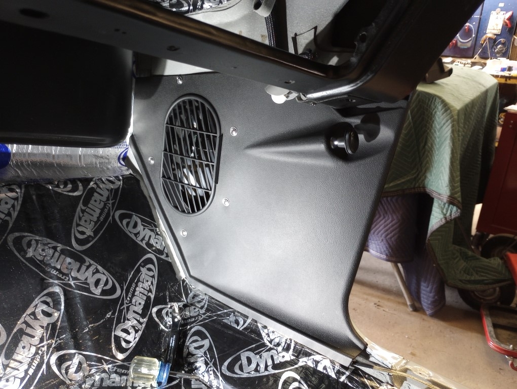

That done, I decided to install the kick panels with the fresh air vents. I bought new ones as the PO had hacked holes in originals and installed speakers which really didn't fit and looked like crap. They are rather fussy to get in and out, either you have to fight with them for 10 minutes to get them in or our, or they almost fall in or out, no in between. I had screwed to dimmer switch to the floor and it had to be removed to install the kick panel. Unscrewed it and when I tried to pull the connector off it, the switch came apart. Damn cheap crap! :mad: I was able to get it back together, the two little crimps in the case let the connector pull out rather easily and I was able to get back together and applied a couple of much more secure crimps to hold it together. I don't think it'll come apart again.
I test fit the kick panels to make sure all the screw mounting holes lined up with the holes in the cowl openings, which they did, then took them out and put a bead of butyl sealant around the openings and reinstalled them.

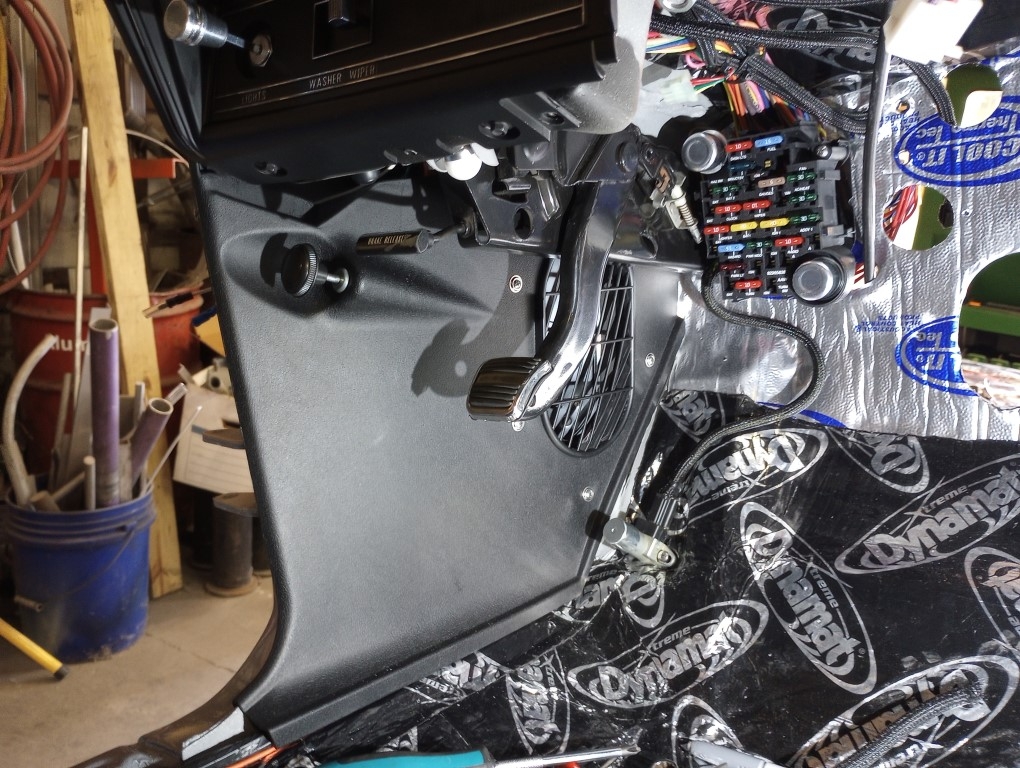

After that, I installed the emergency brake pedal assembly, and had to adjust the little plunger switch that operates the dash warning light. It's really close quarters between it and the fuse block and I had to adjust the plunger a couple of times so it doesn't rub on anything and slides freely.

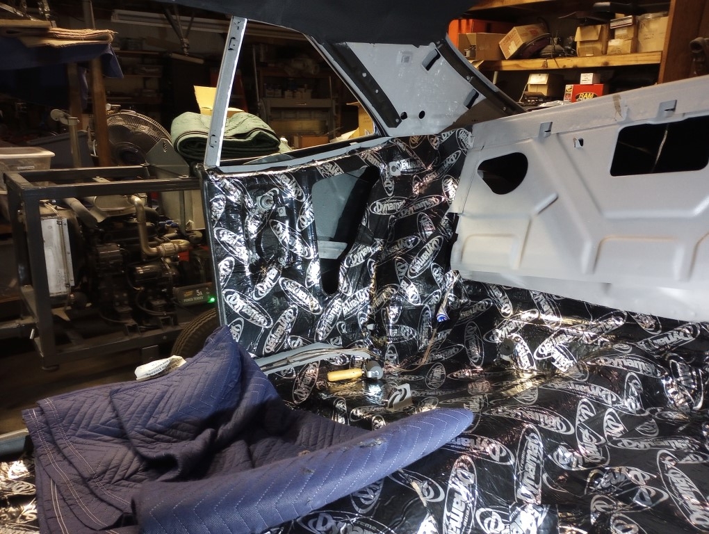

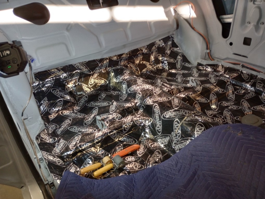

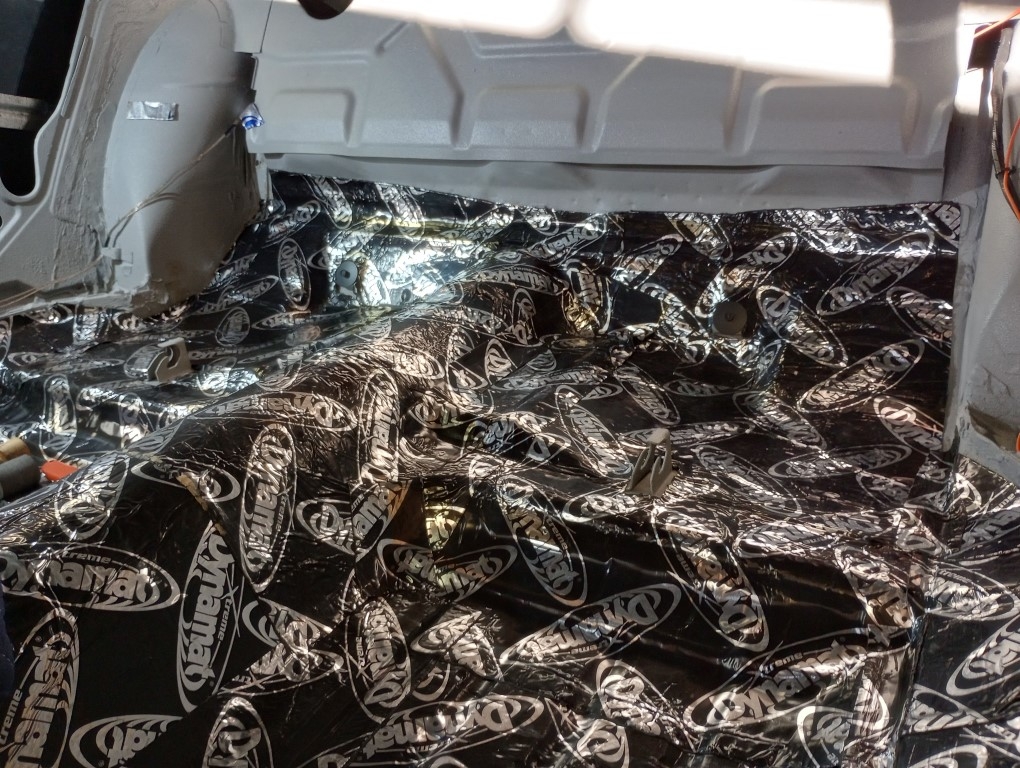

While that was drying, I decided to install the rest of the Dynamat on the floor. I managed to get that done and only cut myself once with the Stanley knife. Of course I had just put in a new, razor sharp blade, so it make a nice clean cut! Electrical tape to the rescue.

View attachment 818249View attachment 818250View attachment 818251View attachment 818252
I had forgotten about the little pull vent knobs on the Nova's. :)

I'm going to work on that today, but I'm running low on Dynamat. I ordered another box today from Summit, so I should have plenty to finish the job. I'm trying to decide on whether to try putting the Dynamat on the inside surface of the quarters against to outer skin, but it may be a real challenge working through the holes in the inner walls. I'll give it a try, but if it's too difficult, I'll just put it on the inside, under the interior panels. I'm going to do the bulkhead behind the rear seat, the package tray, and am considering doing the trunk also, although I want to put a mat/carpet back there and maybe that would help some. Maybe just covering the wheel houses in the trunk would be sufficient.
I found the Summit receipt in one of the two boxes I have had since 2013, for $139.00 per box of nine sheets. The box I just ordered was $229.00 per box. Talk about inflation!

I used up the last of the Dynamat today doing the passenger side wheelhouse and quarter area. I decided to just put the mat on the inside surface of the area rather than try to install it onto the inside of the quarter panel. I won't have the new supply until Monday or so, which is a good thing as it will let my thumb heal up from the pretty bad cut from the Stanley knife when I was cutting up one of the pieces of Dynamat. I was using a metal yard stick as a guide, and the knife jumped up on the top of the yard stick and into the side of my right thumb. Bled like a stuck hog until I got it wrapped with electrical tape, an essential supply in a mechanic's first aid kit.

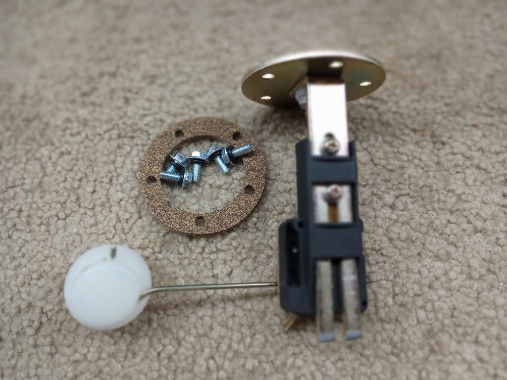

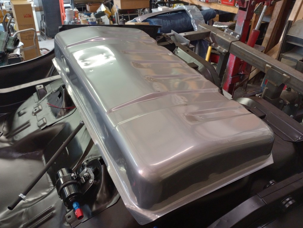

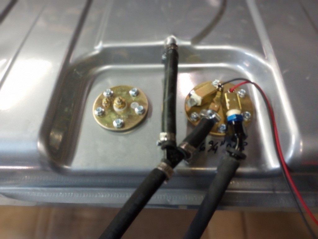

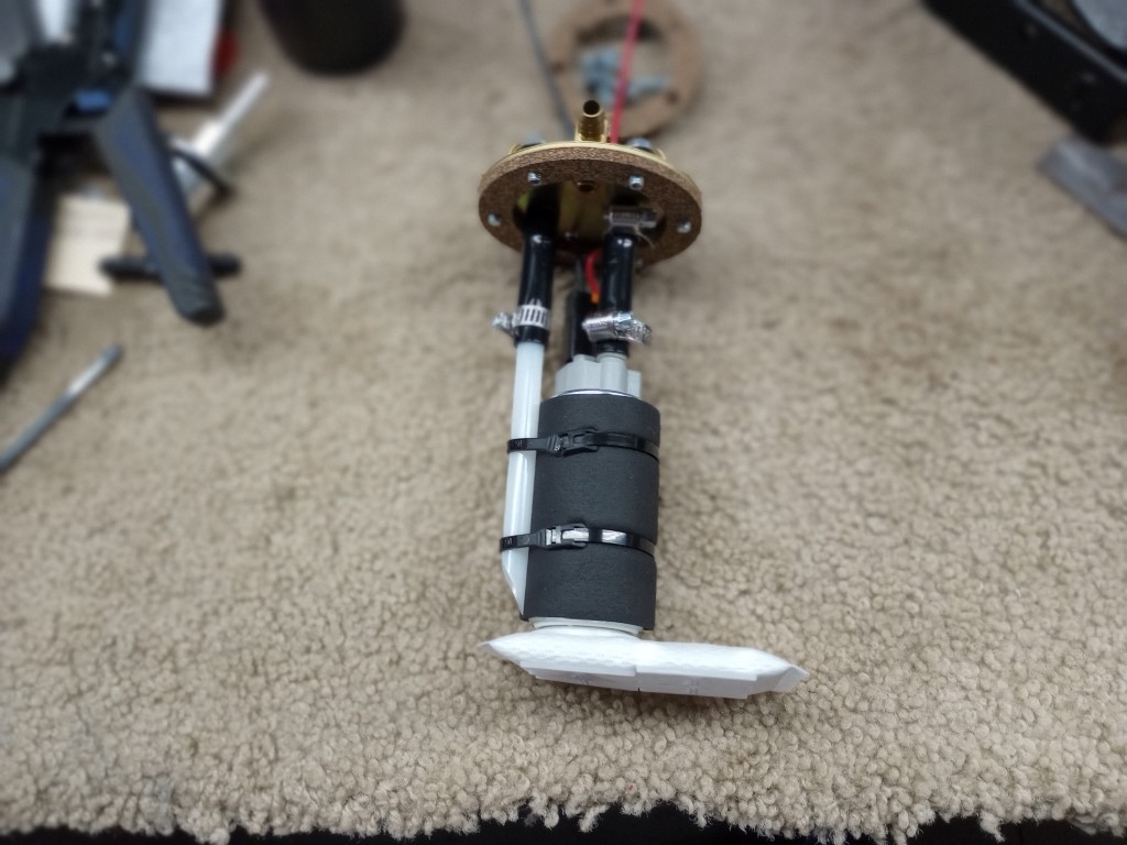

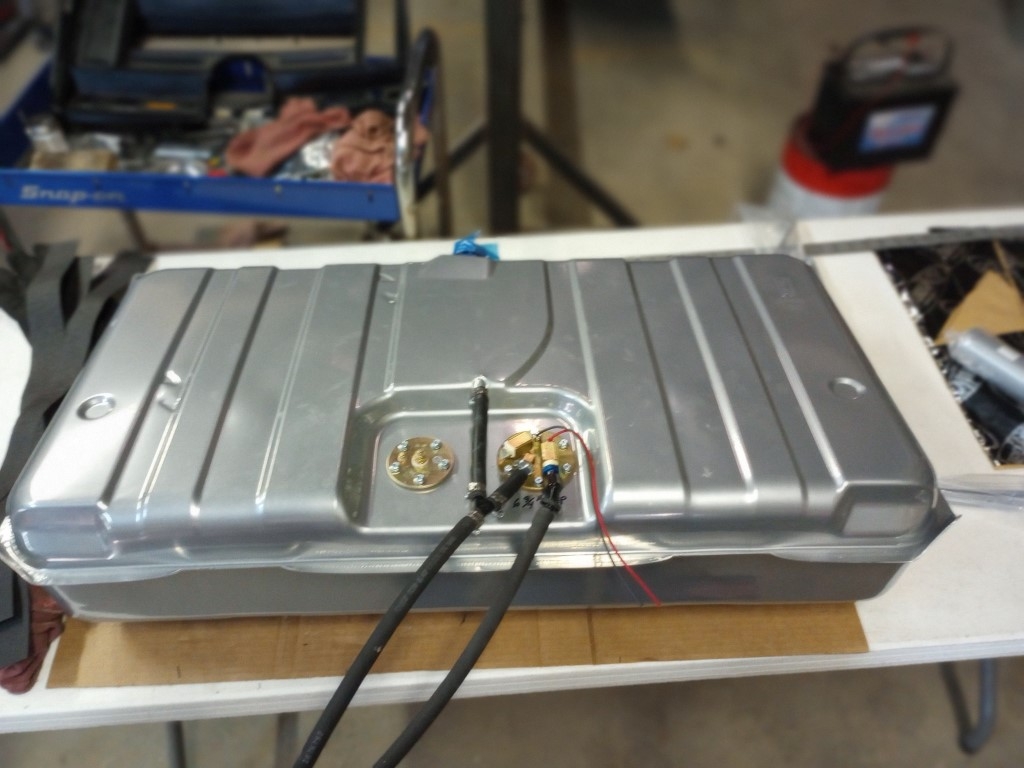

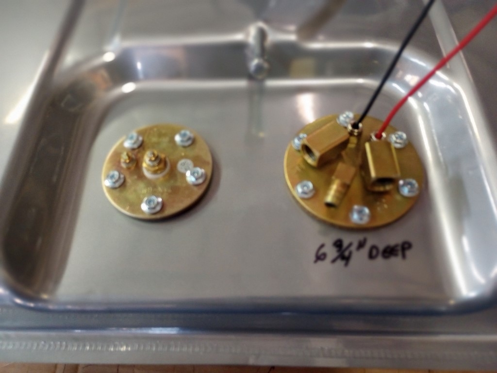

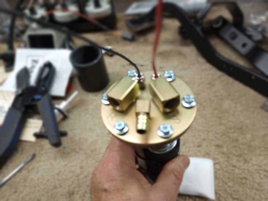

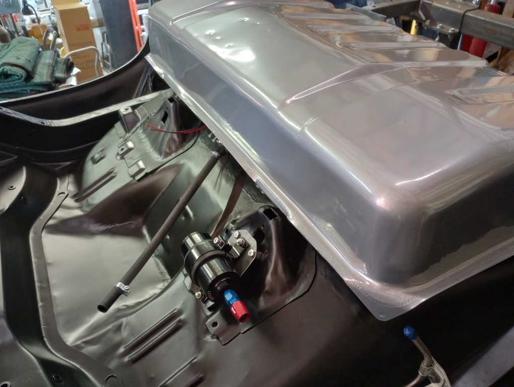

I unboxed the new tank this afternoon, it looks really nice. I also assembled the in-tank fuel pump and fuel level sending unit. Installed both in the tank and connected the tank and fuel pump vents to the Y that was supplied. I didn't have enough small hose clamps, so I had to make a run to NAPA to pick up a box of them. I installed the clamps on the Y hoses, but until I get the tank in the car, I'm not sure just how I'm going to run the lines. The vent line has to go up in the differential well and has a roll over valve that will prevent fuel leaking in the case the car is rolled over. I hope that's never used!
I laid the new SS fuel line in place and found a couple of the clips that hold it to the rear frame rail, but I can't fine the little plate that attaches to the frame rail behind the axle and secures the end of the line where the hose from the tank outlet attaches. I'll look some more tomorrow for it, if not, I can easily fab one up out of some 1/8" X 1" flat stock I also have to get the fuel filter mounted in that area between the tank and fuel line. There are a couple of holes that were used to mount the Holley external pump, and I think I can fab up a bracket and use those holes.
I found the insulation straps that go between the body and the tank and straps to keep them from rubbing or corroding the tank, but they're really cheap, thin material, and I don't think I'm going to use them. I have some material used on Peterbilt tanks and straps that is much better, so I think I'll use that.
I didn't get the tank installed yet because I want to give the underbody a coat of undercoating first, but that entails masking off most of the body so it doesn't get on the paint. I may test assemble everything first and then apply the undercoating.

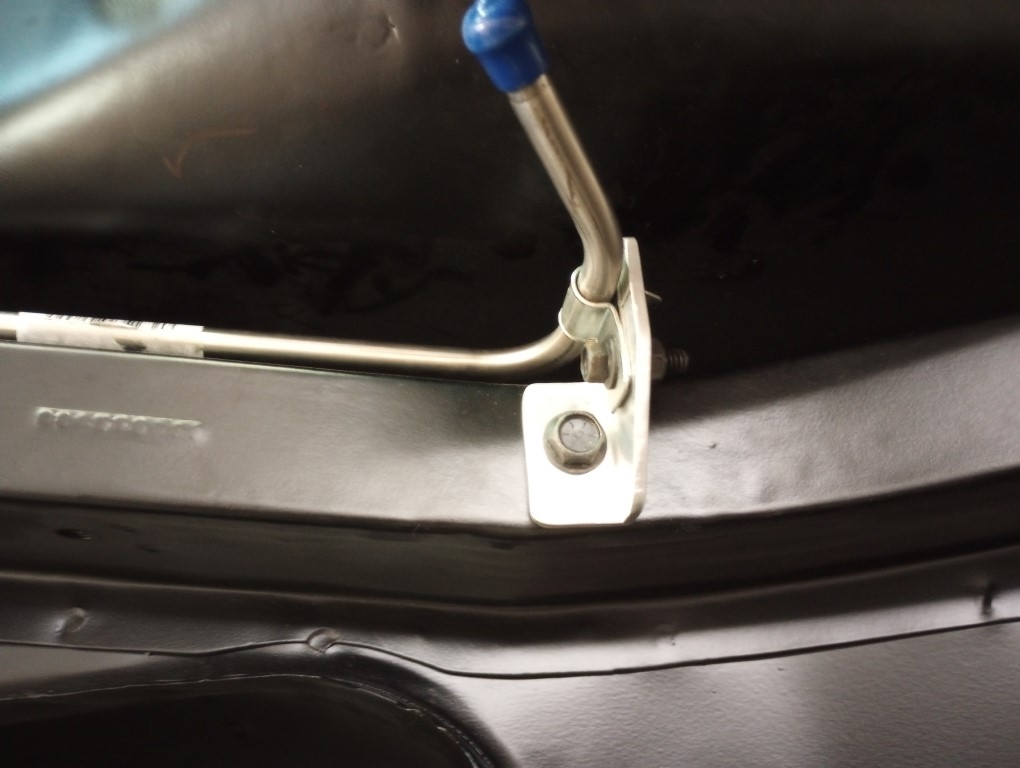

Laid he new SS fuel line in place and spent an hour bending and tweaking it into the right position. I had a couple of new bends that were made during shipping that needed to be straightened out. Secured it with three factory style clamps to hold it in place.
Put the gas tank in place to check for line routing, I'm going to use the stainless braided PTFE line to connect to the rigid line that runs to the front. Also made a bracket for the fuel filter and one to support the end of the fuel line. Going to have to order some fittings to get it all hooked up, I only had a couple left from installing a Fi-Tech EFI on Brian's 440 Charger. Plenty of hose left though.
Sure is great to have the body on a rotisserie so I can position it any way that makes the task easier.

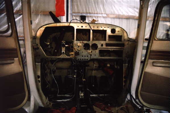

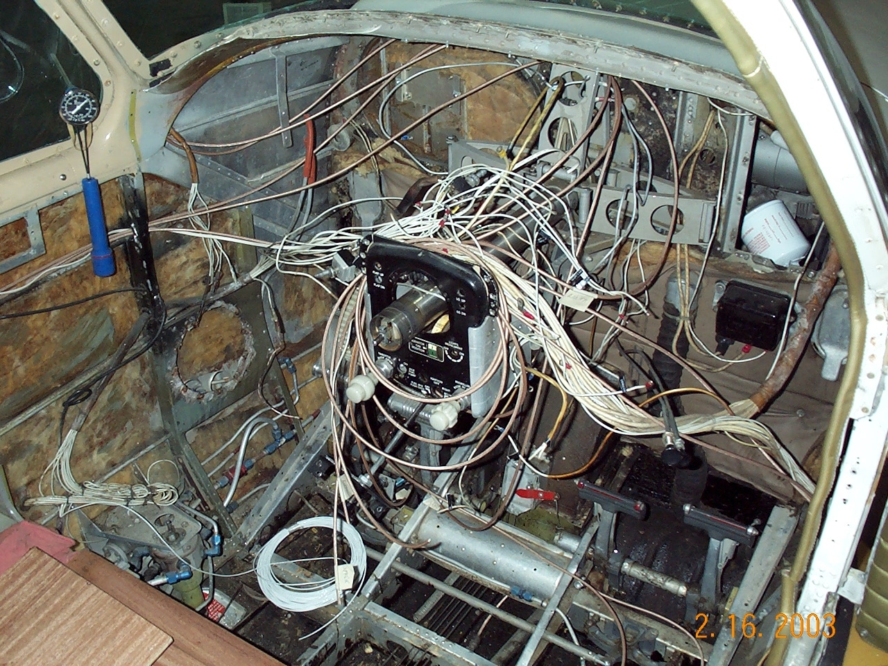

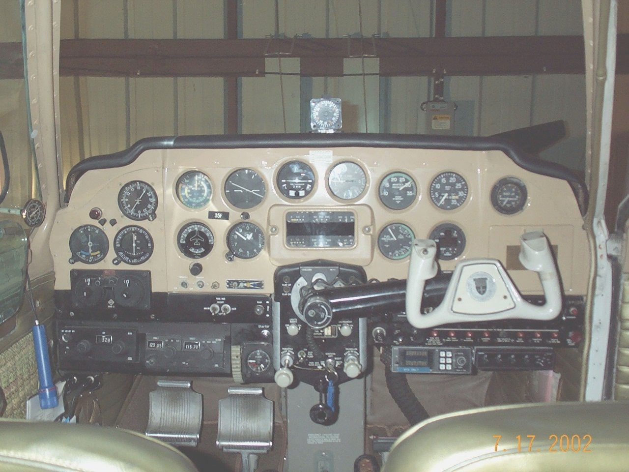

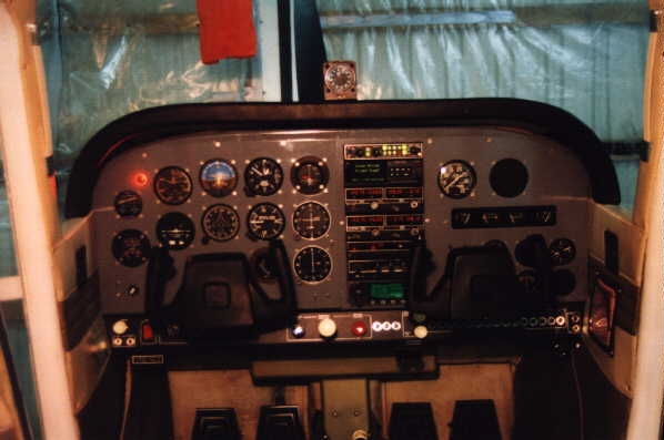

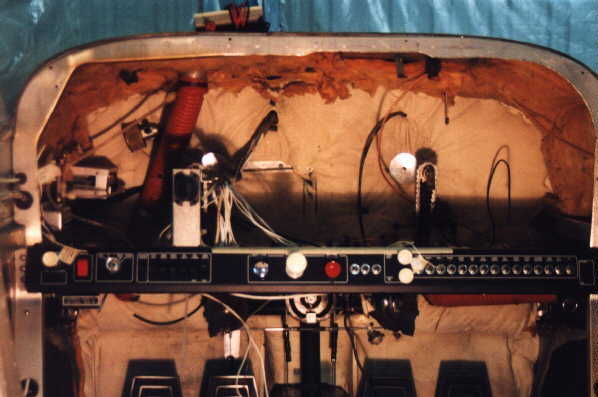

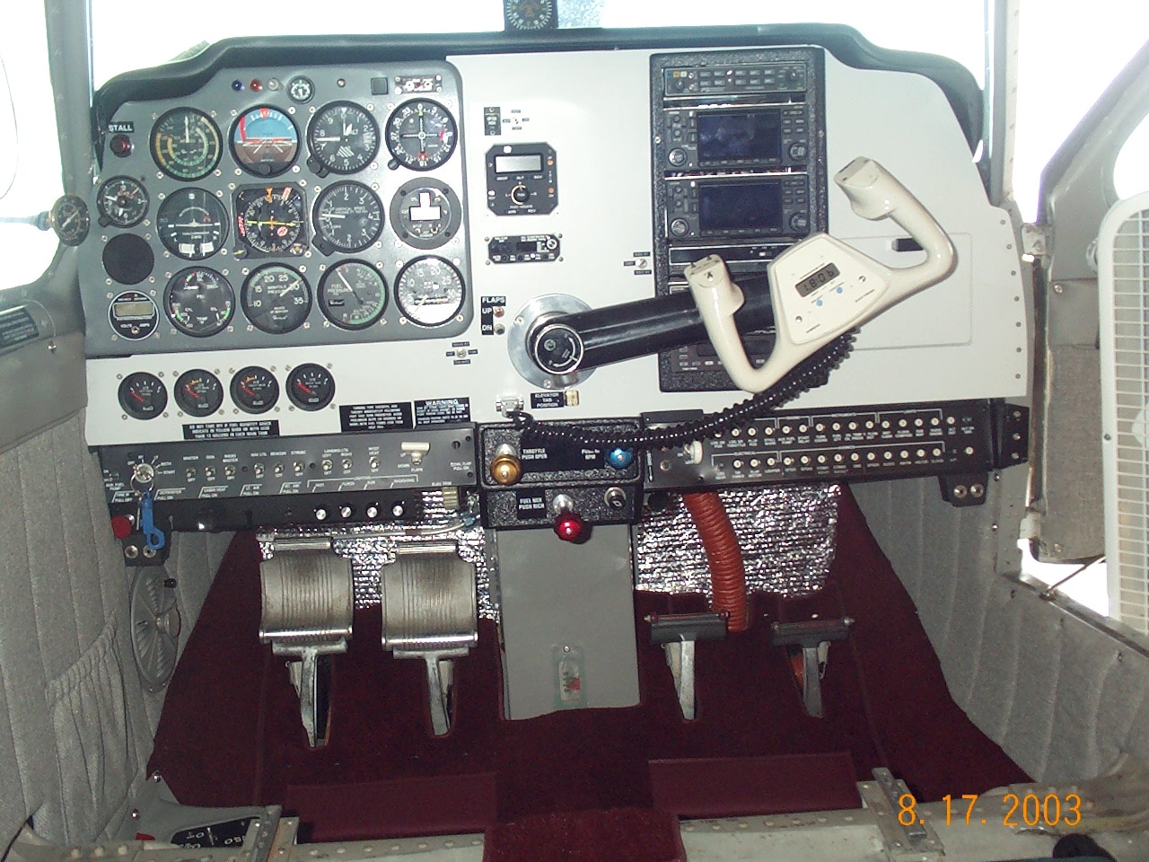

I didn't mention that I'm a pilot and bought a 1963 Cessna 172D in 1992. It was pretty sad looking, so I had it painted, then a couple of years later gutted and replaced all the interior, the instrument panel and all the avionics. That made it a really nice plane to fly trips in.
Then in 2001 I sold the 172 and bought a 1960 Beechcraft Debonair that was in similar need of restoration. Did the same thing to it, had it repainted, gutted and replaced the interior, panel and avionics. Then in 2005 I replaced the tired Continental IO-470J with an IO-520BB and a McCauley 206 three bladed prop. With 285 hp, it was like flying a completely new airplane. It would cruise at 160 kts at 8-9000 feet on 13 gph.
A friend, who has built and rebuilt several planes in the last 60 years looked at the Deb when I had the panel torn out and said "If you die, they'll have to scrap this plane."
