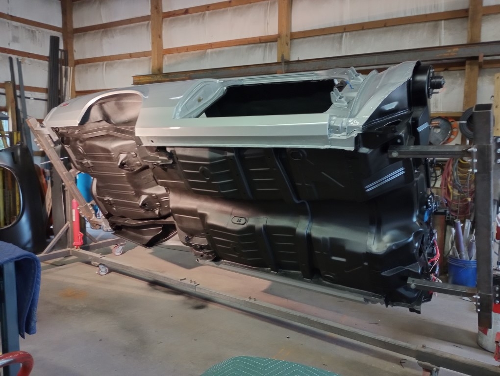

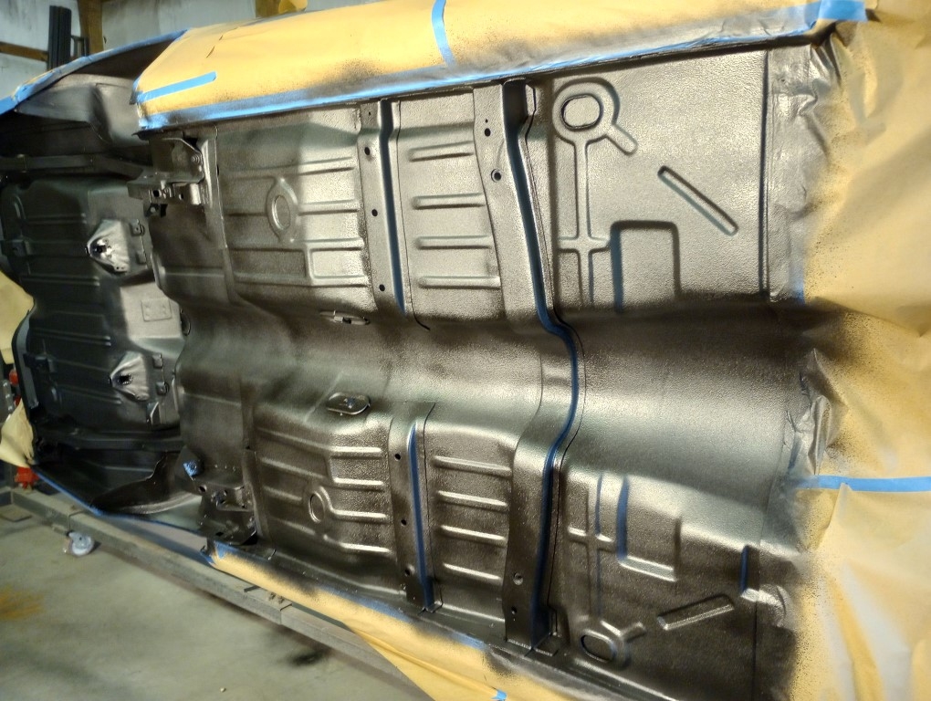

Did a few odds and ends, made a bracket for the roll over vent valve, located all the anchors for the seat belt bolts and removed the sound deadener around them, applied silicone to the four covers for the floor drains and put them in place, built a harness for the fuel pump and sending unit, laid out the rear section of the brake line and massaged it into the correct shape.

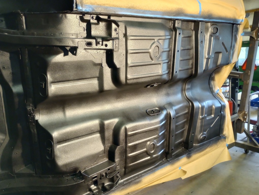

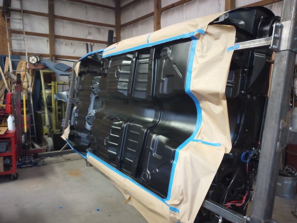

Like I said before, I'm going to apply undercoating to the underbody, so I spent a while taping and masking off the area to keep any overspray off the paint. I have two cans of the POR15 undercoating, but according to what I could find out, each can only covers about six square feet, so it's going to take a total of eight cans to do the job. I have the other six cans on order, and they should be here on Thursday.
Once that is done, I can install the fuel tank, fuel lines, fuel filter, rear brake line, pinion snubber and axle bump stops.
I have to finish up applying the sound deadener on the wheel house, trunk partition and package tray, so I'll probably work on that tomorrow. Then I'll work on applying it to the insides of the doors.

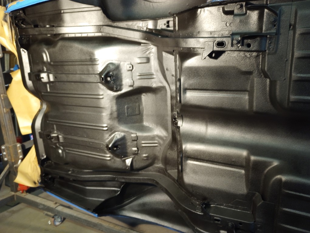

The six new cans of undercoating came via UPS today. Yesterday, I used up the two cans I had on hand, and once applied, it looked more like slightly thicker than normal black paint. I was able to cover all but about a foot of the underbody with the two cans, giving it a pretty liberal coat. Pulled out the new cans and started applying it, it was completely different, much thicker and making a pebbly surface. I used four cans to cover the whole underside, giving it a liberal coat, with an extra coat on each rear wheel well. Once dry, the surface looks like spray-in bed liner, less texture than while it was wet. Looks much more like real undercoating than the material from the other cans.
After an hour or so, I pulled off all the masking paper and tape, and only had one little stripe around the right rear wheel opening from a gap in the tape. A little naptha cleaned it right off.

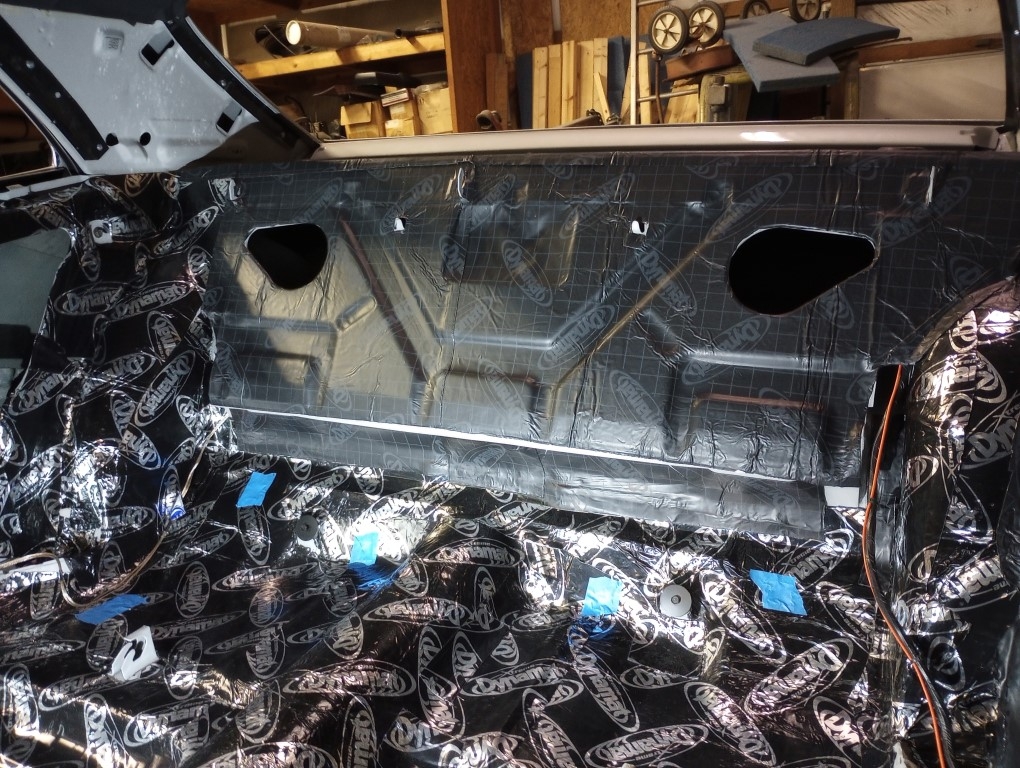

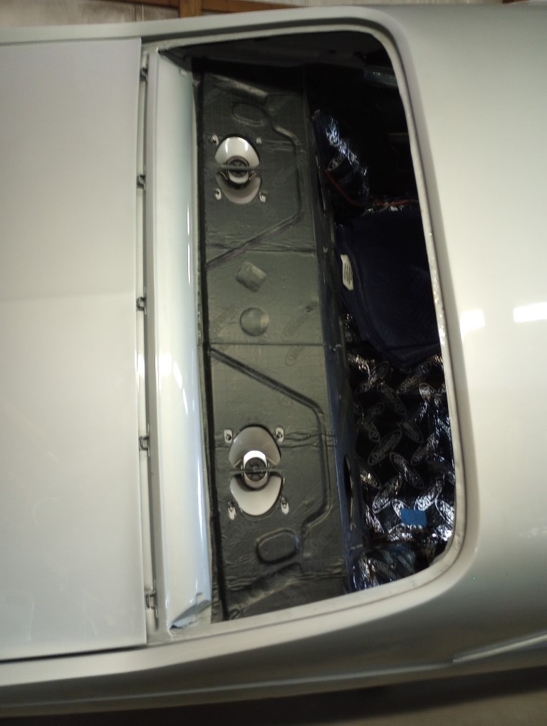

I had gotten the new box of Dynamat, so I decided to finish up applying it to the interior. I covered the left wheelhouse, then the bulkhead behind the rear seat, and the package shelf. The new stuff doesn't have any shiny aluminum showing like the older (10 years older) product, which has the Dynamat logo in a matte black. The new material is the same thickness and the sheets are the same 18" X 32" size.
To cover the package shelf, I had to remove the speakers, then cut out the speaker openings and the access holes in the bulkhead to get access to reattach them. I'm thinking of making some thin metal covers to close off the openings, since they serve to defeat the purpose of the sound deadener, and put Dynamat on them too. I have some 18ga. or 20ga. sheet that should work fine for the purpose.

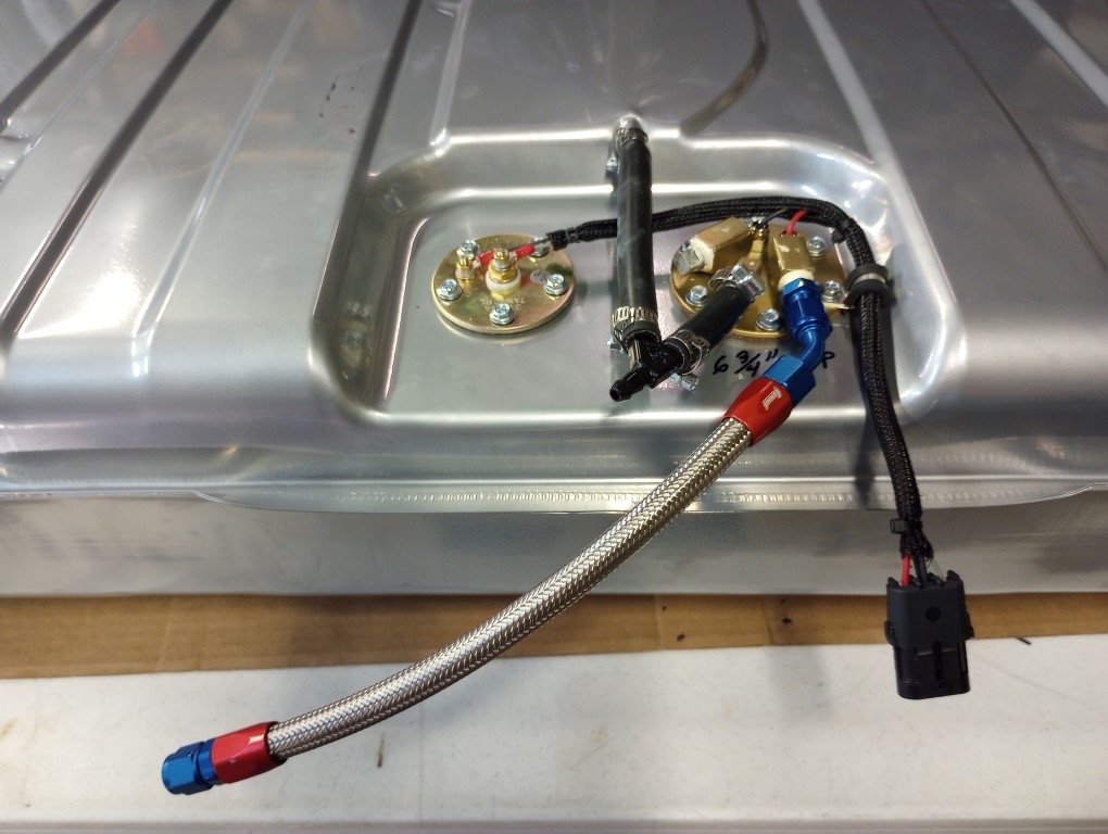

Now I can permanently mount the fuel tank and fuel line, then make up the harness to attach to it for pump power and fuel level signal.

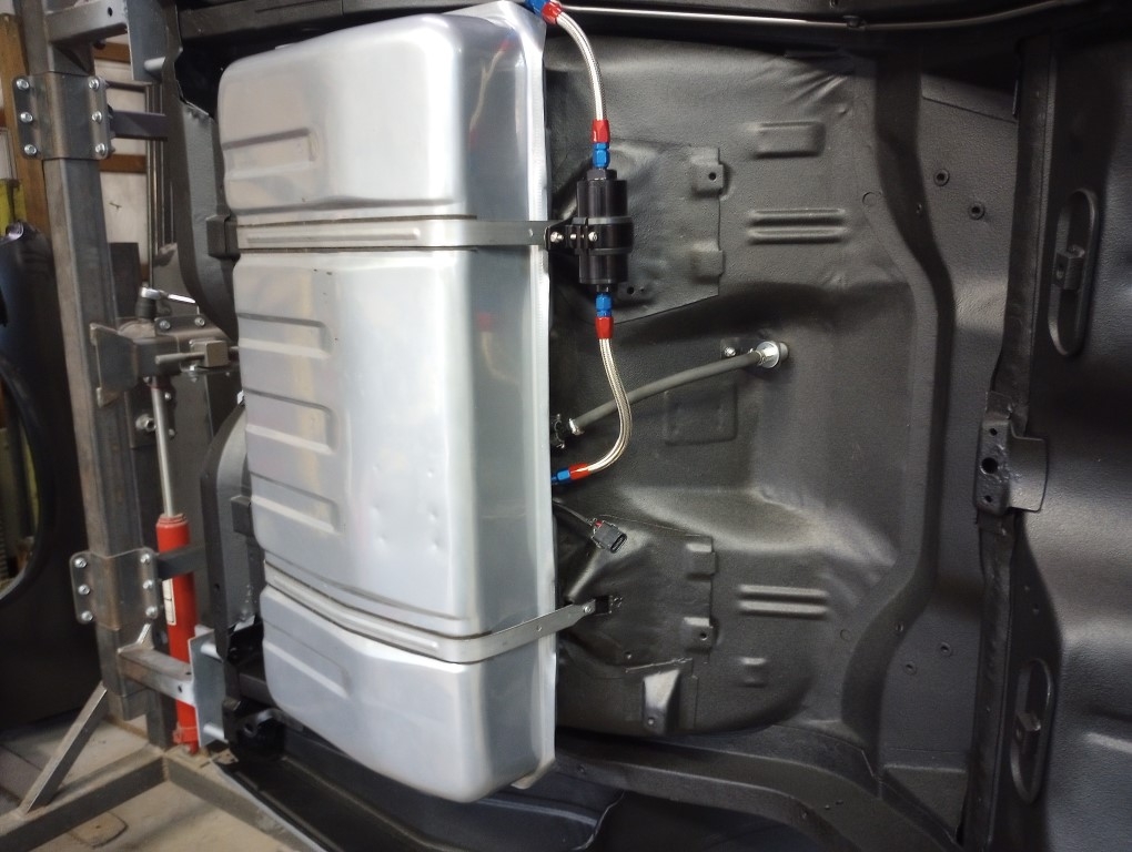

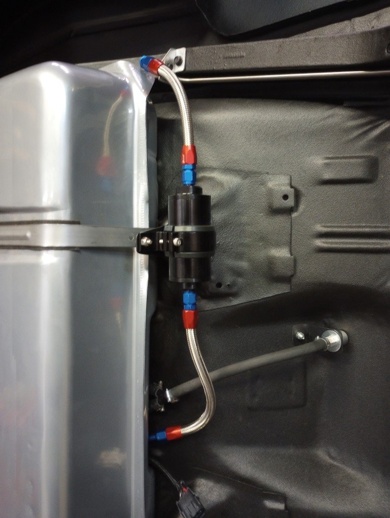

I got the fuel tank and lines installed today, looks pretty good. I'm still cogitating on just how to run the wires though. Originally, the only wire, for the fuel gauge ran to the back by the filler neck and then on top of the tank to the sending unit. I'm thinking of a shorter route, going through the trunk floor in front of where the spare tire sits. That would save probably eight or 10 feet of wire, I just have to decide exactly on where to put the hole.

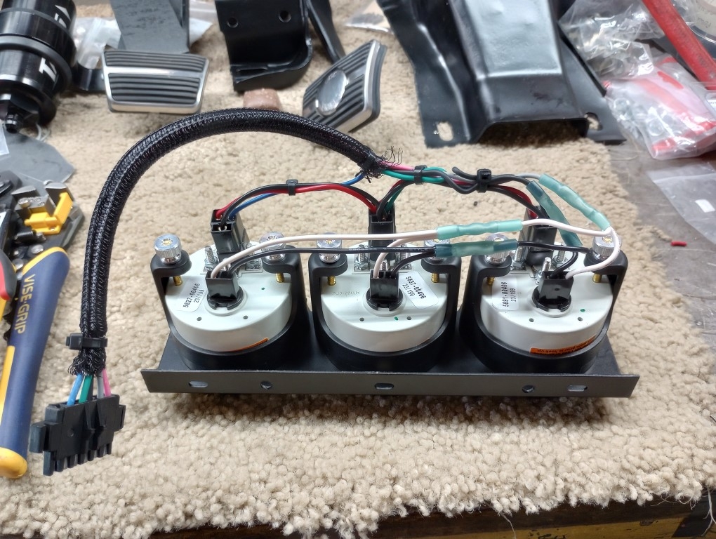

When I installed the headlight switch, I foolishly stuck the supplied shaft and knob in so I could operate it so I could test all the light circuits. I found the original knob and shaft, but with the switch installed, there was no way to get my hand in to push the little button to release the shaft. Sooo, fortunately the new knob was held on with a set screw, so I could remove it and use a deep socket to remove the nut holding the switch in. I got the switch fished out and removed the shaft, made sure the old one was the correct length, removed it and spent another 15 minutes getting it back into position, clocked correctly and getting the nut started into the switch. There is just no room to work in that corner of the dash.

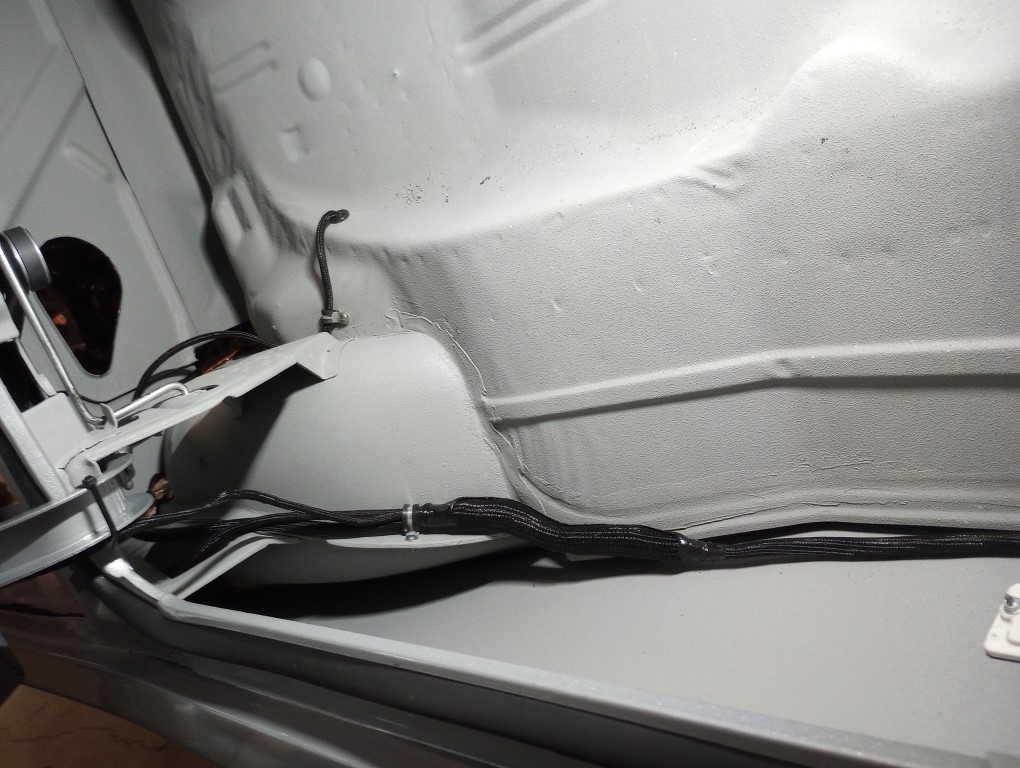

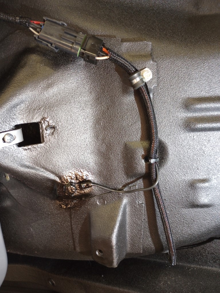

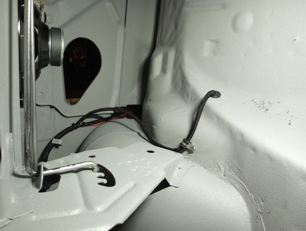

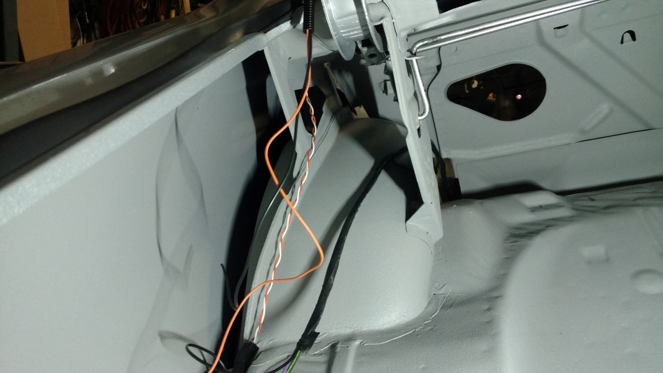

Had to mow the yard today, didn't want the yard police to hassle me. ;) So, i Didn't get started on the Nova until after 4:00PM. I deided to address the rats nest of wiring in the trunk where the dome light wires, the trunk light and release wires, the fuel tank wires and the tail light wires all converge. Had to undo a few feet of tape I had wrapped the harness with to get the fuel tank wires separated out. Shortened a couple of wires were too long and then covered all the groups with braided sleeve to make it look better, and used a couple of loom clamps to hold them in place.
I finally decided where to drill a hole in the floor to run the wires to the fuel tank. I put it on the left side just inboard of the rear frame rail, dhould be pretty much out of the way there. I put a self sealing grommet in the hole and ran the cable through, cut everything to length and installed the 3 pin weather-pack connector. There was a 5/16" threaded hole close by so it used that to provide the ground for the pump and sending unit. I even gave it a spritz of undercoating to seal it up.
By the time I got that done and everything put away, it was after 7:00PM so I called it a night. I'll be back at it tomorrow afternoon.
