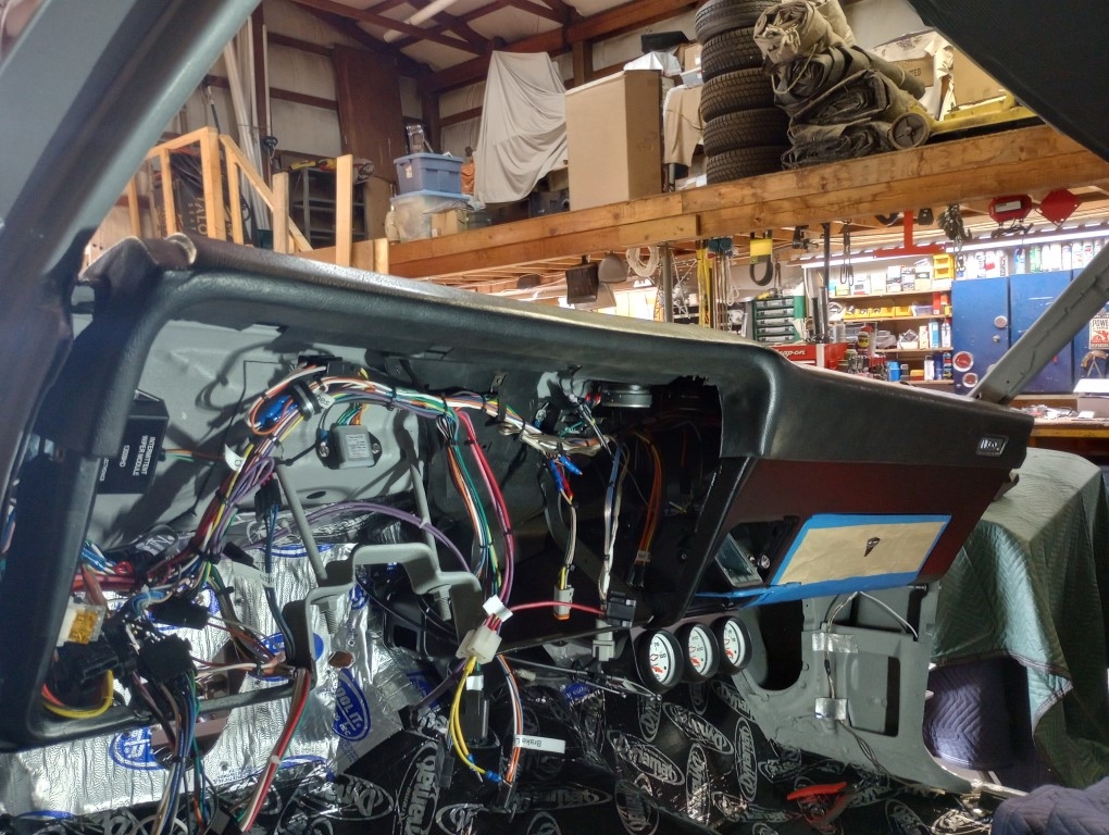

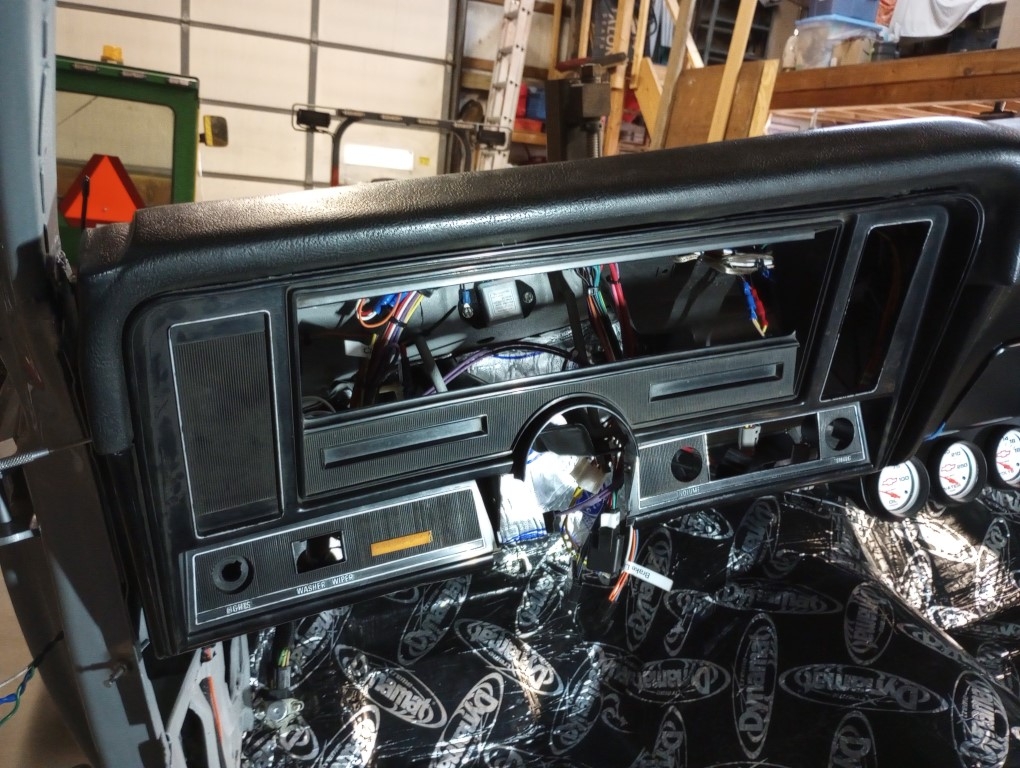

Spent all afternoon working on the Nova today. I changed some wiring that was bothering me a little. The most important was the wire that goes to the in-tank fuel pump. When I ran the harness to the rear of the car, I added a wire for the fuel pump. When I was mounting and wiring up the EFI system, I noticed the wire on that harness was definitely heavier than the one I ran, even though they are supposed to be the same gauge. So, I took the leftover wire that came with the system and ran it to the trunk area to power the fuel pump.

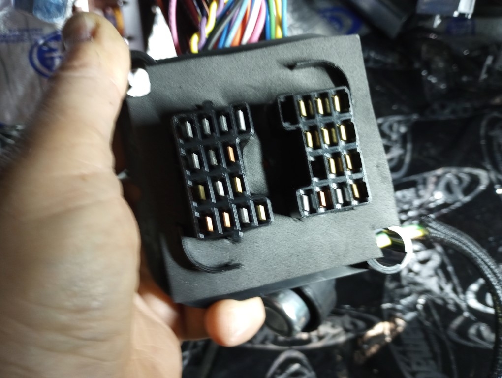

Rather than run the wire through a hole in the firewall, I was able to utilize one of the unused positions in the bulkhead connector. That entailed removing the fuse block, installing connectors in that position, routing the wire and installing a connector to connect it to the wire running to the tank. Of course since I have had the fuse block on and off the firewall at least tem times, the cheap supplied foam gasket went to hell. Took a piece of 3mm foam I had and used my Exacto knife to cut out a new one. So now the same original wire runs all the way to the tank. That soothes my OCD, even though according to the spec sheet the pump only draws about 8 amps at 60 PSI and the wire I ran would probably sufficed. Maybe.
I also mounted a four position fuse block on the firewall to connect the MSD ignition, MSD EFI and Dakota Digital cruise control to the switched ignition lead, and have another circuit available if ever needed. Think ahead!

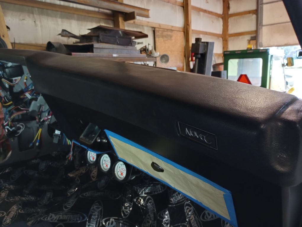

Last of all, the dash pad has been calling me to be installed, so I took it down, cleaned it up, found some new speed nuts that fasten it to the dash, and got it installed. The first item that says Nova has been installed now.
Progress.

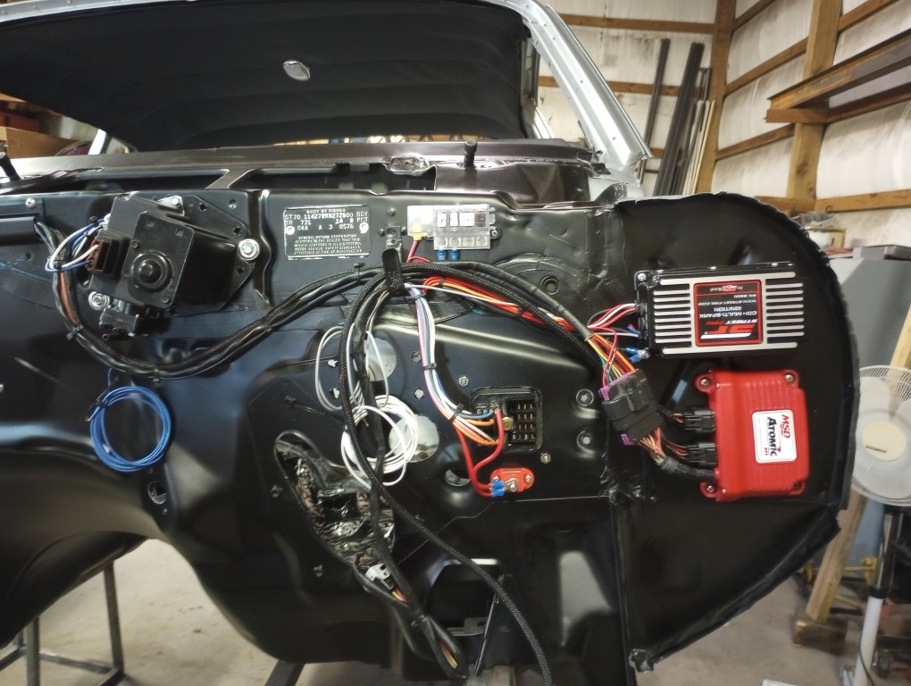

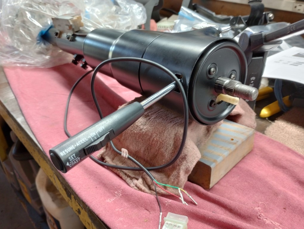

Been working on installing a Dakota Digital cruise control.
MORE wires!
I'm going to mount the servo unit on the left inner fender well, and since that's not installed yet, I'm getting all the wiring connected to the appropriate points.

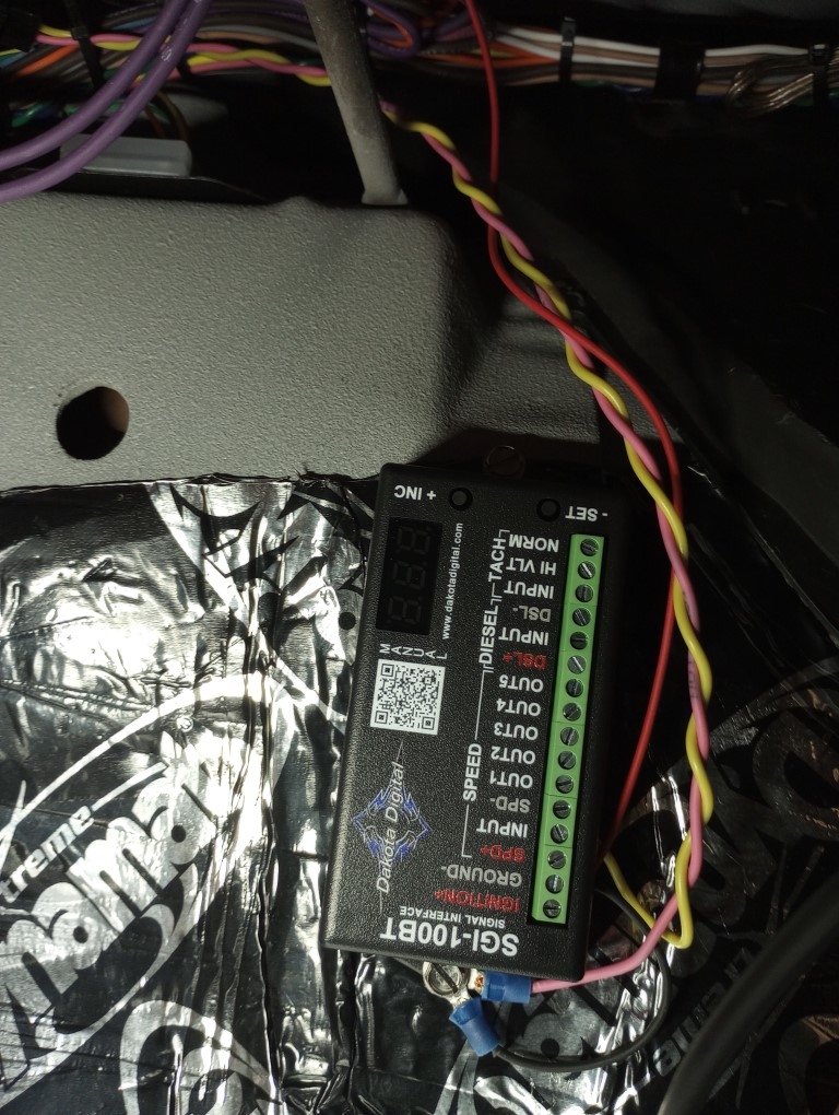

I'm going to be running a Tremec TKX transmission, and in the installation manual it explicitly states:
NOTE: High frequency VSS signals from a Tremec, or 700R4, are too fast for the cruise control to read. In such applications, the Dakota Digital SGI-5E or SGI-100BT Speed Interface Module would be needed to alter the VSS to the Gray wire.
Soooo, I bought the SGI-100BT SIM to massage the signal for input to the cruise control unit. I wasn't completely clear on some of the setting in the SIM, so I wrote and email to DD's tech support. Dave, and that is not his real name, emailed me back that he needed to know what type of signal and the number of pulses per mile (PPM) the TKX's VSS (Vehicle Speed Sensor) output. I did some research and wrote back that it was a sine wave output at 16,000 PPM.
Two days later Dave writes back asking why I was using the SIM, when the cruise control has settings that will let it accept that signal.
I wrote back, really? Then why does it say differently in the installation manual?
Haven't heard back from him on that.
So I spent an extra $100 and a couple of hours mounting and wiring the SIM for nothing. And drilling holes that aren't needed. Grrr. Going to have to plug them as they are in the cowl and would leak if it got rained on.

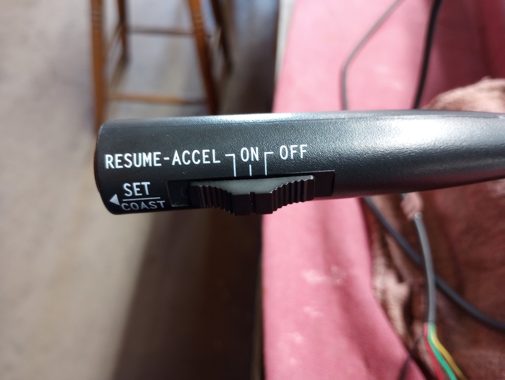

I drug out the steering column and installed the turn signal lever that has the cruise controls on it, Had to disassemble the top of it to get the cable ran down inside the column, but at least I have the tool to compress the spring under the locking column plate so you can get the little snap ring off. All back together and wrapped up again to keep the dust off it.

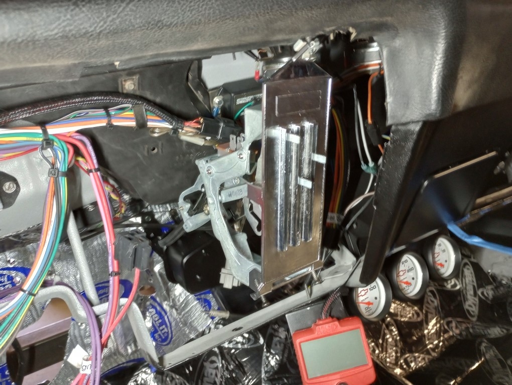

I also got the control head for the heater connected to the control cables, so I'm getting close to installing the instrument cluster. I just want to make sure once I install it, it's in for good. I sis set the old instrument panel in the make sure I don't have and interference problems.

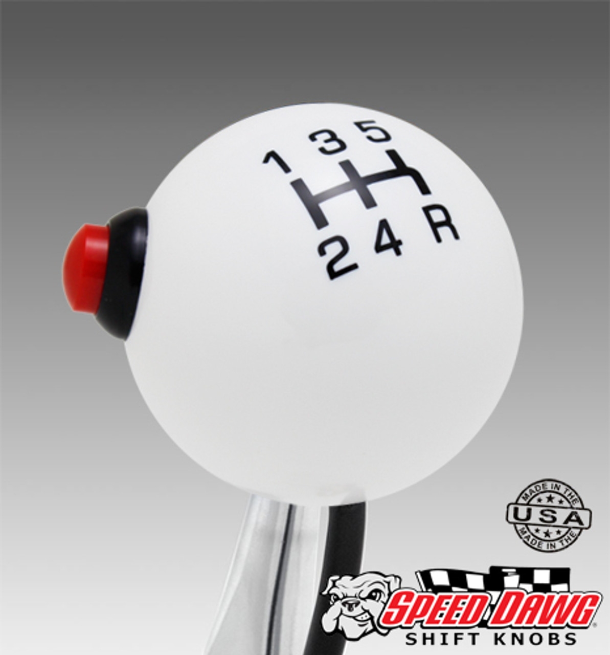

Ya never know when it just might come in handy....
Got this for the Tremec 5 speed shift lever.
