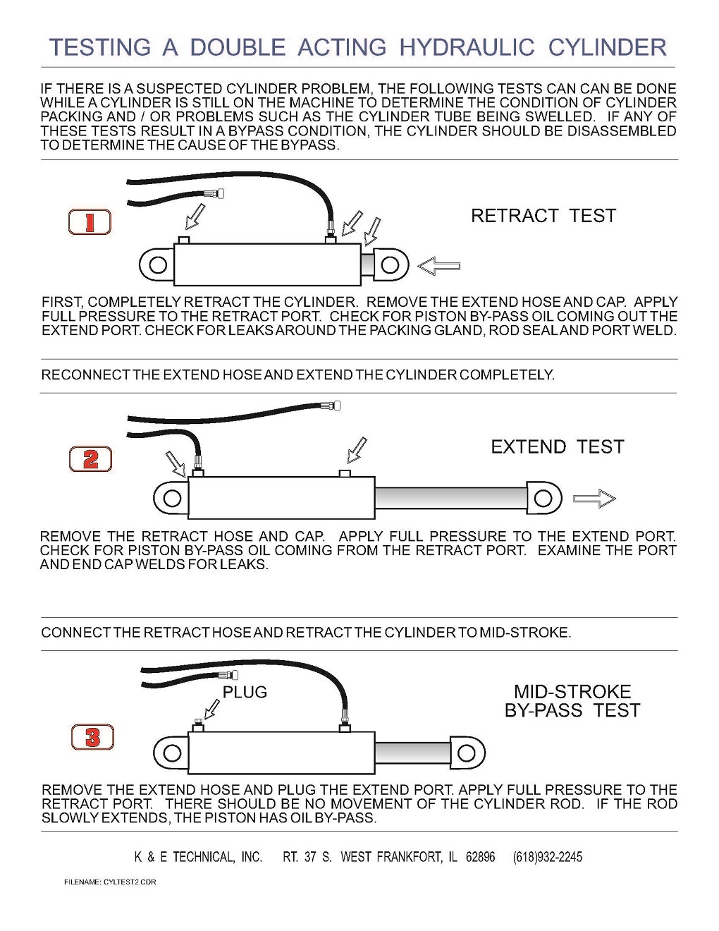

My Kubota has a generic aftermarket loader most likely from the 80's if I had to guess and the bucket drops fast (about 6" height in 2-3 minutes when the fluid is warm, faster at slower engine speeds for whatever reason, tilt droops too but less load so slower) and one of the valves is leaking out of the part that slides in and out (shuttle?).
Anywho, I imagine most of the loader problems are related to the sealing of the valve, what's likely involved? Is it just going to be O rings in there that are shot since they're 30 years old? I looked and don't see any identification marks on the valves, it's a 4 piece thing, end caps that have the inlet and outlet fittings and the two stages for the lift and tilt and two bolts going all the way through all 4 pieces.
Not leaking enough to have to add fluid but it's making a mess and the drooping bucket is getting old...

You need to take the time to go thru the attached cylinder test procedure. Rarely it is the valve!
Even leaks from the valve's external features like float detent, do not account for dropping loader arms and buckets..
If you determine the loader valve needs replacing, do not make the mistake of going with a flow rating bigger/higher than your system's performance which is likely around 4 gpm unless you have an external pump just for the loader.
The result of too big a flow rating is a loader with no fine control. Better too small than too big.
