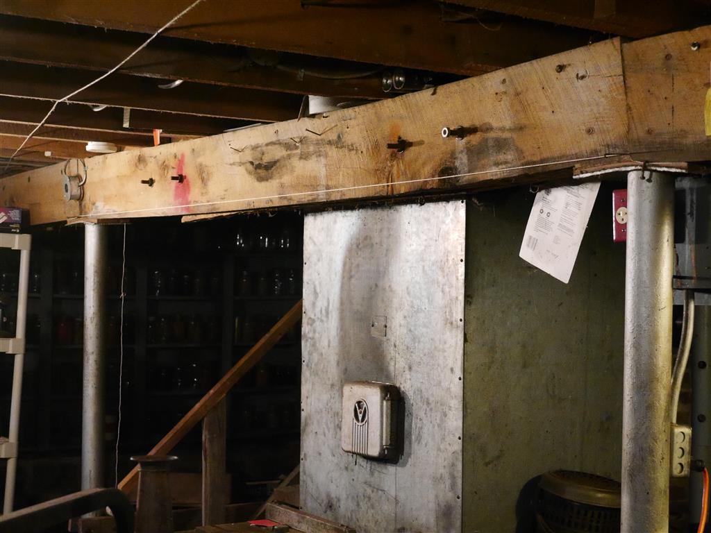

The beam is about 30' long with two support posts. The center part of the beam is 112". How big and long of a temporary support beam are we talking about? A temporary support beam would tend to spread out the load of the floor being raised into position without so much plaster damage compared to raising one floor joist at time? I assume I'd have to at least work in 10 foot sections. How many jackposts would be needed?
This is the good side of the center beam. The back is eaten up.

I already see one telepost (jackpost) in the picture right on the right side. You could probably get away with three but four over the 30 feet would make the job a lot easier. I would check a rental place to see if they have something you could rent if you don't want to buy.
A house mover might have a beam you could use temporarily.
I would be temped to do the whole thing at once instead of in sections. There would be less damage to the plaster. See if you can't get a 6x6 or an 8x8 treated post long enough to use as a beam. If you are planning on leaving the beam up there the bonus is that termites don't eat treated wood.

Just a thought but would a metal "I" beam be better for the work you intend doing. I doubt that it would sag under load if a deep beam is used. You can put as many or as few jacking posts in as you see fit. This would allow very controlled adjustment and be versatile is use.
As I said, just a thought. If you are going to try and fix the sagging, you need something that just won't move when put in place.

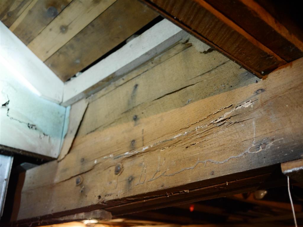

Hmm, this is part of the reason I want to pull the existing beam out.
I looked at support jacks at my local home center was not favorably impressed with the thin metal pieces that go at each end of the post. The post itself looks a lot thinner than I remember these things. The only way these things can meet the load rating must be based if they are installed per the installation instructions with a thicker piece of metal. What they include in the package is not what I would use.
This may mean a trip to the salvage yard to see what I can find there.
Why haven't the floor joists been affected by the termites? Did you just get lucky and catch it early?
I agree, they're crap, that's why I only used each one to support a couple of floor joists. So I probably had at least a dozen of those things on each side of the main beam. I reused the old support columns once I put in the new beam.
