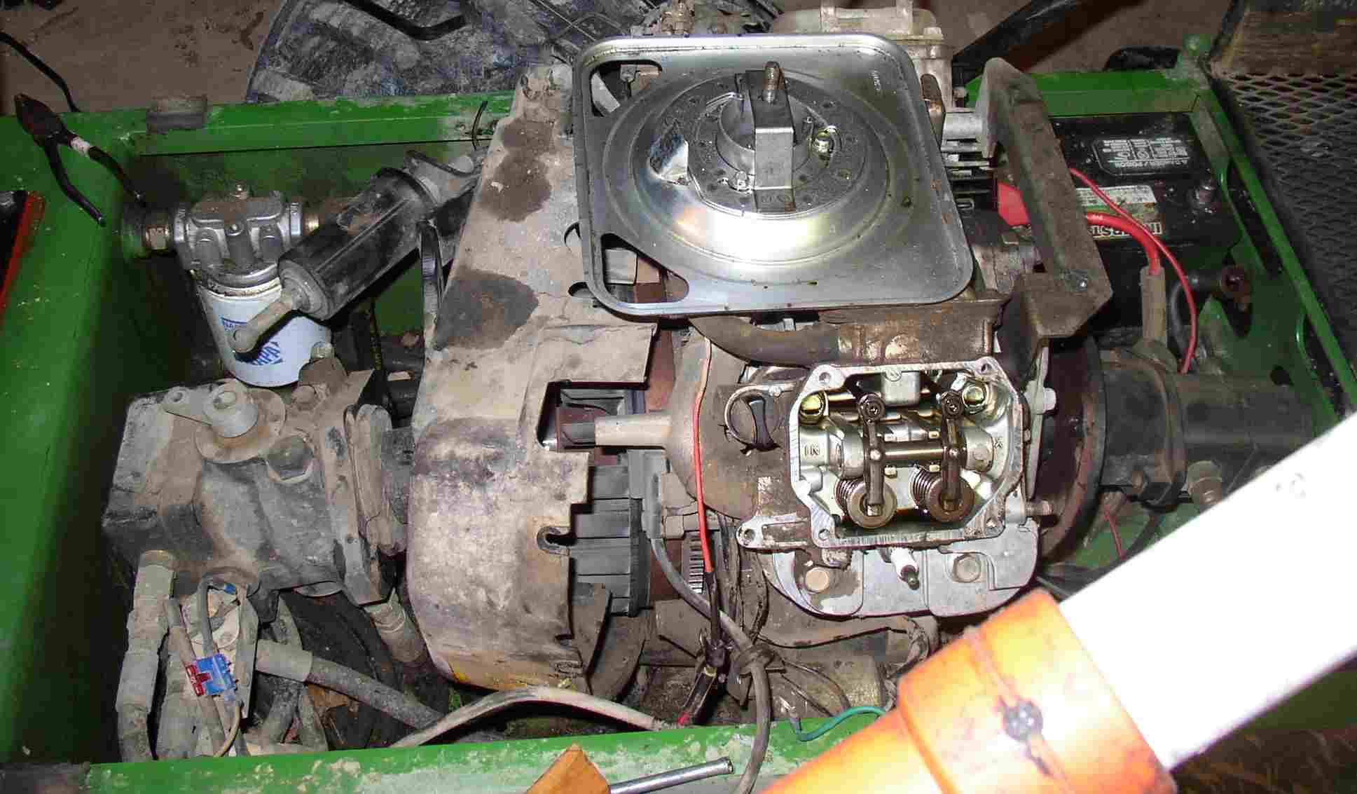

I am sending a few pictures.
The one of the fuel pump side does not really give you an idea of the advantage of this removal, but by removing the fuel pump I was able to slide the engine and bracket about two inches towards the fuel pump side and then was able to remove the start which is on the other side.

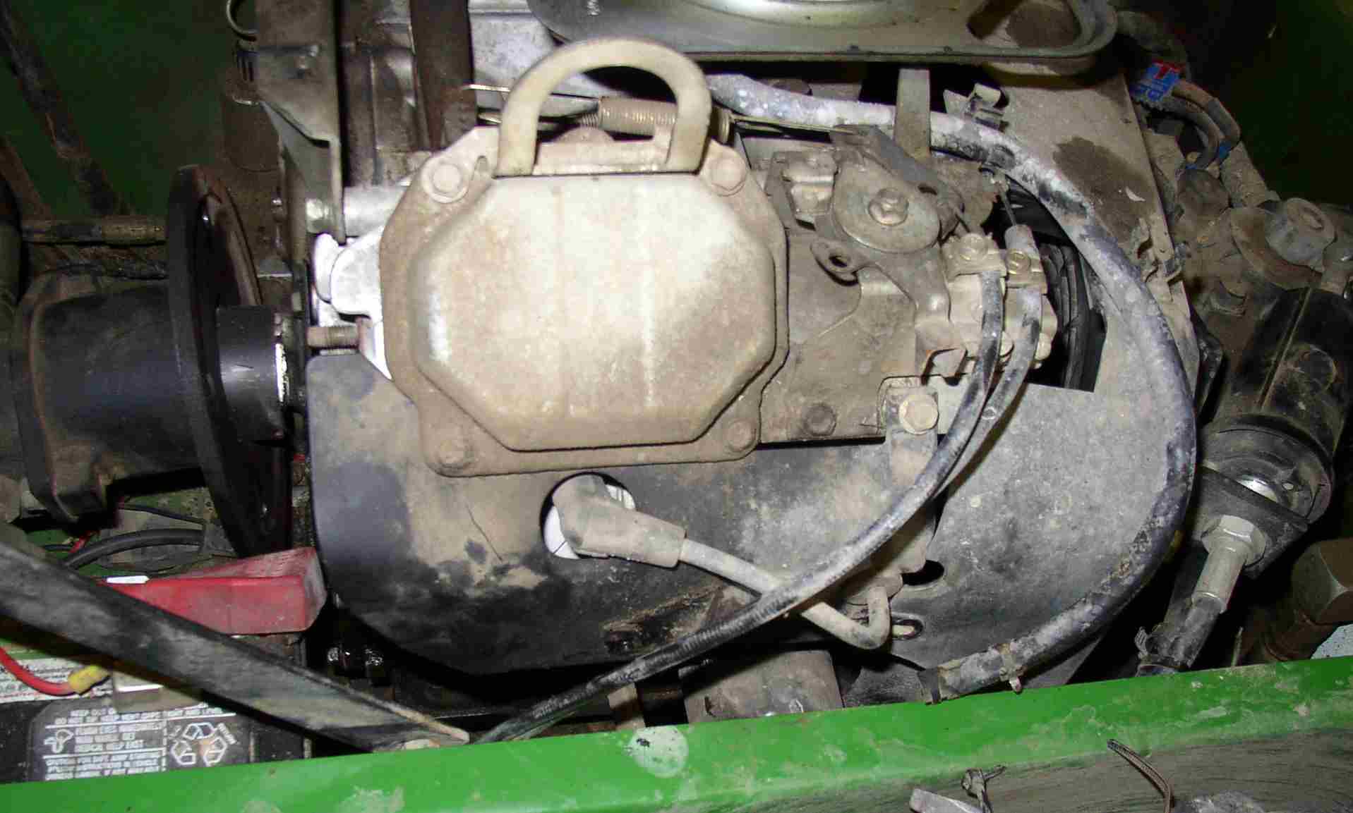

This picture shows the starter motor side of the engine. The starter motor has already been removed. Please note that one ignition coil is visible. Also both front and back hydraulic pumps have been unbolted. It may not be necessary to unbolt the back pump. I have rebolted it with one bolt and will try to finish the job with it installed. Also note that the gas tank and gas tank bracket have been removed.
I am not quite sure how to get to the coil on the fuel pump side of the engine, but I will investigate this further once I have replaced the starter motor side coil and the starter motor.

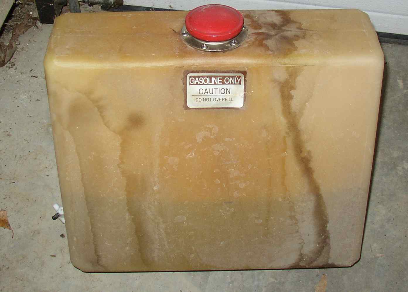

This is a picture of the gas tank. Pretty boring. Please note that on the left side is a little white valve. I had previously installed this so that I would not have to drain the fuel tank when I removed it. This saved me a little time.
So far I have not had to disconnect any hydraulic lines.

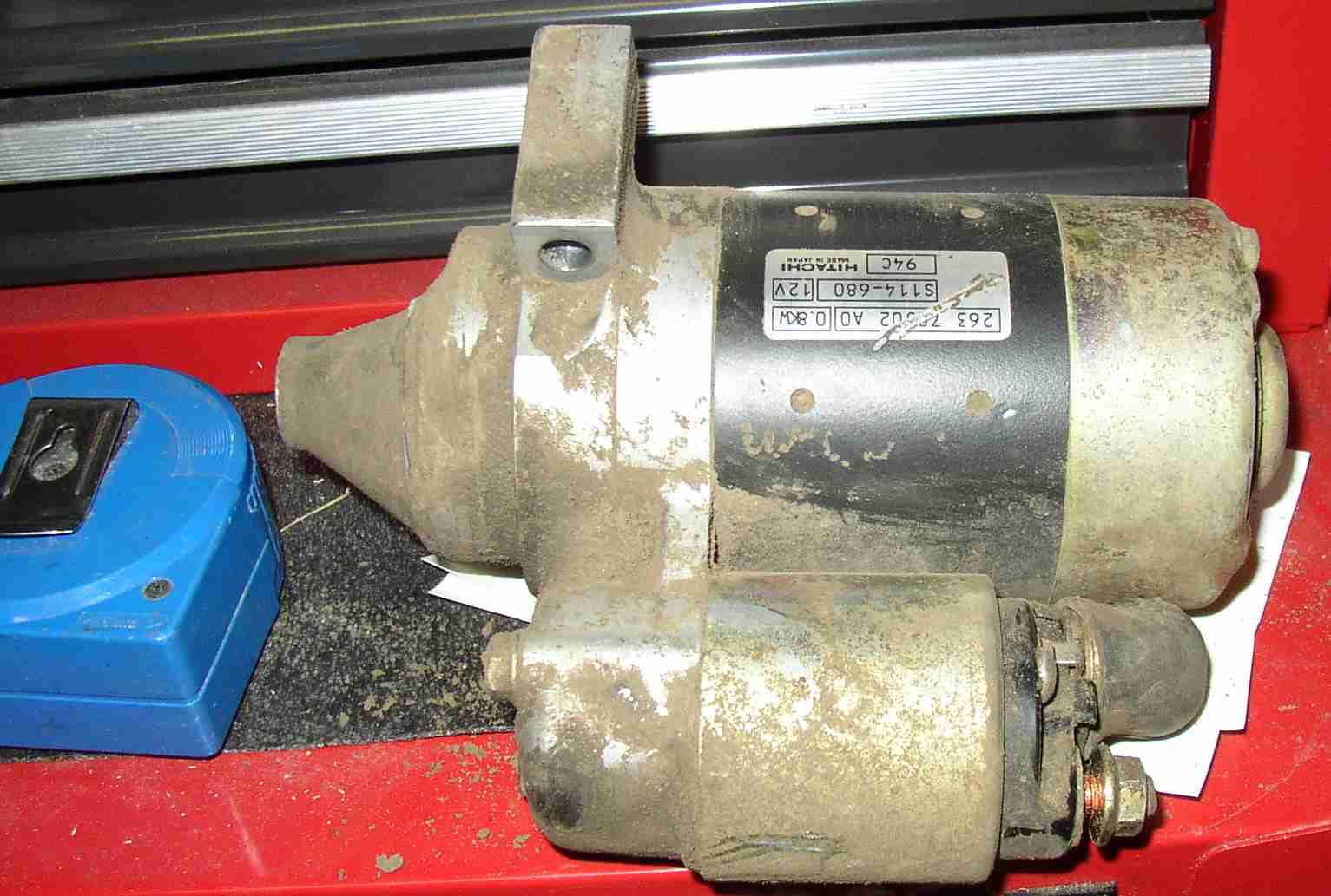

I thought it might be a good idea to attach a picture of the starter. The left end of the starter goes towards the front of the tractor. You can see the 0.8 KW rating. The new one is 1 KW. This is about 25% more power and probably torque.
The label on mine was coated with dirt and I could not read or see the label until I removed the starter and wiped the dirt off. The label is up and maybe you can see it with a mirror when the cylinder baffel is on. I did not try that.
