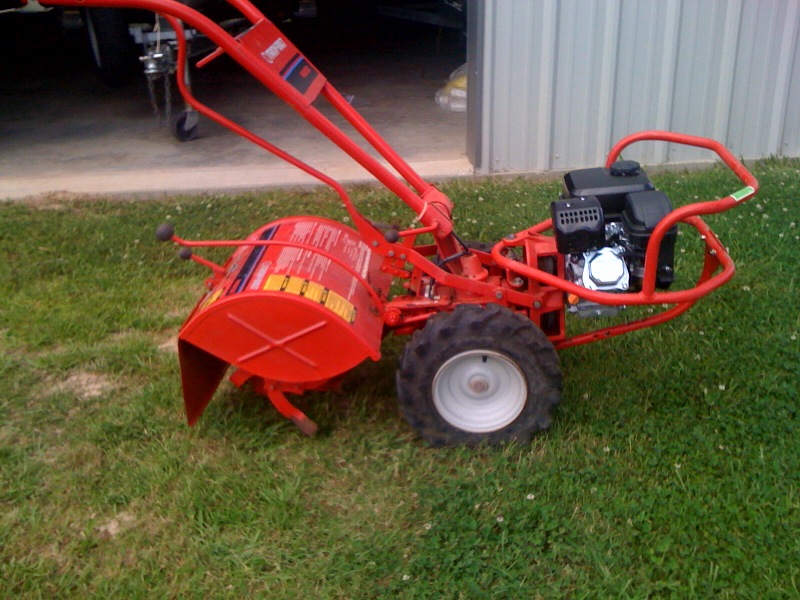

could uses some advise on new engine to replace old 6hp tecumseh I want to be able to use throttle cable I kind of concerned about the engines I've see with the throttle on the front of the engine

The 6.5 HP cheapo HF engine is a perfect replacement, but you'll lose the throttle cable, though I'm sure it won't be hard to staple one to it.
If you look in a few DIY magazines you can sometimes find a $99 coupon. I installed the exact engine on mine and it works a treat! You will need to add a few washers to adjust for the reverse disc alignment.

/ Replacing engine on old troybilt horse #7
This one is a HF engine that I put on my Horse, all that was needed were a couple shims to line up the engine pulley and transmission pulley.
http://www.harborfreight.com/predator-212-cc-ohv-horizontal-shaft-gas-engine-certified-for-all-states-except-california-68120.html

Motor should be plug and play if the output shaft is on the same side and diameter. The motor height should be close to the same so that your belts will tighten up correctly. Disconnect your throttle linkage and the motor bolts should be about it. Take some pictures to help remind yourself how it came apart.
