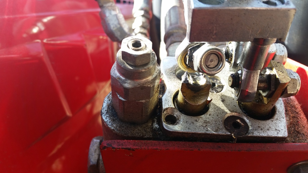

I believe he said the Tilt. I'm Guessing the bucket. So Tech You can't Dump it. That would be a good one.
/ Replacement Loader valve for a V-tek Loader?
What I will call "the tilt rod attachment point" broke off. I really didn't even consider fixing it because I want to get PB and float in a new loader valve.
Normde - I was being silly when I said "took a dump" which I meant that it crapped out and was trying to be funny since the spool that was affected was the tilt down (dump) and up of the bucket.
You can see where it broke in this picture:
/ Replacement Loader valve for a V-tek Loader? #8
Heck that looks like a welding shop could make a better replacement for that broken part.
But I agree, if you're lacking float then replacing that with a competent valve is worthwhile. Another optional feature is Regeneration, I think that re-routes dump fluid into the dump side of the piston to dump faster. I didn't pay the extra $100 for that on my replacement.
Here's a thread where I asked all the dumb beginner questions re choosing and installing a new loader valve. Over 100 replies. Maybe something there will help you get yours set up. That thread includes a link to a similar discussion, there's more info as you read through that. Also note in those threads the back n forth between purists saying 'you can't do that' and others saying 'its worked like that for 30 years, what's the problem'. I decided to set up the replacement like the original and skip adding PB, after considering all the opinions. It works fine.
