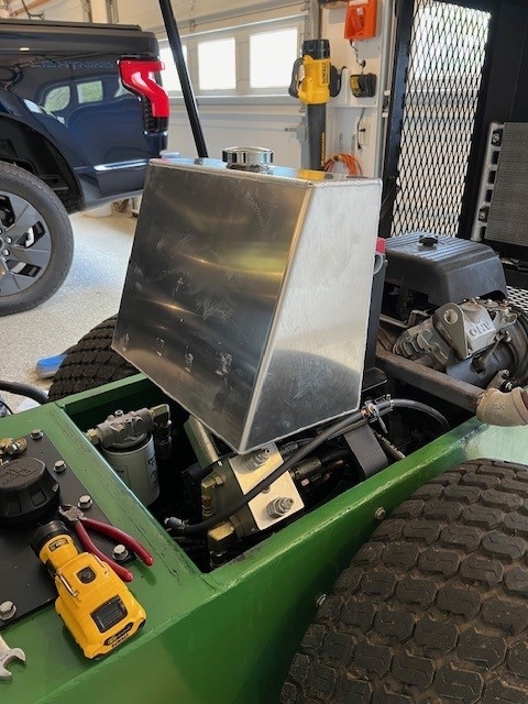

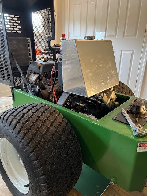

The original plastic fuel tank on my 2006 PT-425 began to leak around the bottom hose fitting. I replaced it with a new aluminum tank purchased from Powertrac. I also replaced the fuel line and fuel filter and added a shut off valve (something that I've wanted to do for years). Not sure if I added these pictures correctly, It's been a long time since I've done this, sorry.

That aluminum tank looks great. I'm sure a lot of members are thinking: Wonder what it cost?
/ Replaced Fuel Tank #5
price ... $482. plus shipping ... a little pricey !
Compared to tanks that I have priced recently, that is not too far off an aluminum tank for other applications.

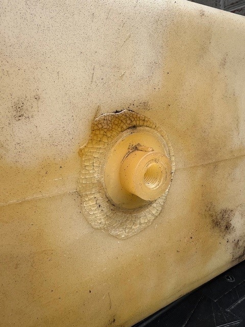

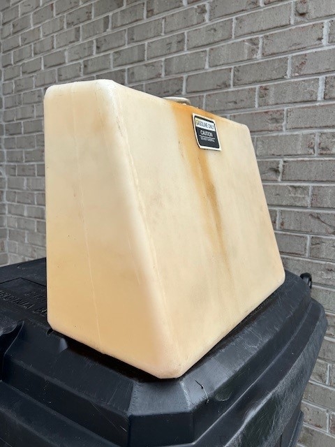

Here's a view of the old plastic tank. The adhesive used at the outlet fitting is old and cracked. That's where the leak occurred.

You can plastic weld that bung if money is an issue. We have welded bungs like this a bunch of times common failure point and easy fix
/ Replaced Fuel Tank #15
Any tips? I have a troublesome polyethylene tank that seems resistant to lasting repairs. I have tried cutting the old oxidized surface off before welding, broadening the weld area, embedding wire mesh and I'm not getting a lasting fix.
All the best,
Peter
Oldish thread, but have you considered mechanically attaching a flange, somewhat like the way the filler neck is attached? Or a metal bulkhead fitting with Viton seal?
/ Replaced Fuel Tank #18
Good idea! The crack is on two intersecting curves, well a col /saddle, but not an impossible shape to fabricate, especially with a rubber seal underneath. The crack is near the top of a cylindrical tank with round top shoulder, at a U-shaped reinforcing rib. The compound curves is why I originally tried embedding screening in the plastic and plastic welding through the screening.
I will think about what I can manage to fabricate here.
