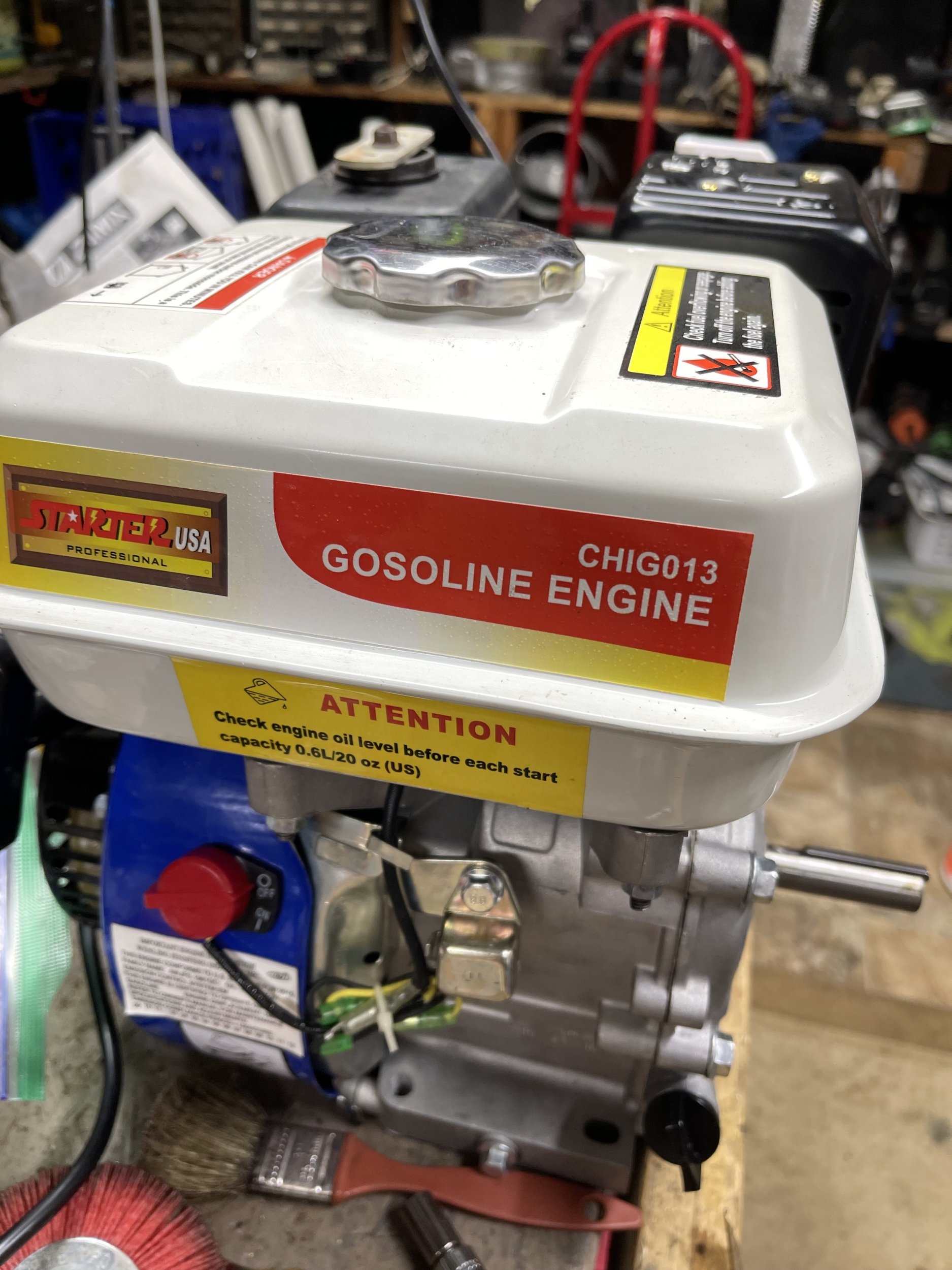

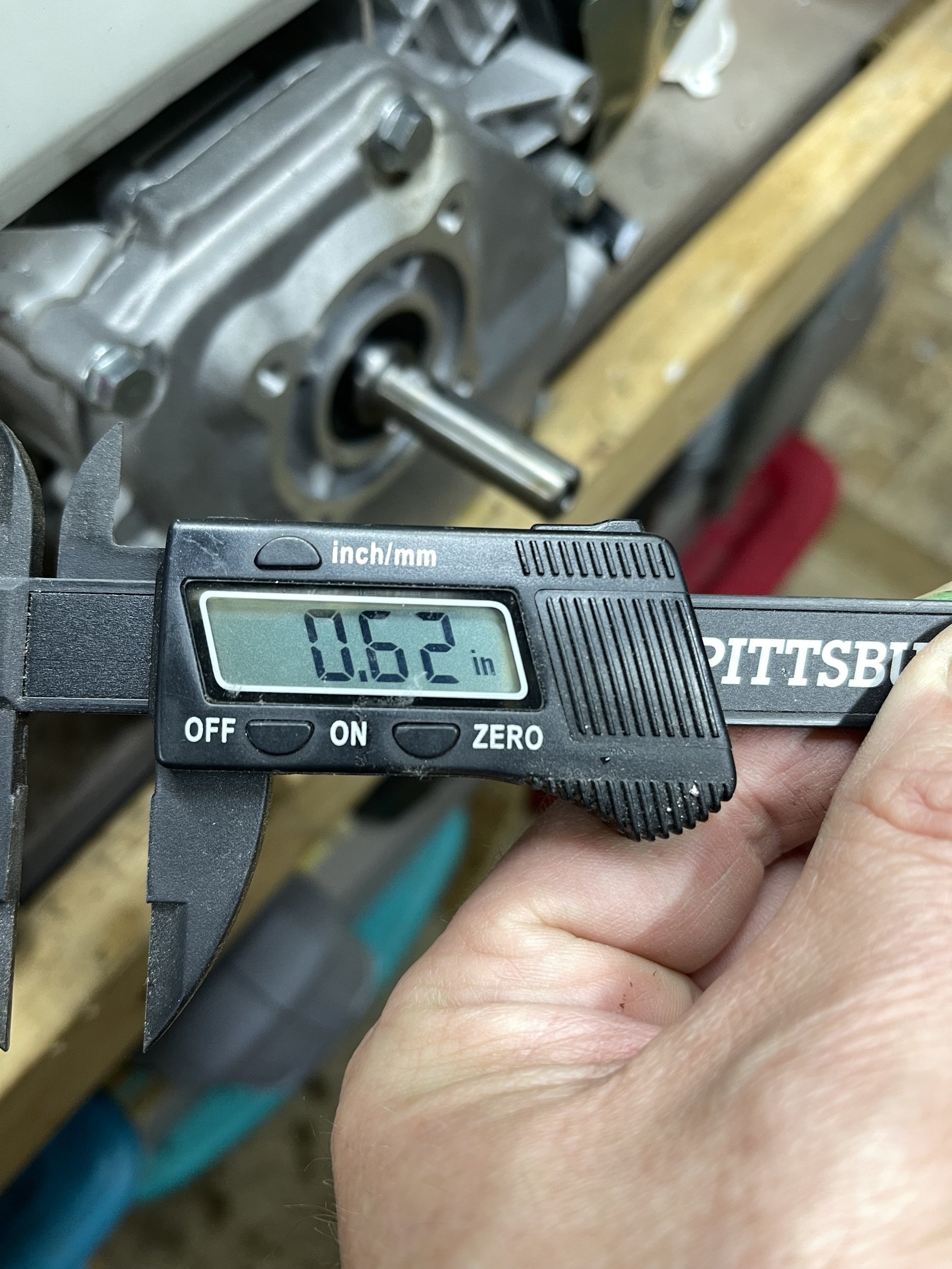

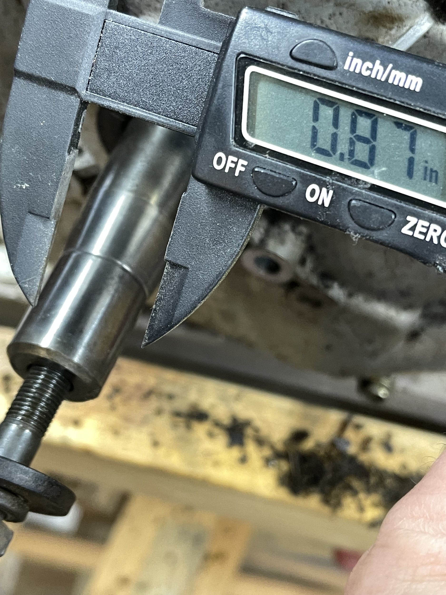

I mistakenly ID’d my motor as a Predator—after a better look I find it’s a “Starter USA Professional” model. (Must have been before Predators) …and another label says it’s a “gosoline” engine! 😜
It’s shaft mics out at .62 mm or 5/8”.
The original MTD final shaft end mics at .87 or 7/8”. 😯
