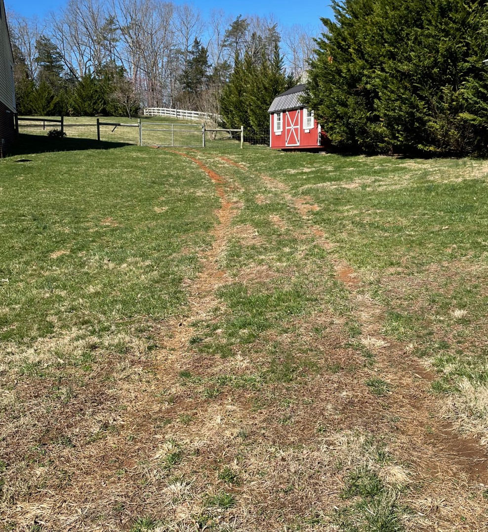

I need to do some lawn and road repair. I have 22 acres and I had a new barn built last year. In building the barn everyone had to drive through my yard daily to get to the new barn location. So it is about 1000 feet back from the road. About 500' or so is the "yard" and then it goes to field. All the traffic made some ruts through the yard portion and that's what I am trying to fix. I have a Kubota L3901 and I have a box blade. I was thinking that I would get some topsoil and use the box blade to spread it. I wondered if I should rent a lawn roller and try to smooth it in or what. I just bought the box blade last year so don't have much time with it so not really at finesse level with it and don't want to do more damage if I can help it :)

In my area, topsoil is now at a premium so I would fill and compact the ruts to 2-3” low then add 2-3” of uncompacted topsoil, rake, seed, mulch and water.

Based on what you've said, I'd suggest you bite the bullet and use your box blade to grade the ruts as smooth as you can get them. You'll get the hang of it quickly. Dont worry. Reseed after you work it back to level. The issue will be clumps of dirt and grass until it all settles back together. You may not need to buy topsoil.
