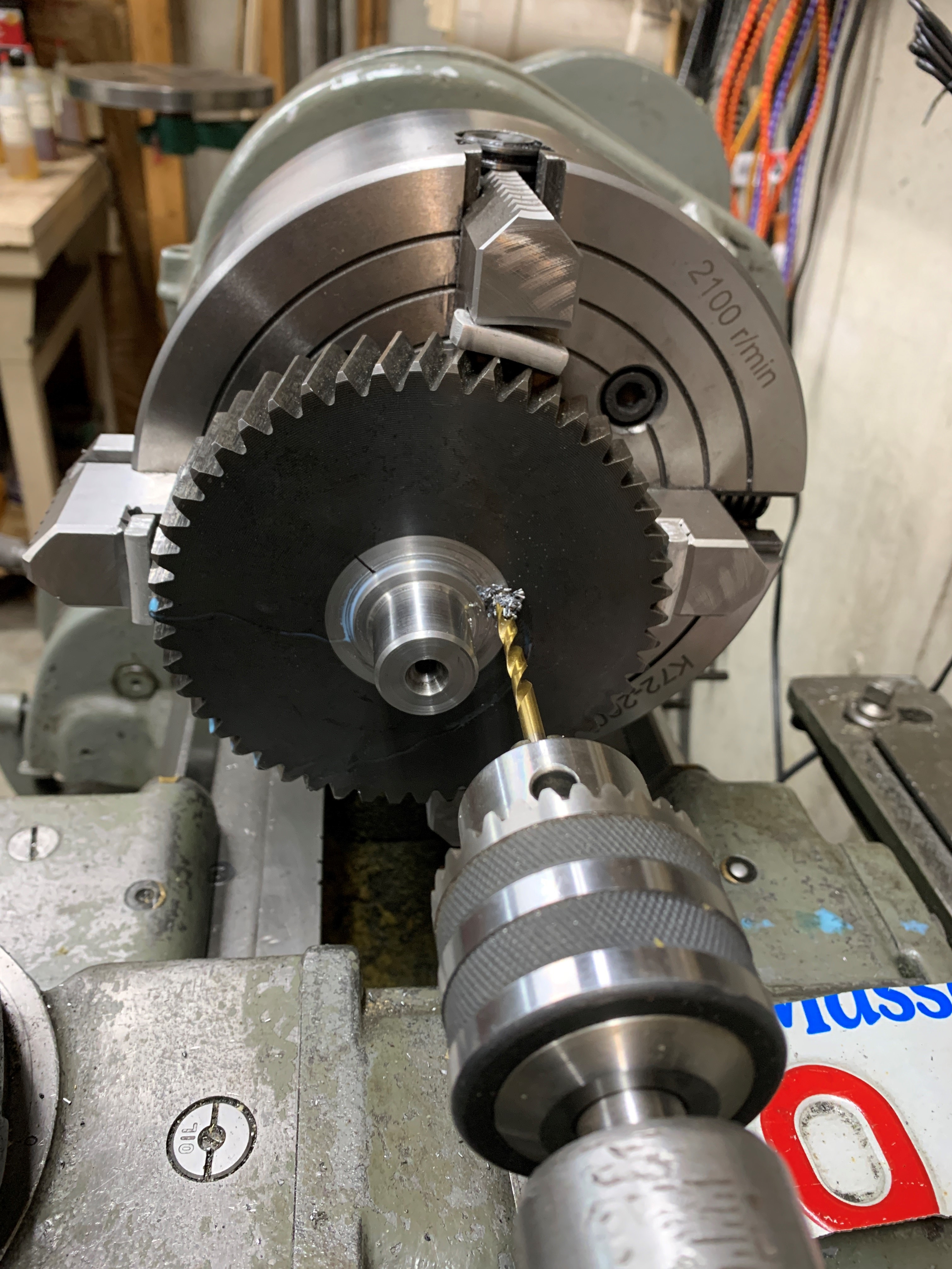

In preparation for drilling into this interface, I took a center punch to create a dimple to start drilling. It did nothing but flatten the tip of the punch. I sharpened the punch and tested in other places, and left nice dimples everywhere. I'm wondering if the compression in the interface has left a very hard material. I ordered a solid carbide #3 center drill and a couple solid carbide 3/16" drill bits. I'll have to drill these holes in the lathe with the 4 jaw chuck so I don't snap off the brittle carbide bit. It's likely that once I get through the hardened exterior of the gear, that I can then switch to an HSS drill that's less likely to snap off and be difficult/impossible to extract.
If the drill bit snapped off in the hole I would just pour it full of JB weld and call it good.

Dan- Do you have an old tap with a pointy end that you can sacrifice as a center punch? But be sure the hammer end is flat. If the material is that hard, you may also need a carbide tap; at least to start the hole. Take it slow and use plenty of tapmagic cutting lube.

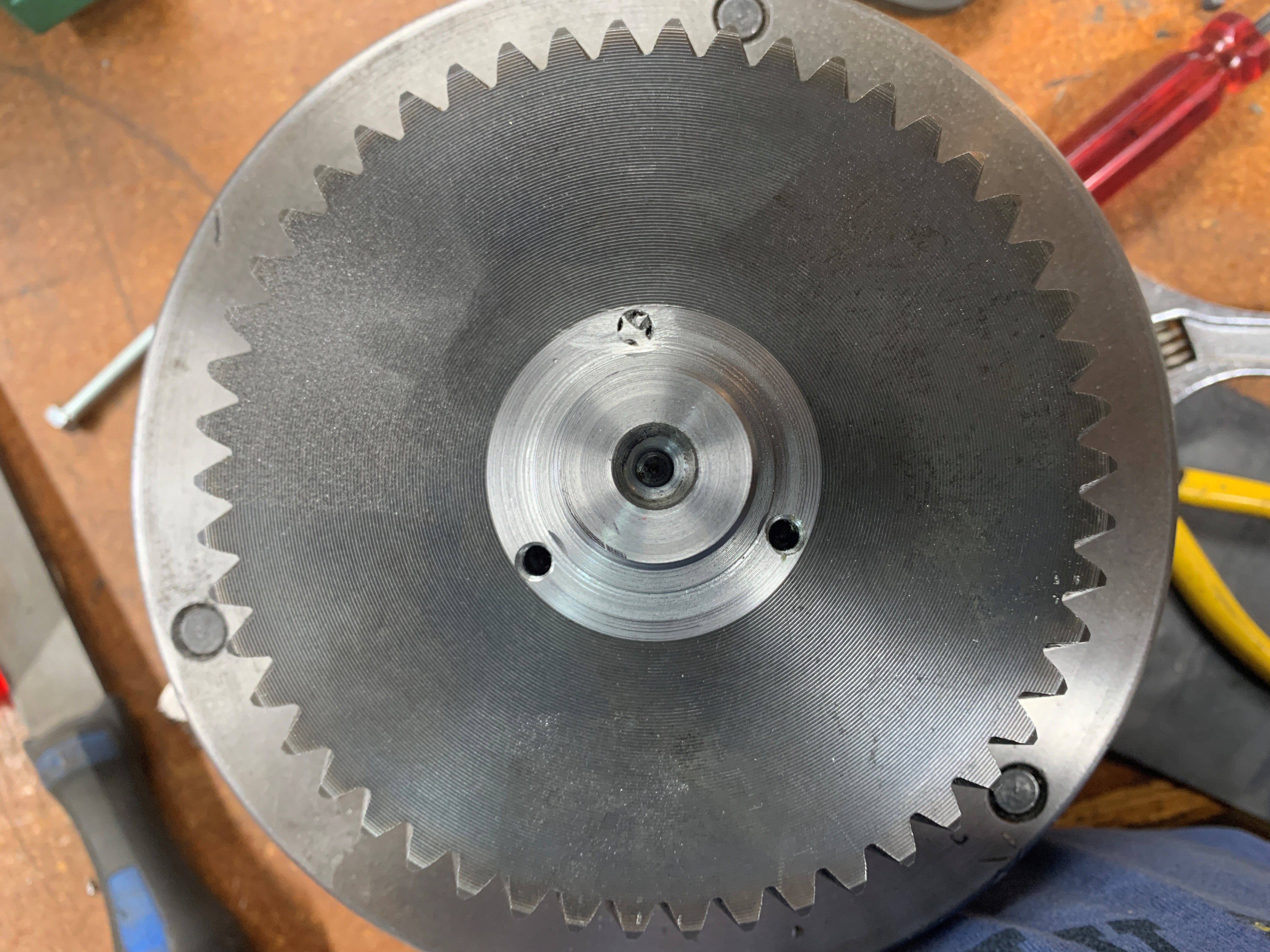

Some progress over the past few days. I don't seem to get much time to work on this....
Anyway, holes were drilled on the lathe. A solid carbide drill bit was used to make it through the hard surface, then an HSS bit was used to get a little more than 1/2" deep. As can be seen, one of the holes now houses a snapped off tap, which will stay. I'm planning to use a pneumatic glue applicator to inject the hole with the slow-curing JB weld to bind that tap in there permanently. If this thing is ever reworked again, then the tap flutes will have to be ground out with a diamond burr before boring. The other holes were tapped with M6-1.0 thread after enlarging the hole a little bit.

Been there, done that, more than once. Depending on how deep it is, you may be able to break up the tap with a punch and do over in M6-1.0. Or you can burn out by edm.
Or possibly tig weld a nut onto the end of the tap. Is the tap HSS, or carbide?
EDIT: nevermind. I just noticed that the protruding end is already ground off. It is in there until you burn it out.
