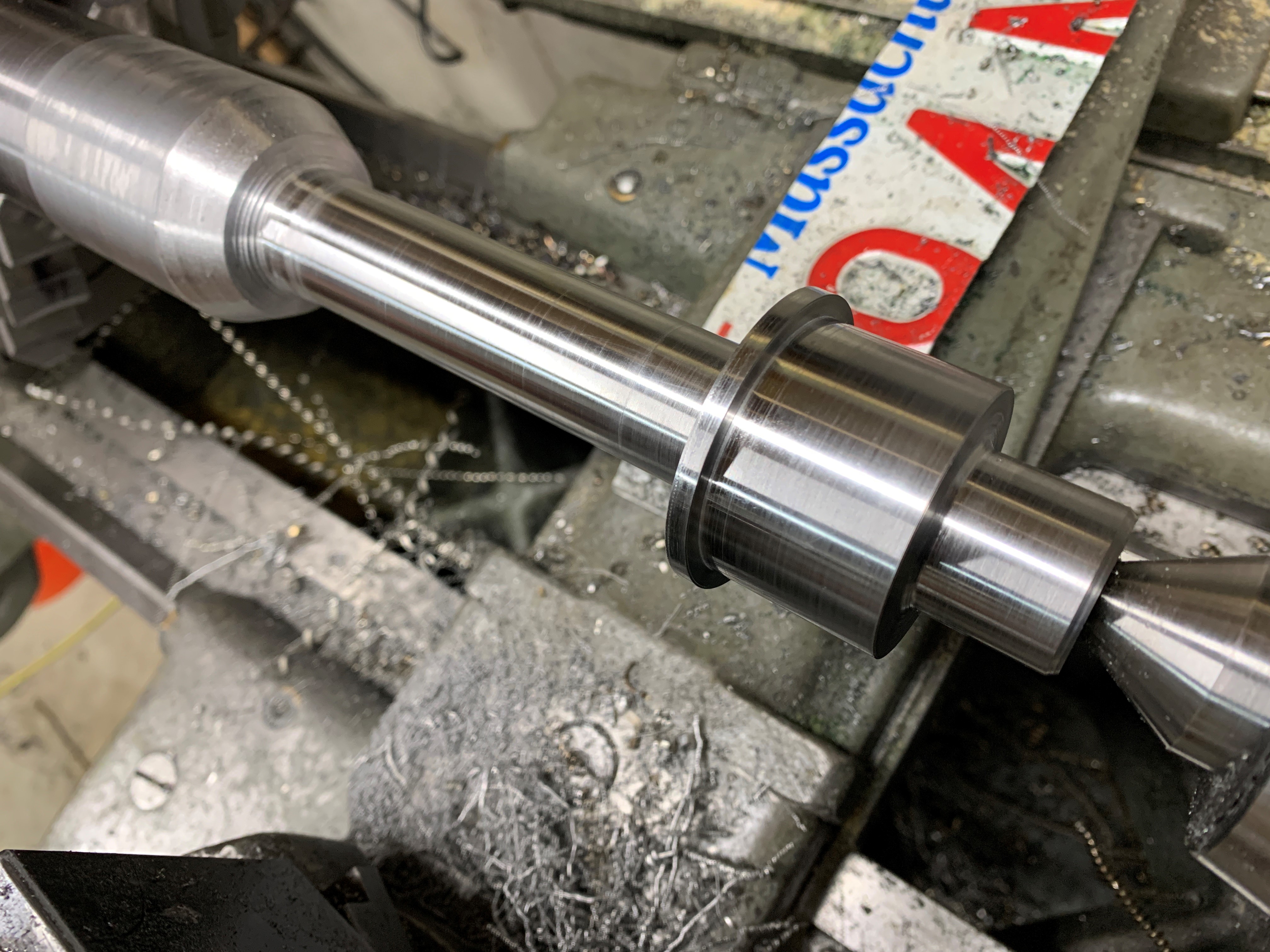

The new shaft is ready for parting. All critical dimensions are right on target to .001". My new micrometer has not arrived, I'm getting by with the Mitutoyo caliper. The measurements are a little better than dubious.
Incidently, the license plate seen in the pic is a chip shield I patched in on the lathe to keep chips from getting into the lead screw to the taper attachment.

Looking great. If the drive end needs a keyway or through hole, you way want to consider leaving the stub on until all operations are complete. It is a convenient place to clamp the part. It is not critical for the parting to be concentric.

Thanks! I will have to cut in the keyway and drill a hole for a retaining bolt. Great idea to clamp on the scrap portion while it's in the milling machine for those operations.

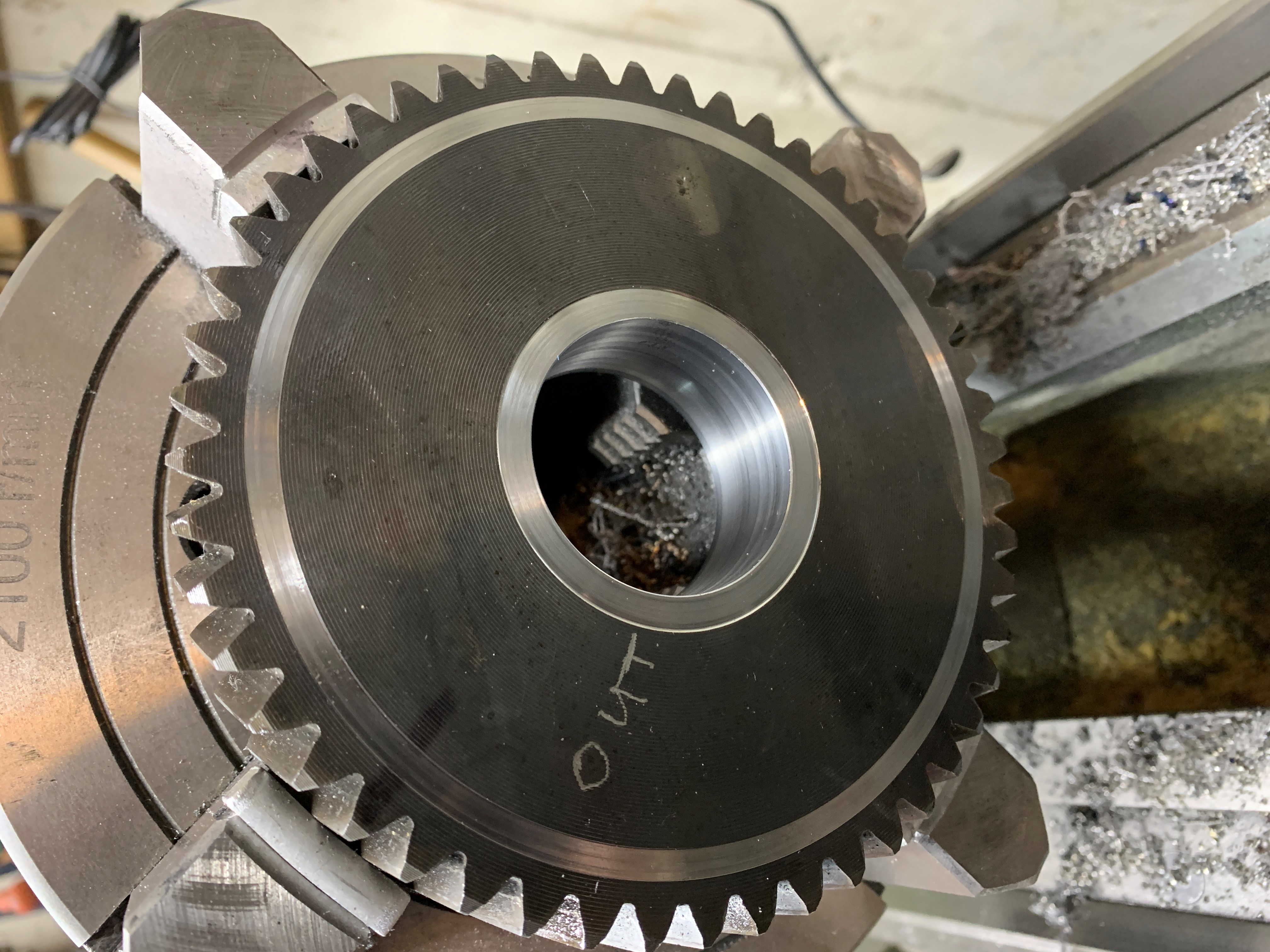

I have the gear bored out to .002" undersize, relative to the shaft. A reference surface was cut so there's a accurate alignment with the shaft flange. I was a bit terrified that I would do something stupid and bore that out too large and then have to make a whole new shaft.
Incidentally, when looking closely at this gear, the mill marks from machining have not even been worn off the teeth, so this machine has not seen a lot of run time. It makes me wonder if there was a defect in the forging operation of this part.

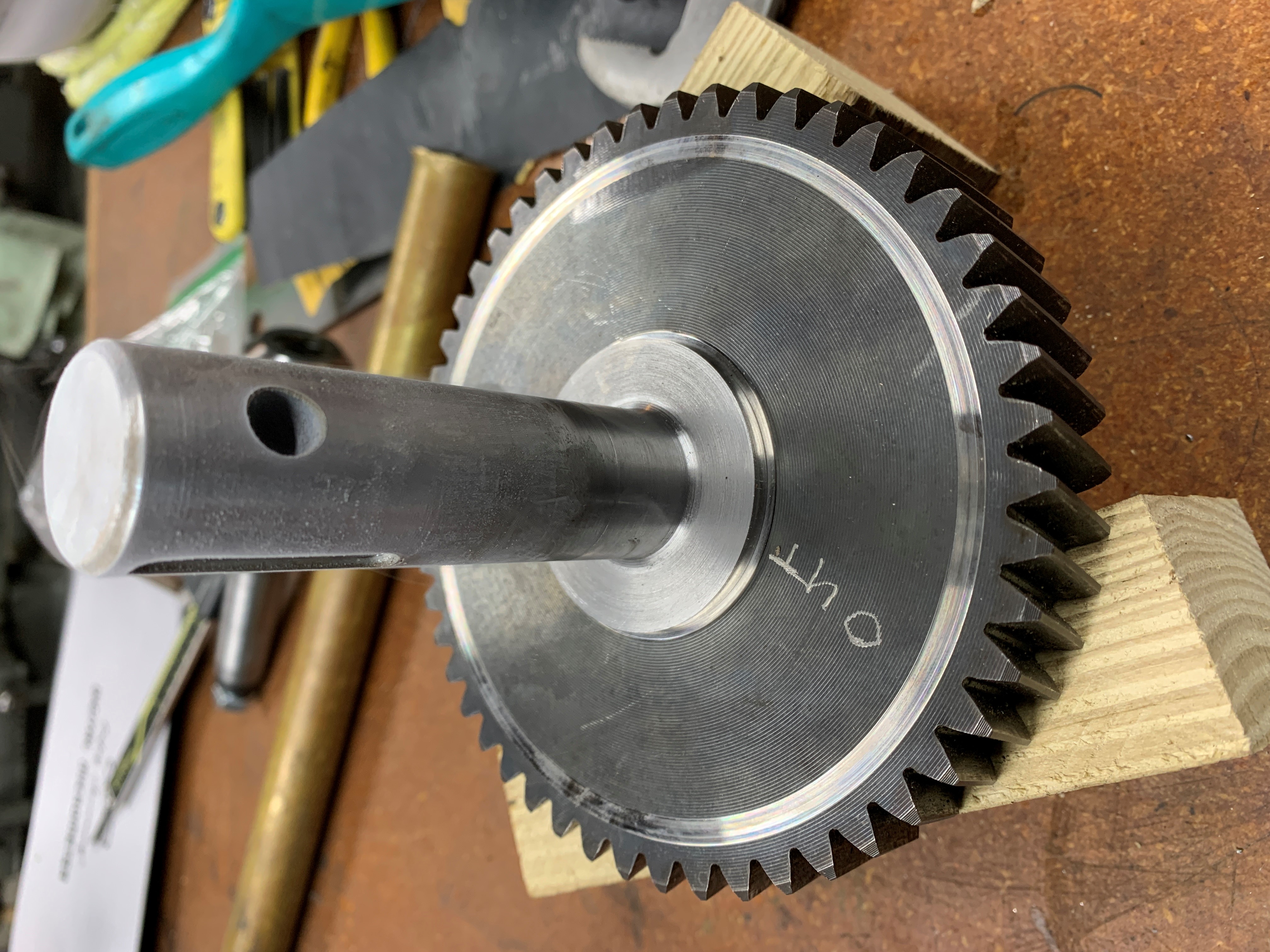

The house was cool enough this morning to fire up the stove nice and hot so I could heat up the gear. (Stupid photo edit tool - I rotated the image and then saved it, but now it comes up back on its side.)
Rejoice! We had a wedding this morning down in the shop. Mr Shaft and Miss Gear were married for life. If you look closely, you can see that the upper part of the shaft is still cold and frosty from the cold.

Next step is to put it back in the lathe and machine the hub a little so I can more easily drill 3 holes into the interface for putting in some bolts. I would love to have a super accurate 6 jaw chuck, but a good one would cost as much as I paid for the lathe. So I use a cheap 4 jaw and spend some time dialing it in.
Questions:
What kind of bolts should I put in there?
I was thinking of leaving a little bit of the taper from the tap at the bottom of the hole, so the bolt tightens up. Is that reasonable?
I have used JB weld in the past to strengthen repaired parts. Would that be reasonable to use for locking in the bolts? Or would red locktite be more appropriate? I recall that a spot weld was initially recommended, just exploring options.
