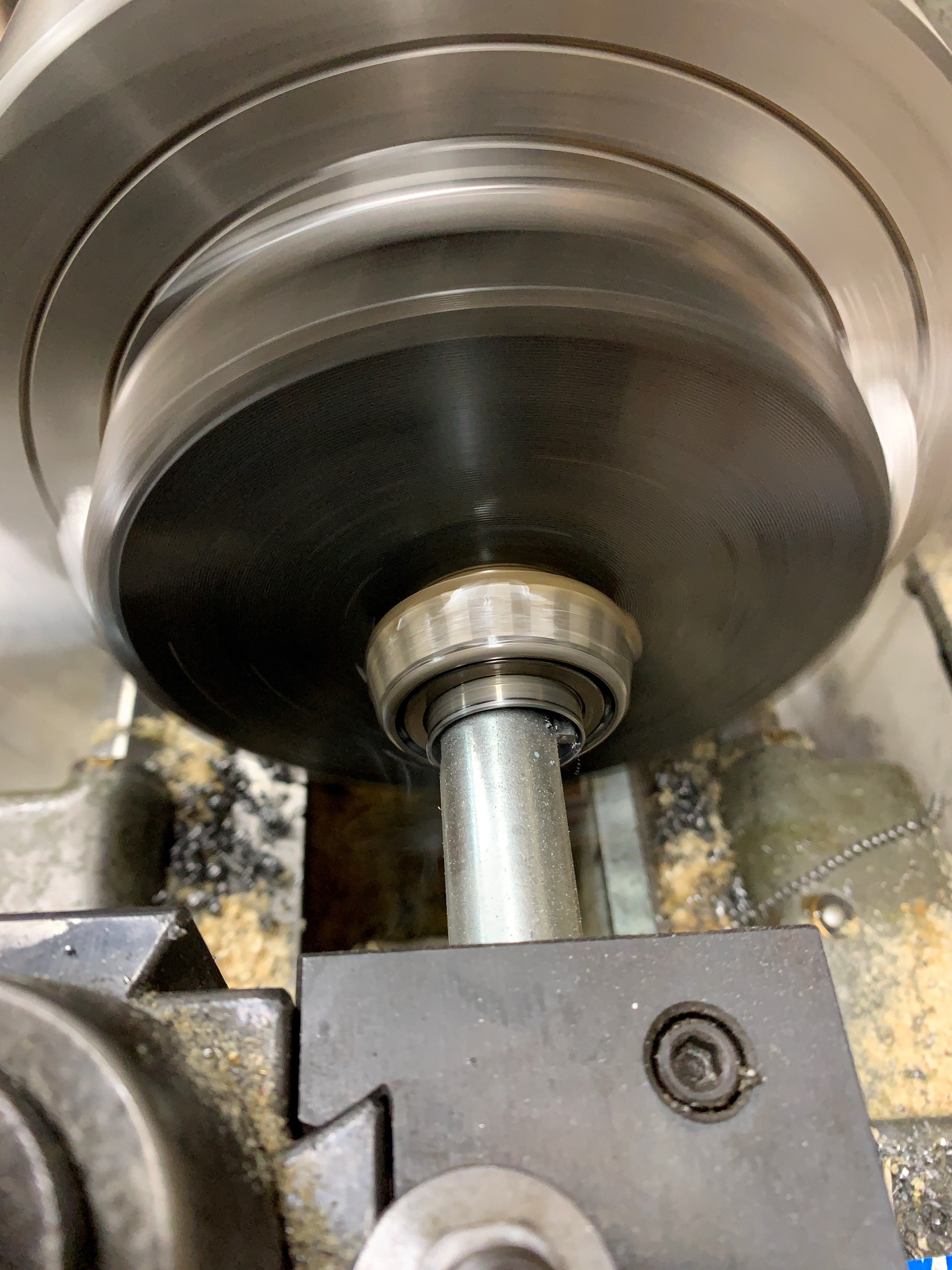

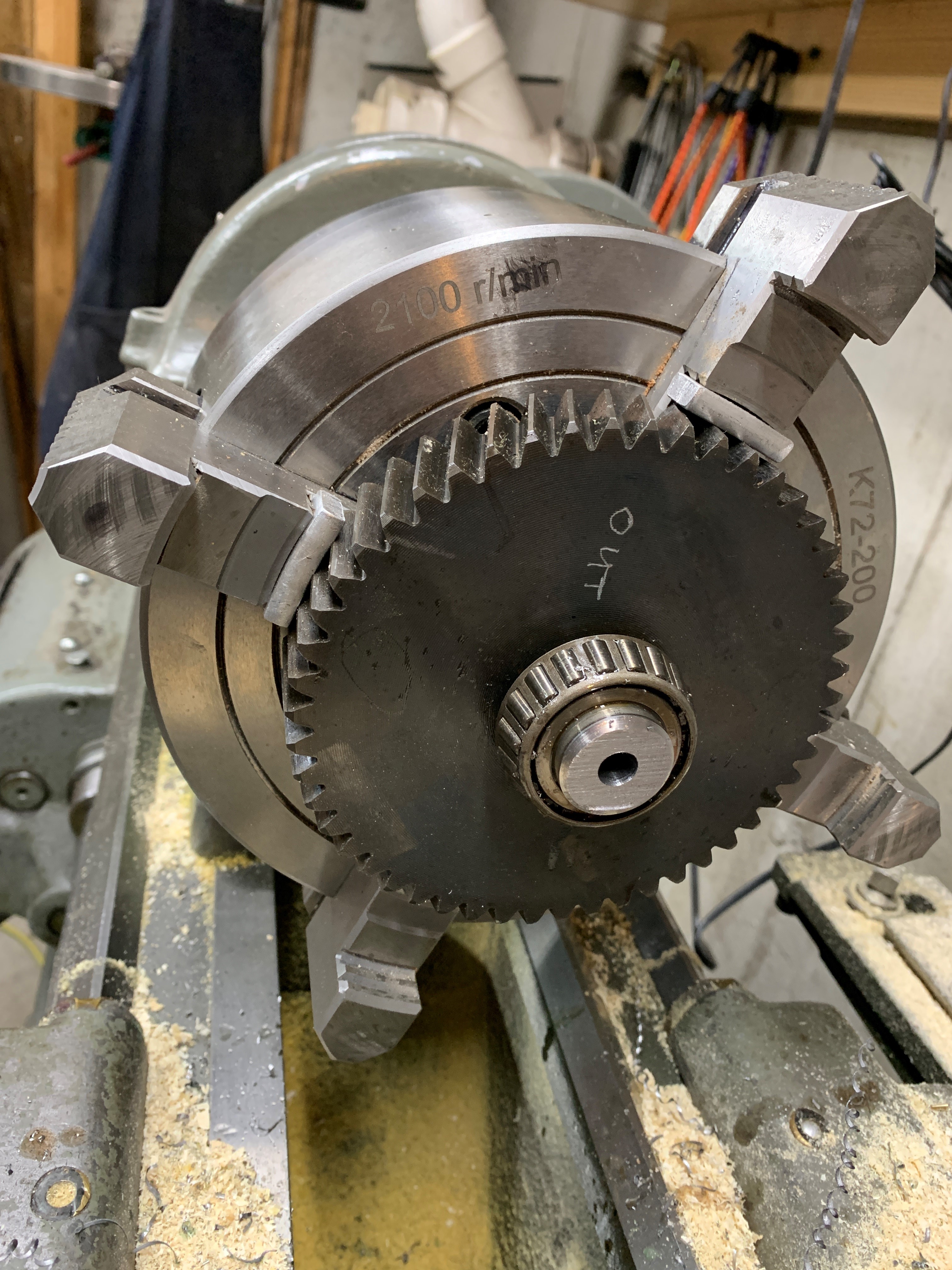

Thanks to everybody for your inputs on this project, especially Jthibodeau. I'm very happy to report some excellent progress on this.

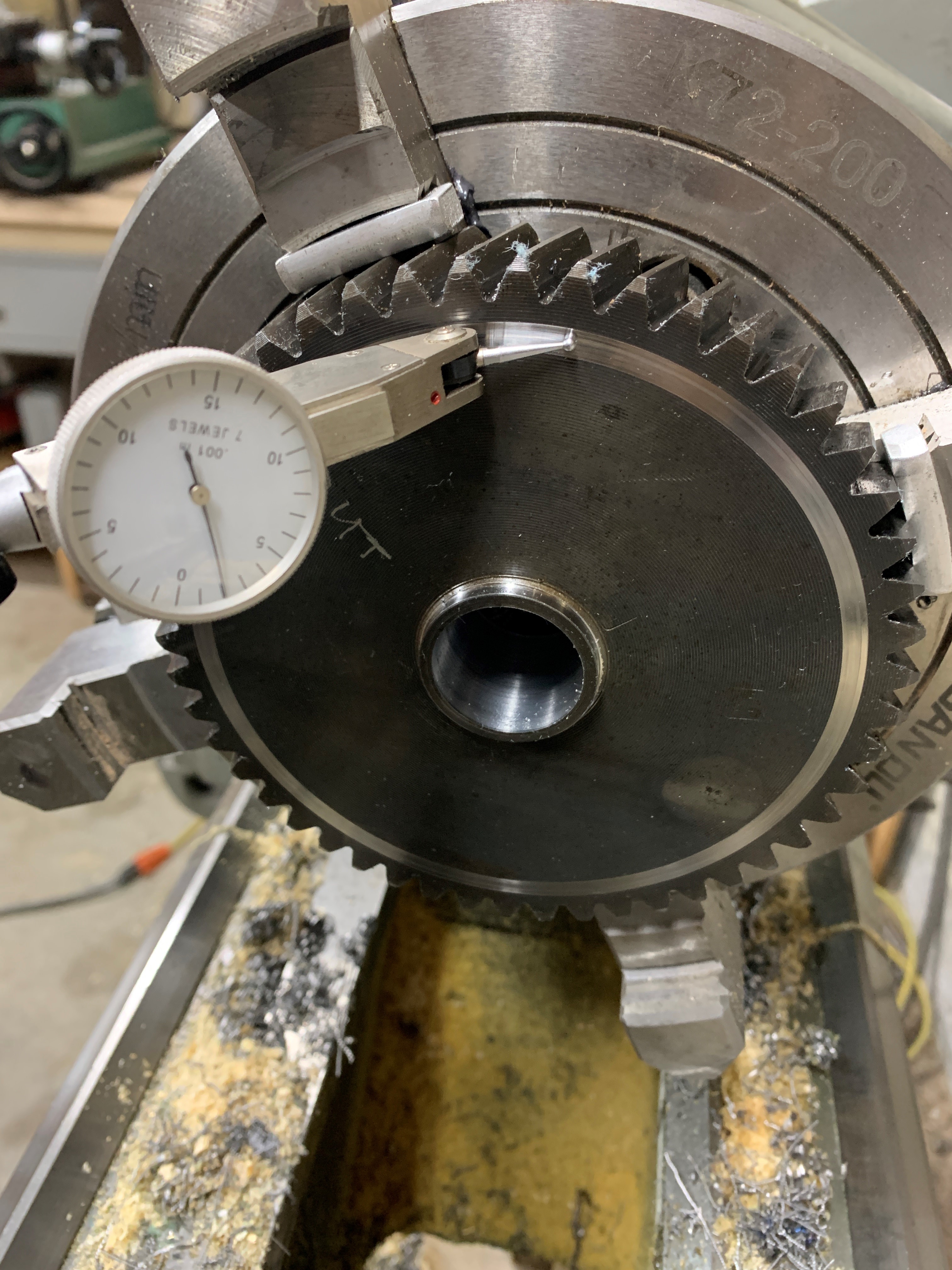

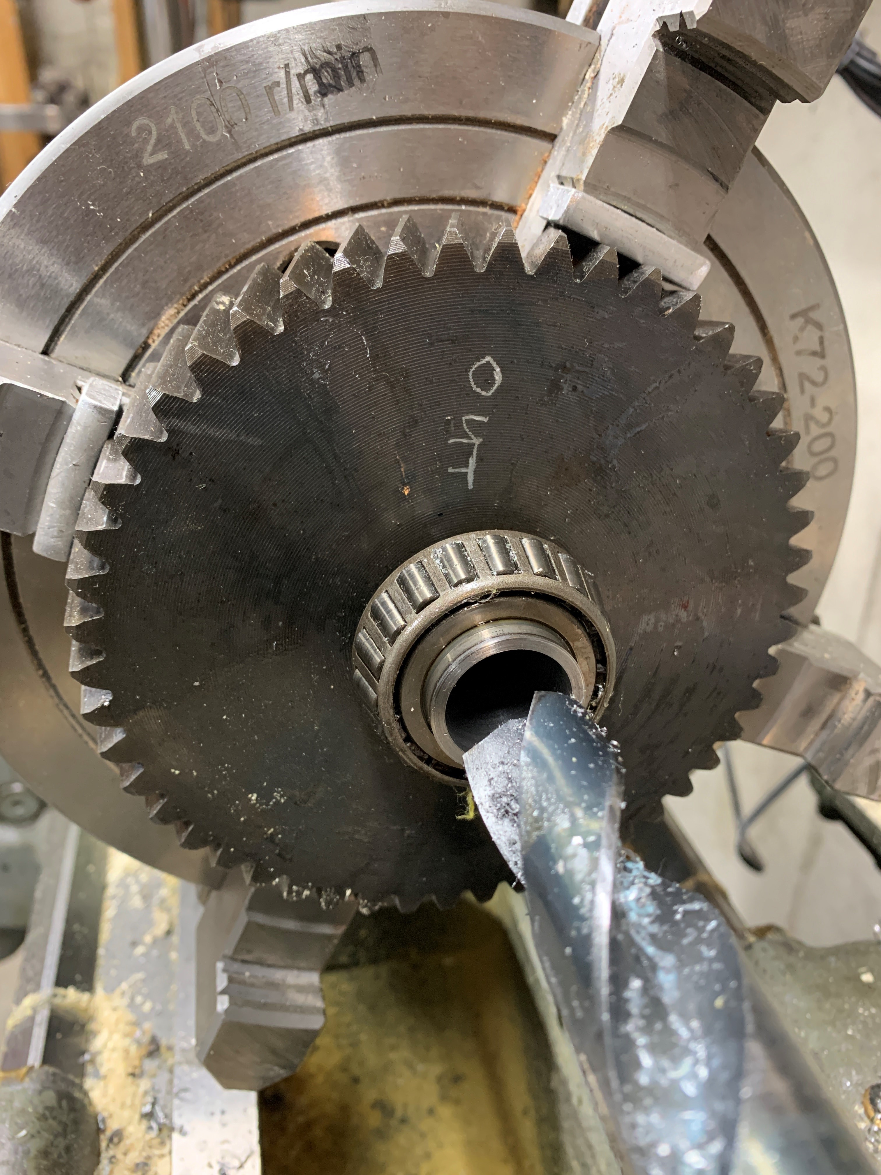

I don't have any huge aluminum pipe that would match this gear, so some aluminum seats were made, one for each chuck jaw. The gear was set in the 4 jaw chuck with an indicator on the shaft surface and also on the side of the gear. It was dialed in to within .0005". I was happy to see that the shaft was hardened only at the surface. Still it wasn't too hard for an HSS cutter or drill bit to get through it. It was tough on the surface but then cut nicely once through that.
Went through a long series of drill bits to bore out the old shaft, taking off about 1/32" with each bit. Lots of oil.
When the shaft was reduced to about .015" remaining, it was time to switch to a carbide boring bar. The squeal from the HSS drill let me know that it was getting into the hard surface.
After a few passes with the boring bar, the bearings dropped off. A couple more passes were taken to clean up the radius that was there in the gear/shaft interface (one-piece forged part!!!!). Now the gear has to come out of the chuck so the spacing of the bearings can be measured. A reference surface was turned on the side of the gear so it can be re-aligned perfectly. The side of the gear was originally machined with a very coarse feed, and those mill marks made it hard to be certain that the gear face was perfectly aligned. At least it can now be returned to the alignment used while boring the center hole.

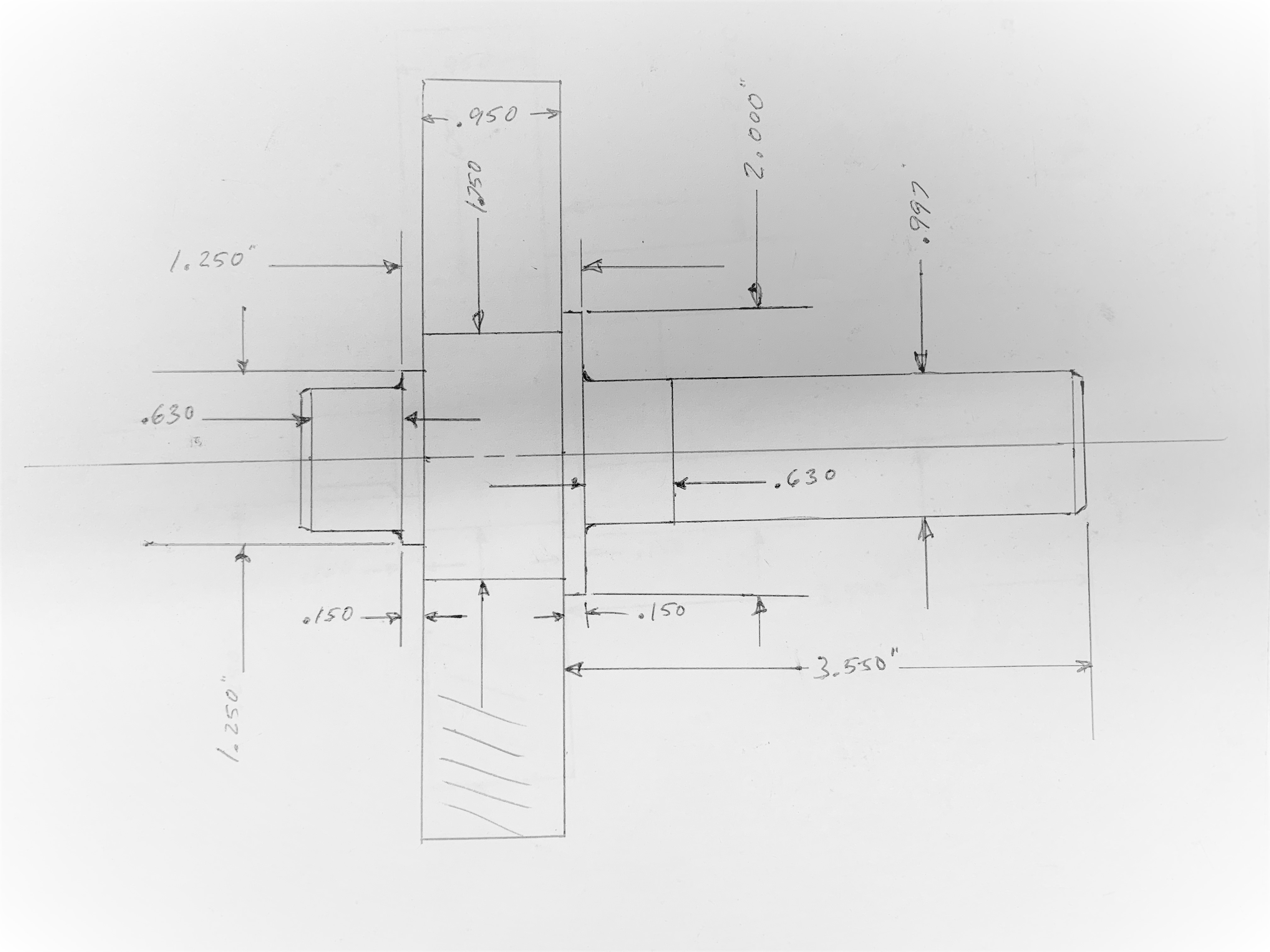

Put together a drawing of this assembly. The bearing is a Timken L44643 with an ID of 1.0000". From what I'm reading on the Timken site, it looks like I would machine the mating shaft surface to 1.0000-.9995. Does that make sense?
The thought of assembling the gear to the shaft, heating the gear and freezing the shaft, is a bit terrifying to me. If everything is done right, then once the temps stabilize, the two parts would be impossible to separate. So that flange is there on the output side of the gear so the gear can be slipped onto the shaft and alignment should be established. Without that flange, how would I establish the alignment quickly before everything locks into place?
   / Repairing sheared impeller shaft - JD 47 snowblower attachment #20
Well you do have a flange in your drawing....
Just get it close and before temperatures equalize just use a brass hammer to make slight adjustments. You'll have enough time before you can't move anything at all. Especially with the size of the gear. I've heated flywheel ring gears and slid them onto the flywheel. If the flywheel is outside in -20 degree weather and the ring gear comes out of the oven @ 250 degrees and goes outside to slide onto the flywheel it still slips on quite easily.
