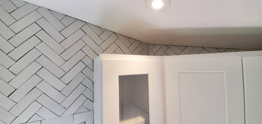

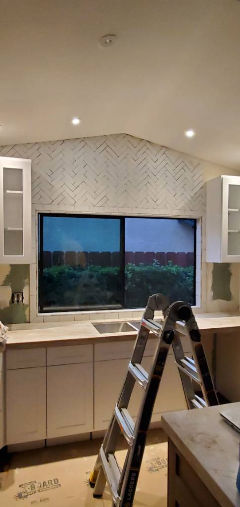

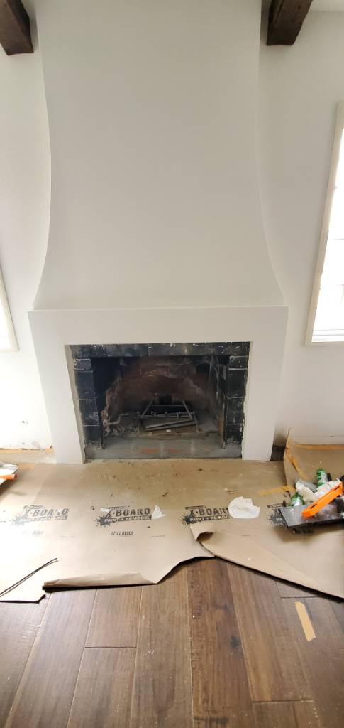

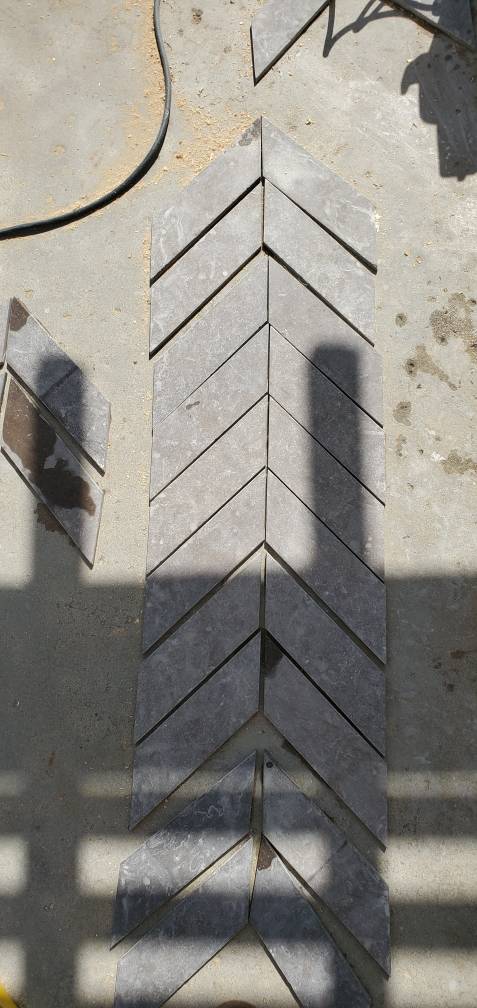

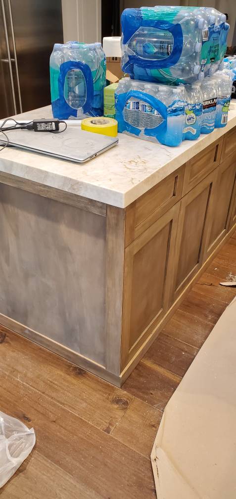

Been busy... did some carpentry and staining of the center island and started on tile on Saturday.
Here we are four days later, 74 man hours so far and I've got half a fireplace and one wall of backsplash done in items of tile.
The fireplace is using a natural stone which I cut into a chevron pattern. So every tile needed two 45s and then many needed other cuts. The back wall angles forward and in so I focused on the center lines and am not losing sleep over the outer edges being off a bit. Just including a before picture for now since it's not connoisseur finished. I decided to do more than originally planned so need to pick up more tile in Los Angeles soon.

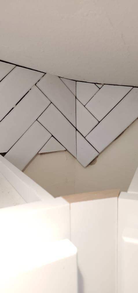

As for the backsplash... this is a beast. 1500+ tiles in a herringbone pattern, counter to ceiling and trimmed around the cabinets, shelves, and range hood. I'm three days in and just today finished the section above the window. It's basically a nightmare scenario in terms of details as almost every single tile needed a cut today, and working above cabinets that are already installed makes measurements difficult. Also on the 45s I met two 22.5 degree corners to continue the tile across the corner. This wasn't actually the worst of it... above the cabinets was the worst of it, especially after I finished one side and while working on the other side realized I had one tile out of place so I had to pull off six tiles and cut new ones.
