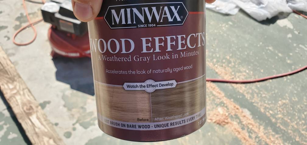

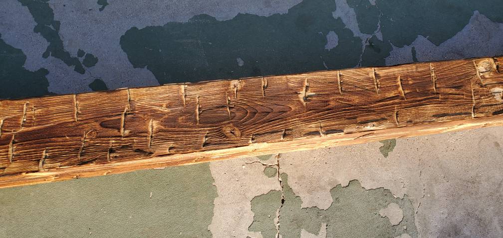

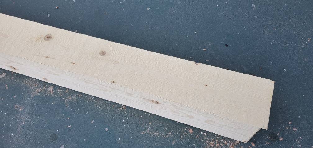

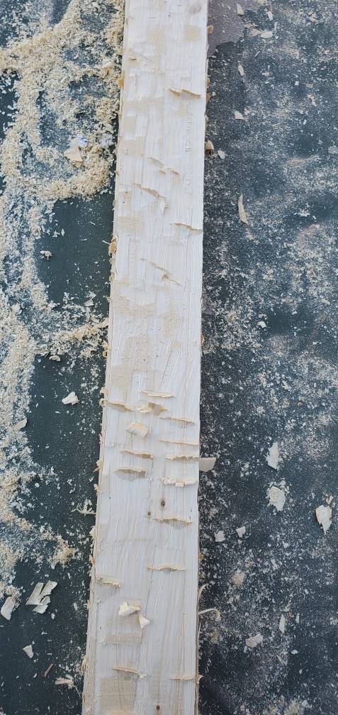

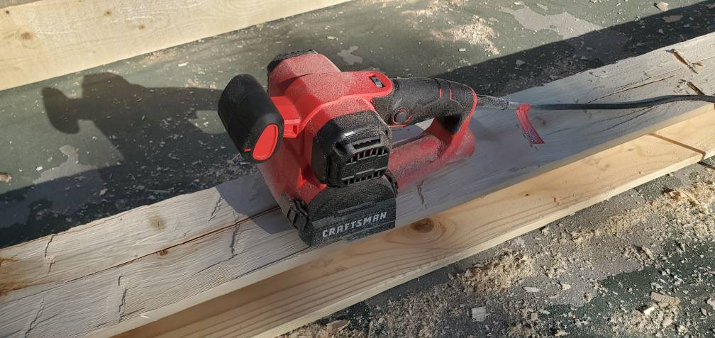

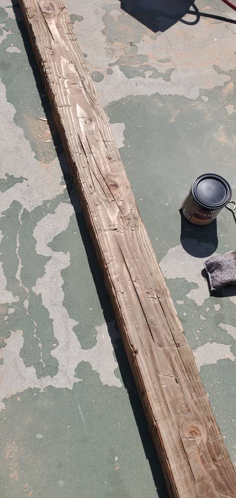

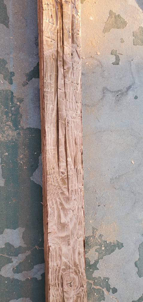

Happy with the results so far. This is with just the wood effect aging product. I'll stain after this. 20200925_175736.jpeg20200926_133115.jpeg20200926_133054.jpeg20200926_133130.jpeg20200926_133107.jpeg

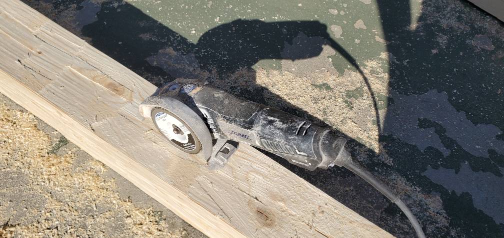

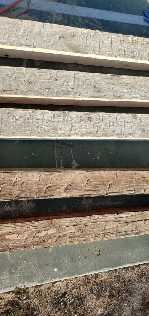

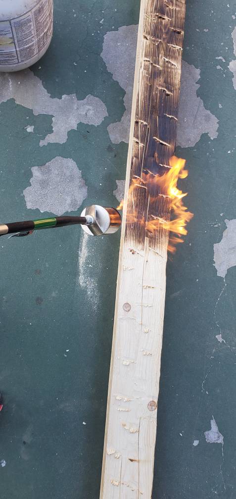

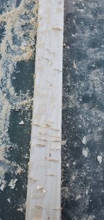

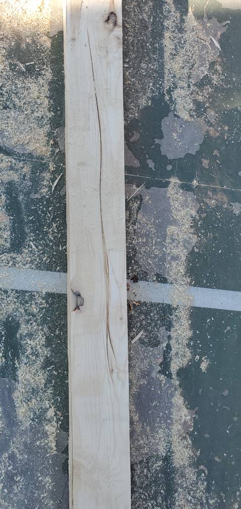

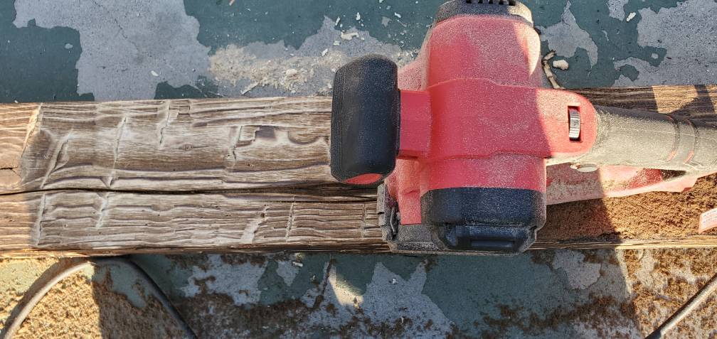

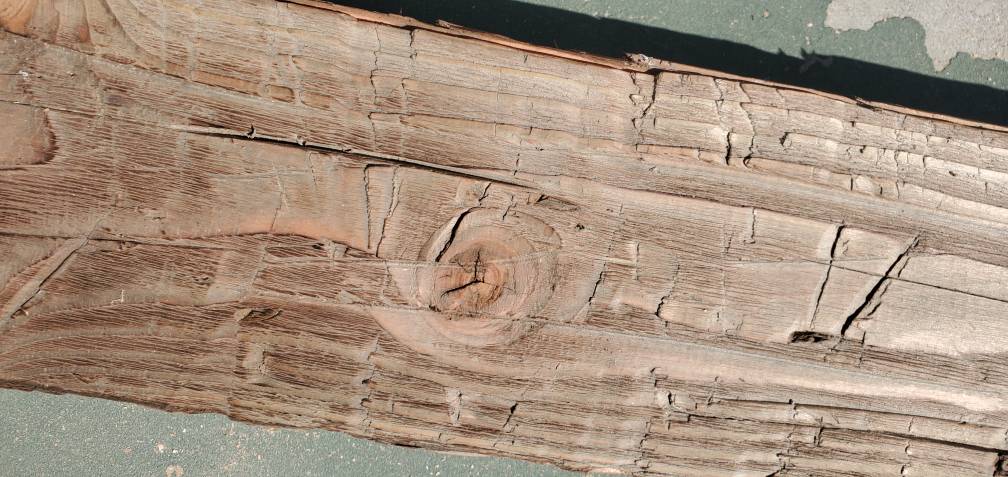

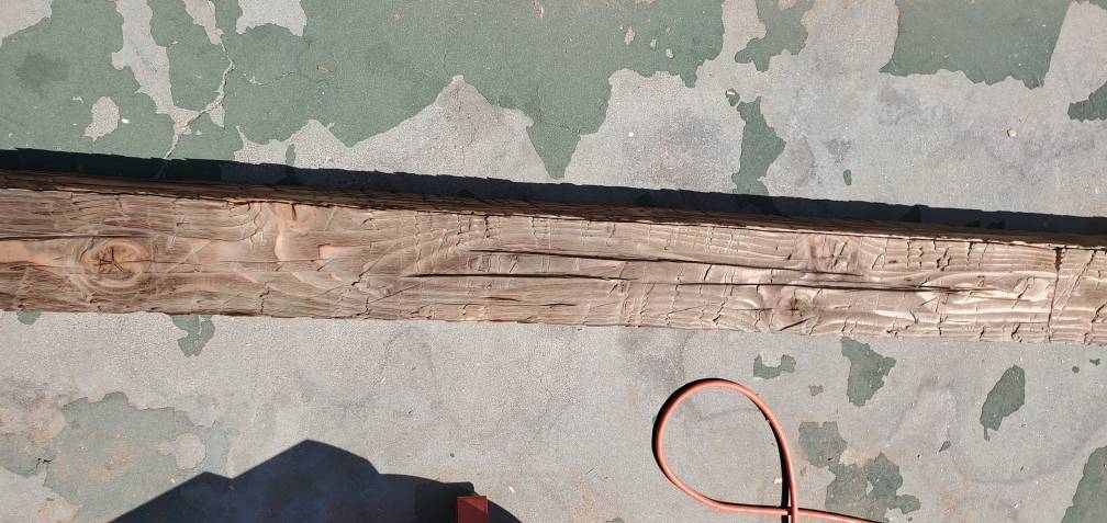

These photos show the process step by step from plain wood through coating with the minwax wood effects. Let it dry overnight and then the final step is staining and polyurethane. 20200926_155411.jpeg20200926_155406.jpeg20200926_160809.jpeg20200926_160815.jpeg20200926_161611.jpeg20200926_162119.jpeg20200926_162647.jpeg20200926_162638.jpeg20200926_165106.jpeg20200926_165526.jpeg20200926_165657.jpeg20200926_171405.jpeg

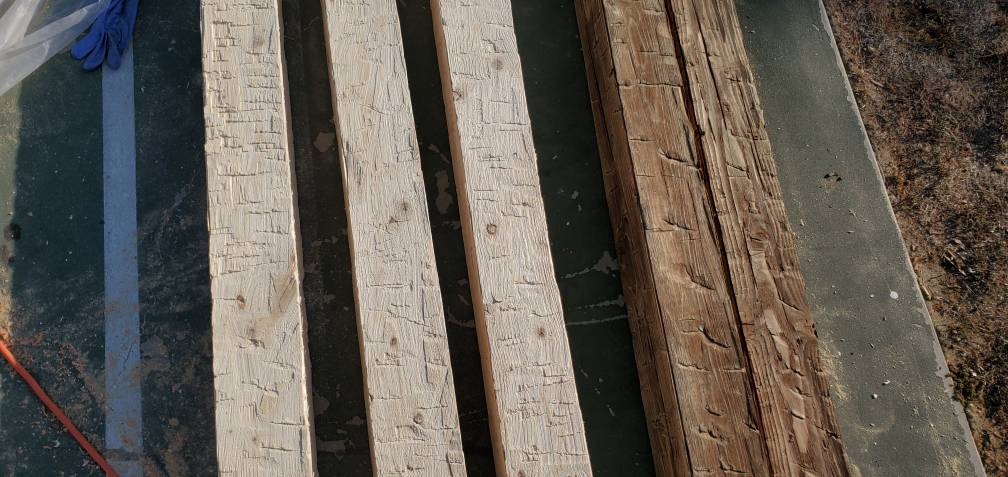

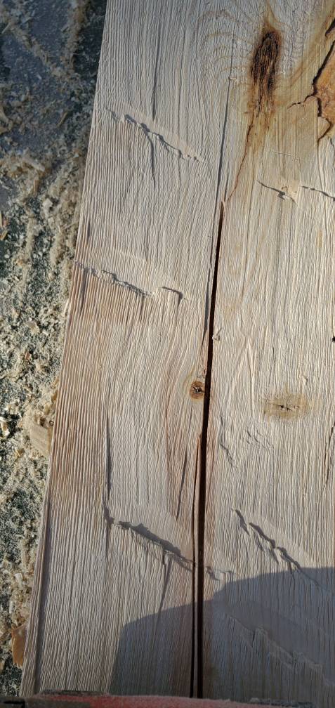

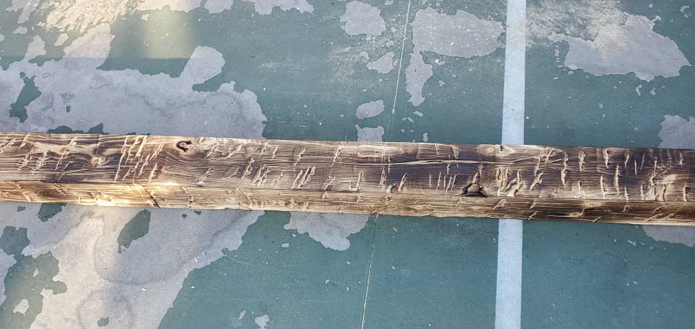

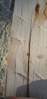

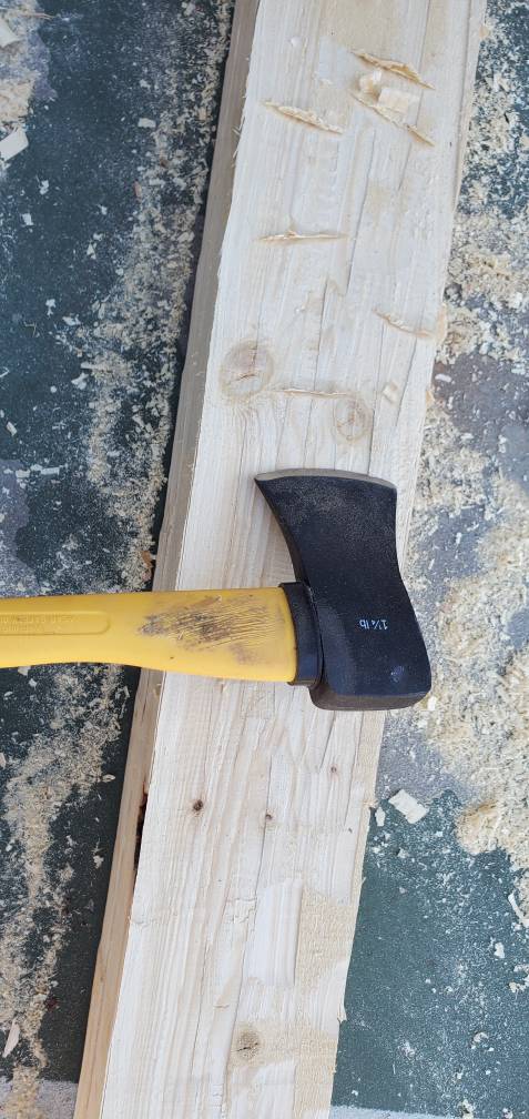

This is a good side-by-side of the beams prepped with planing, crack cutting, hatchet chopping, and wire brushing, and in the right is after torching and the aging formula.
I picked up a $15 HVLP paint sprayer from HF and it made the minwax stage to much faster. With the wood being so rough, the sprayer is the way to go. It also stretched the formula 50% further as a quart lasted three beams with the sprayer versus two beams with a brush.

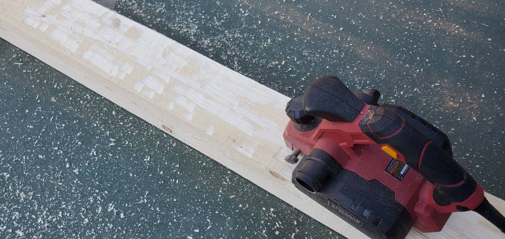

Did I already mention that destroying your planer blade by running it over some screw heads makes the planing texture look a lot more authentic? Well that's a tip if you don't mind ruining a blade for this type of thing.
Other tips... the $99 craftsman drum sander with wire brush is barely adequate for this project. Makita makes one that is about $450 but nobody local had one in stock. Normally I'd rent something like that for this project. I also started researching tabletop wire brush drum sanders and they are quite expensive. But that would make the wire brush stage a lot easier.
The worst part is probably the hatchet step. It's just tedious and like today, three 20' beams with three sides each = 180 linear feet of chopping an acreage of 20 cuts per foot = 3600 hatchet swings. That's 3600 swings to think about a better way to do this.
It took me four hours of solid work to treat three 20' beams today. It's exhausting work and a good portion was done while kneeling on the ground... even with knee pads, not fun. Oh and the amount of dust this produces is staggering. My sinuses are getting irritated even with the use of a carbon mask. I figure in inhaling the dust while taking breaks. But I'm more than half way done now. 20200927_165221.jpeg20200927_165228.jpeg
