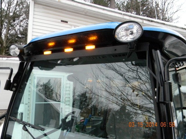

Sorry, no photos but when I raised my roof I only lifted it high enough for the support rod to hold it. Was less than a 45 degree angle which still gave plenty of room to access anything in there. I think the front of the roof was up maybe 2' so pretty sure 10'6" will be high enough. If I recall I had to remove the front cab lights. I made a new bracket across the front of the cab to mount them to.

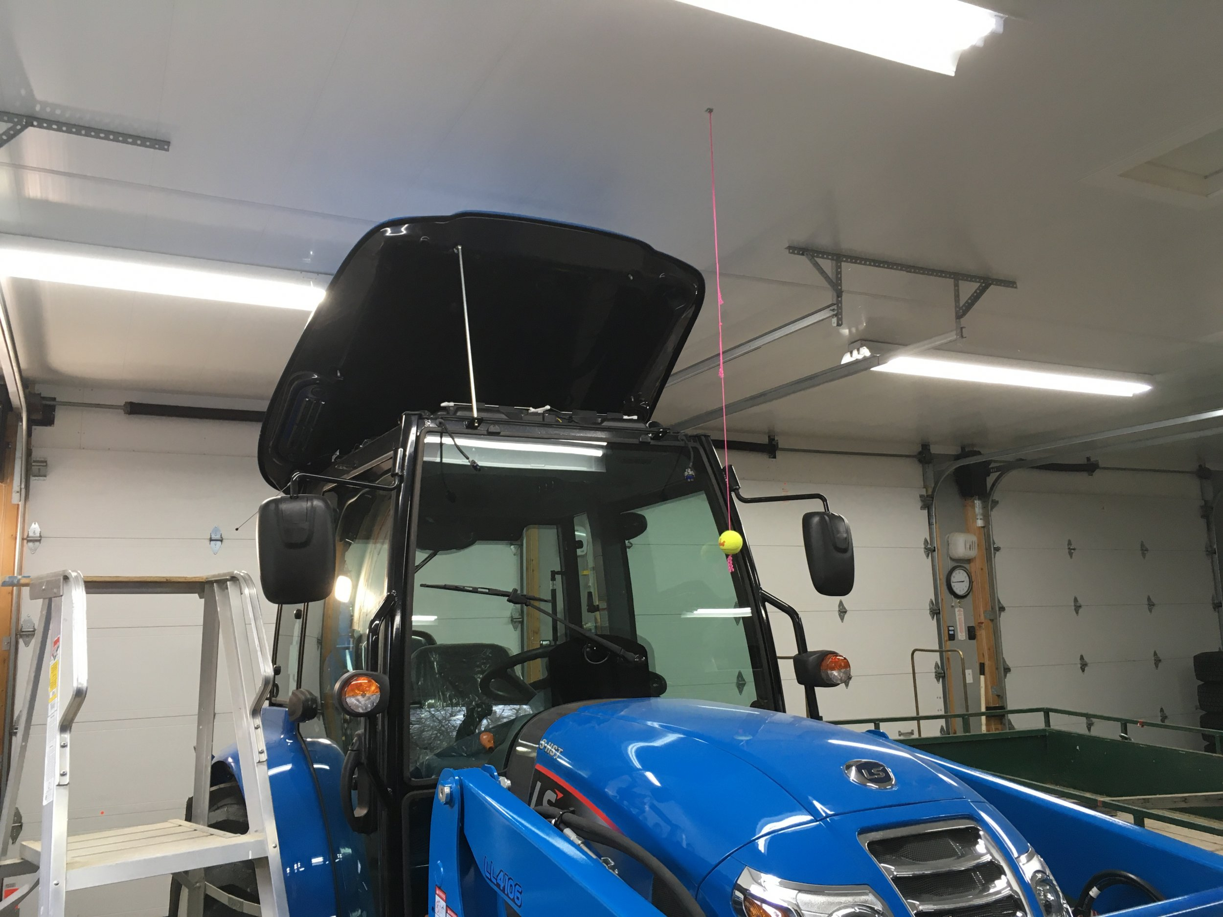

I lifted my LS MT342HC roof today and it was quite easy. Thanks to George and Avenger for suggesting this.
Attached is a photo of it raised. A few things to note: (1) the bolts you remove are those under the edge of the roof not on top (2) the front work lights will have to be removed and (3) don't cut the zip ties holding the support bar inside the roof. They have release tabs on them so they can be re-used (see 2nd photo).
