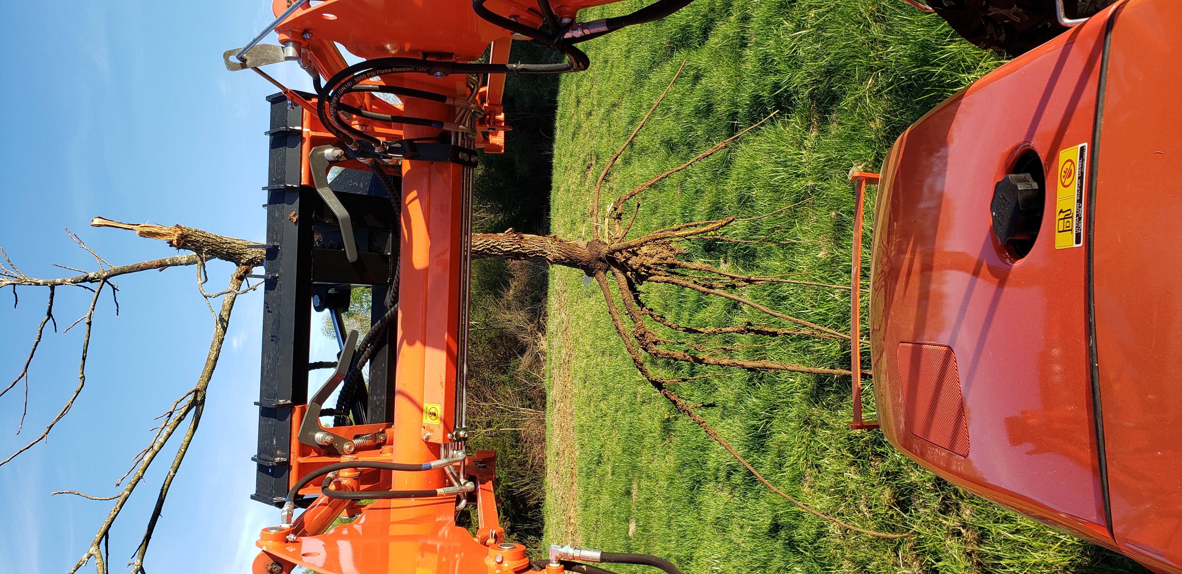

I should have DDS after my name after pulling this little walnut! I tried a couple of weeks ago and gave up. We got a good rain so I thought I'd try again. It still took some back and forth but finally! View attachment 601361
Wish I had a few of those.....
Looks like you used a tree puller....what kind do you have?
