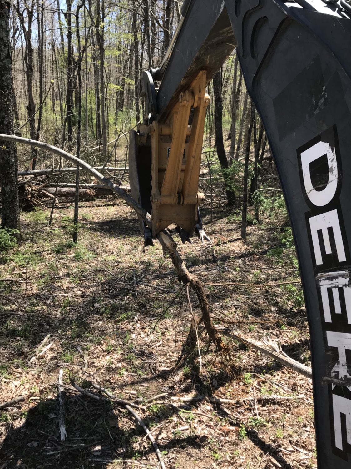

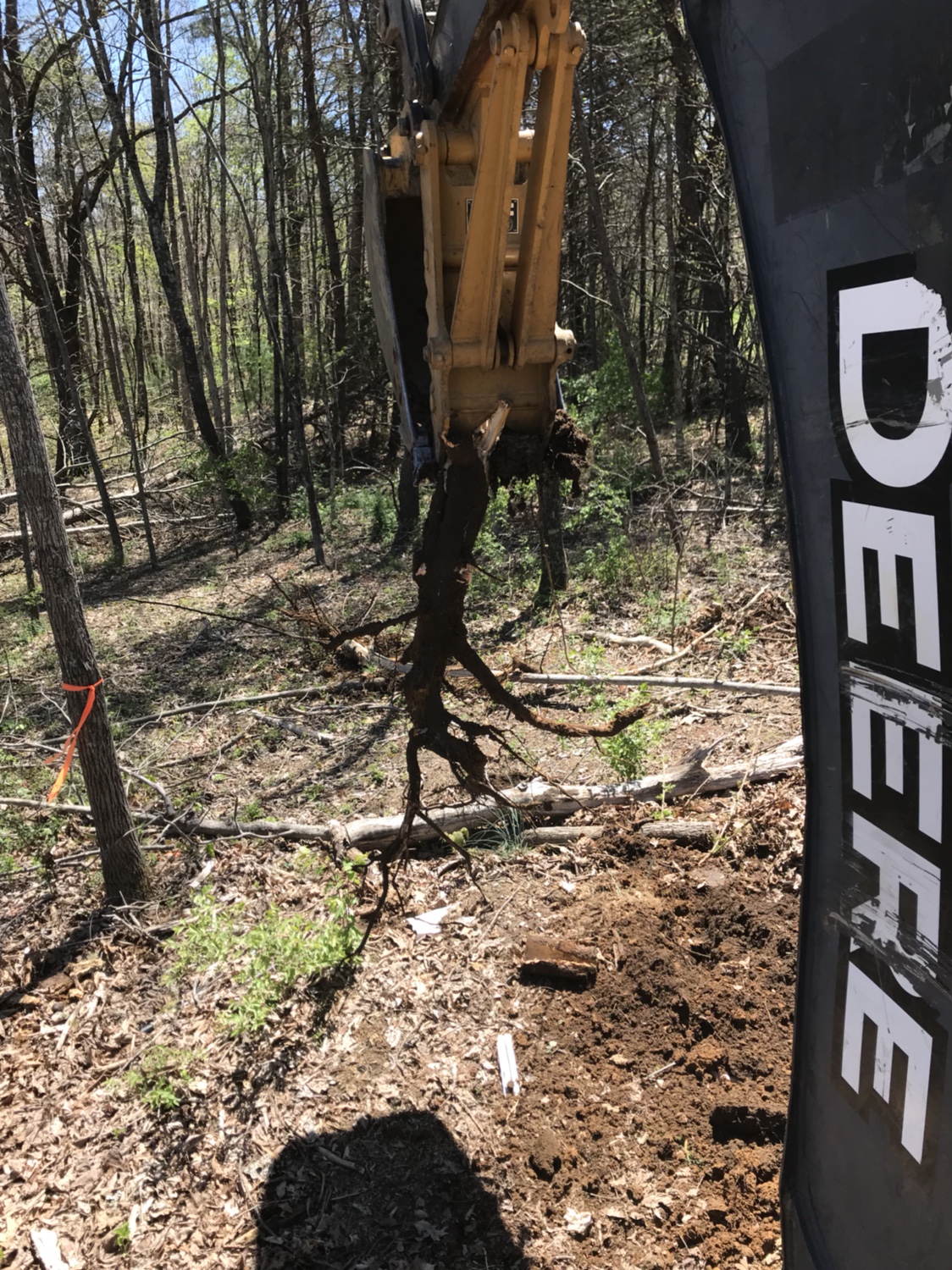

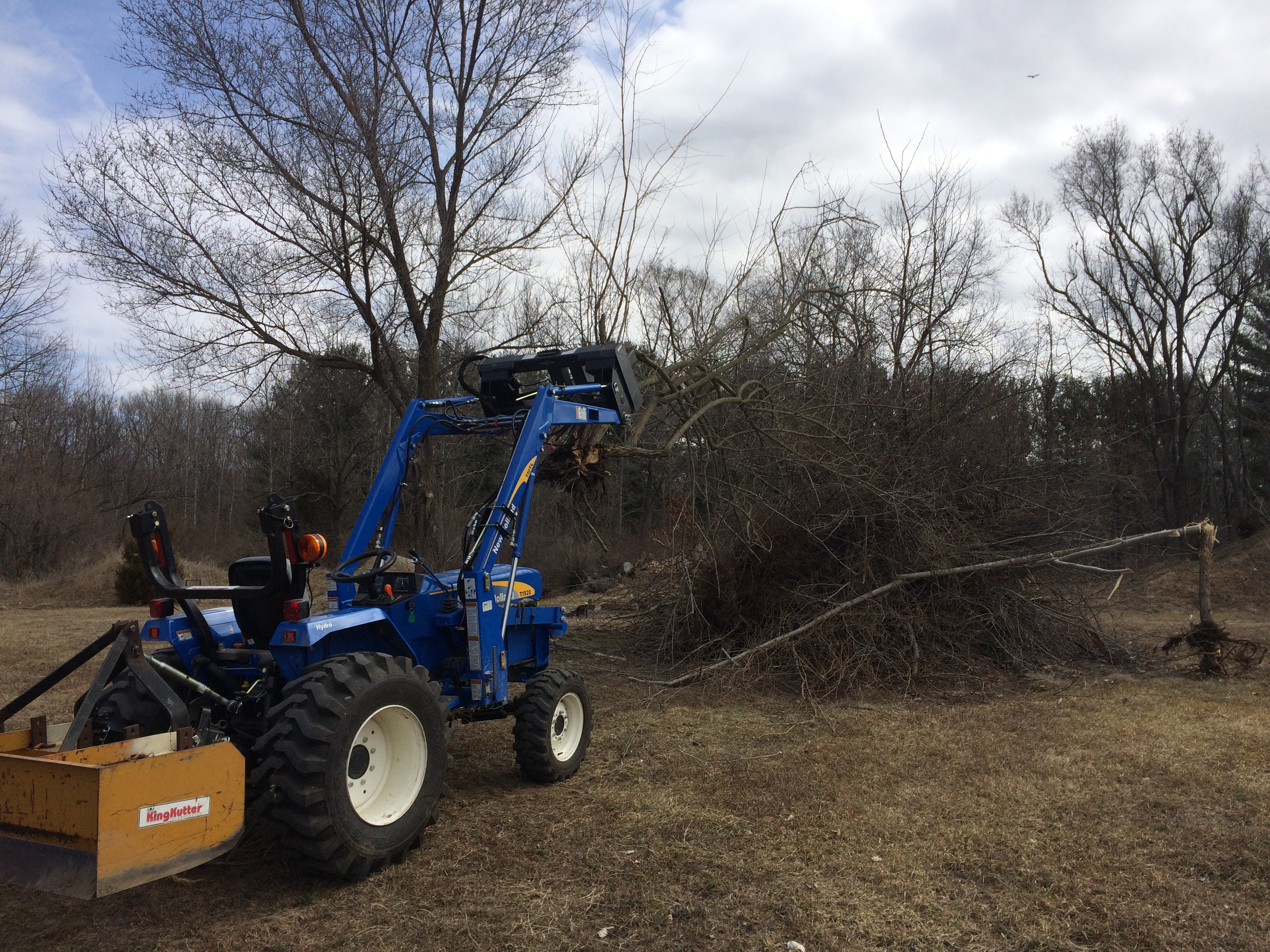

I used brush grubber for years, but going was always slow even with a helper/driver while I rigged. My T1520 came with SSQA, and MIE added added front remotes for my Hound Dog 48" grapple (side clearance and weight advantage) 3-4 trees/hr wasn't cutting it, and getting on and off the tractor would be easier with sound knees.
I'm done climbing out of the seat for saplings so small they slip throught BG's teeth, or too wide to get a good purchase on a >2 1/2" trunk or stump.
I can pull and pile all sizes w/o leaving the seat, and have been yanking willow and autumn olive with fury. I can pull & pile more trees/brush in an hour (w/o leaving the seat) than what used to take a long afternoon. I make a half dozen piles, then switch to the other grapple. Last week I pulled these on one afternoon and piled them the next.
There's a trunk dangling from a tree in the pics where it snapped about waist-high while trying too work it loose. Loader lift capacity by itself is rarely enough with tangle-rooted or well anchored trees/shrubs. Method is to grab on, tip the grapple forward, and push to loosen the near roots. Then roll it back and pull back. Going forward a second time usually gets 'em loose. This works well despite my NH's FEL 800lb gross lift capacity. 25' tall and w/3 1/2" trunk not a prob in my sandy soil, and now I only leave the seat to switch grapples every few days.

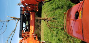

I should have DDS after my name after pulling this little walnut! I tried a couple of weeks ago and gave up. We got a good rain so I thought I'd try again. It still took some back and forth but finally! 20190421_191005.jpg
   / Removing saplings up to 2" in diameter #50
I don't know why the picture turned itself. It wasn't taken that way.
