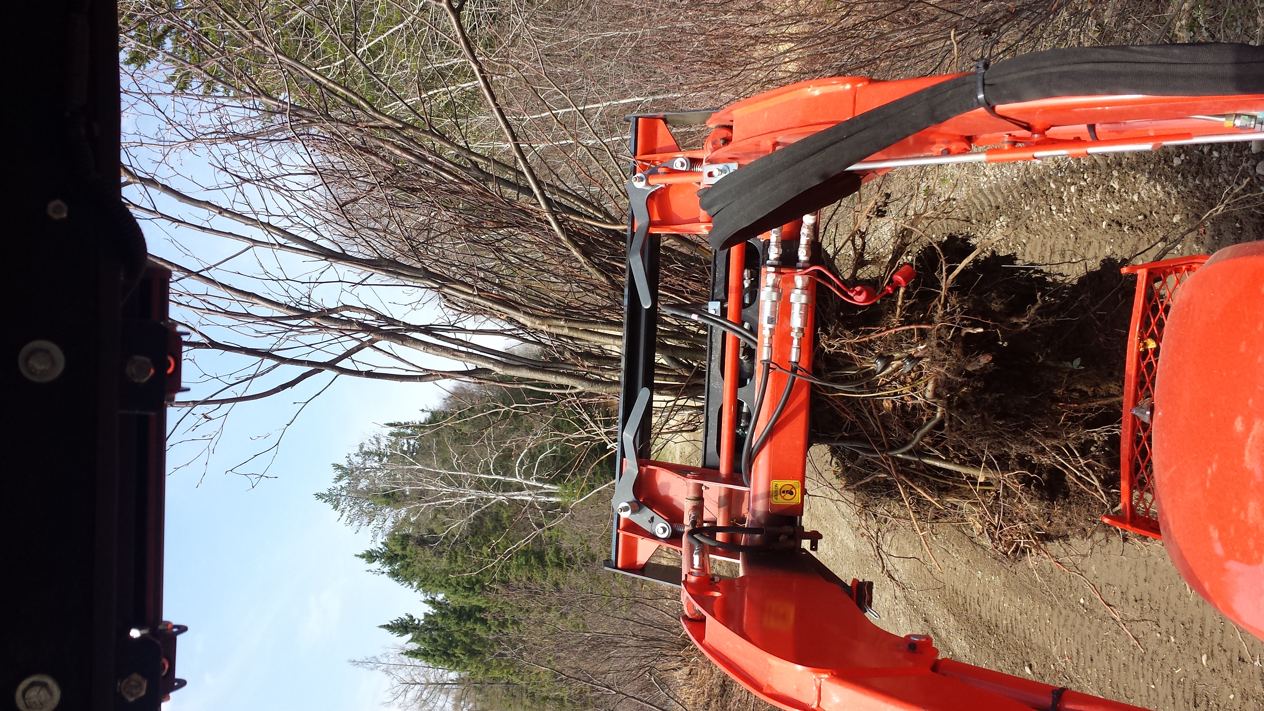

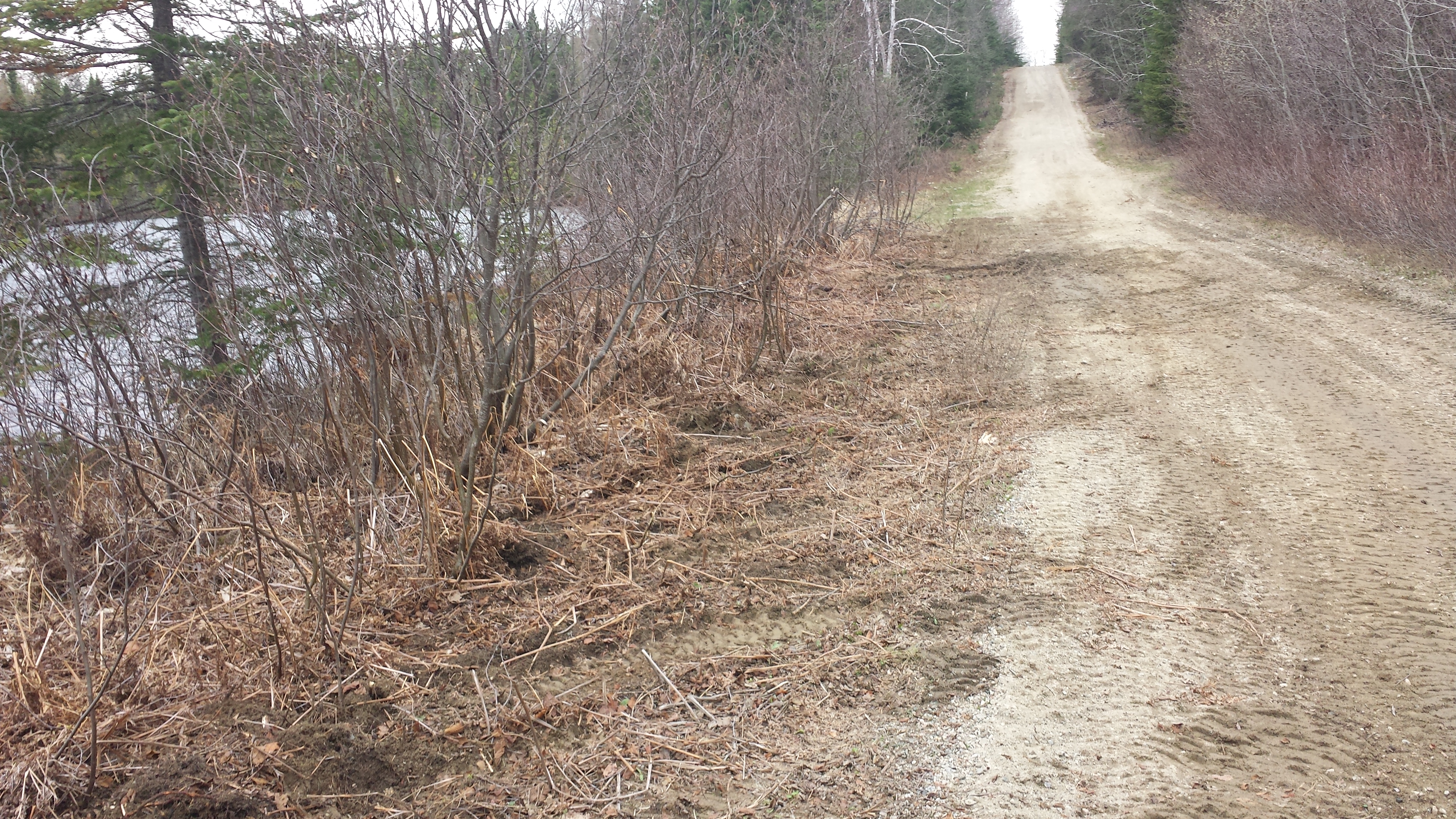

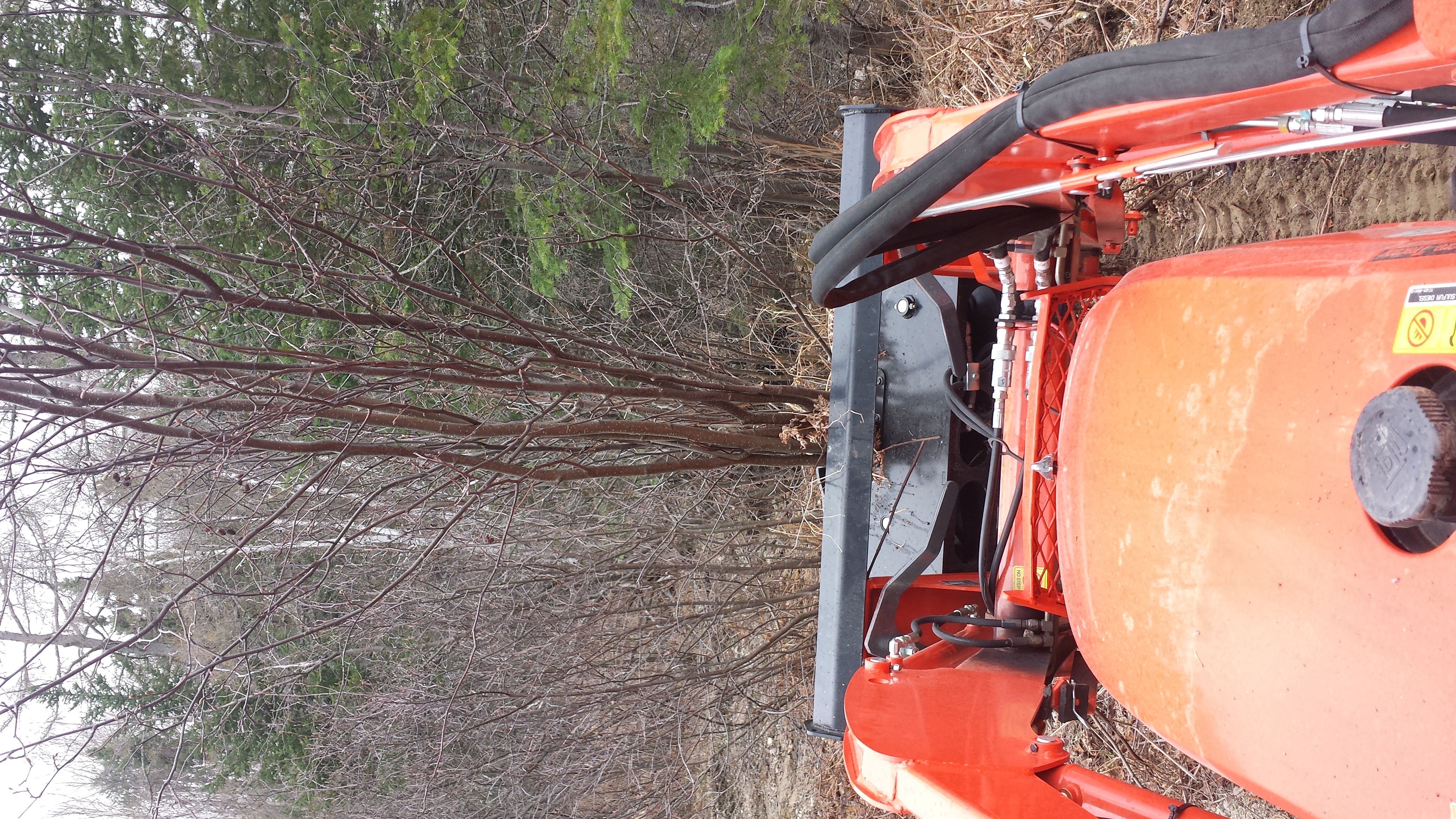

I've been dissed a bit in the past for mentioning this but I have a J. Dunn grapple that I bought for exactly this purpose. I use it for pulling alders and evergreen trees up to 3" in dia from the sides of my camp road. Cutting them off with my rotary cutter leaves "spikes". I can pull multiple trees if they are close enough together. I pile them up and then grab the pile with the grapple and move it to a dumping spot. I cleared about 100 yards of roadway in about an hour. I then go over the disturbed ground with my landscape rake to level it. My plan is to use my rotary cutter to keep the road trimmed once all the problem trees are gone. The ground is gravel, sand or a combination of both.
View attachment 600547View attachment 600544View attachment 600546View attachment 600548
That is a heck of a concept. Seems about perfect for what I need to do.

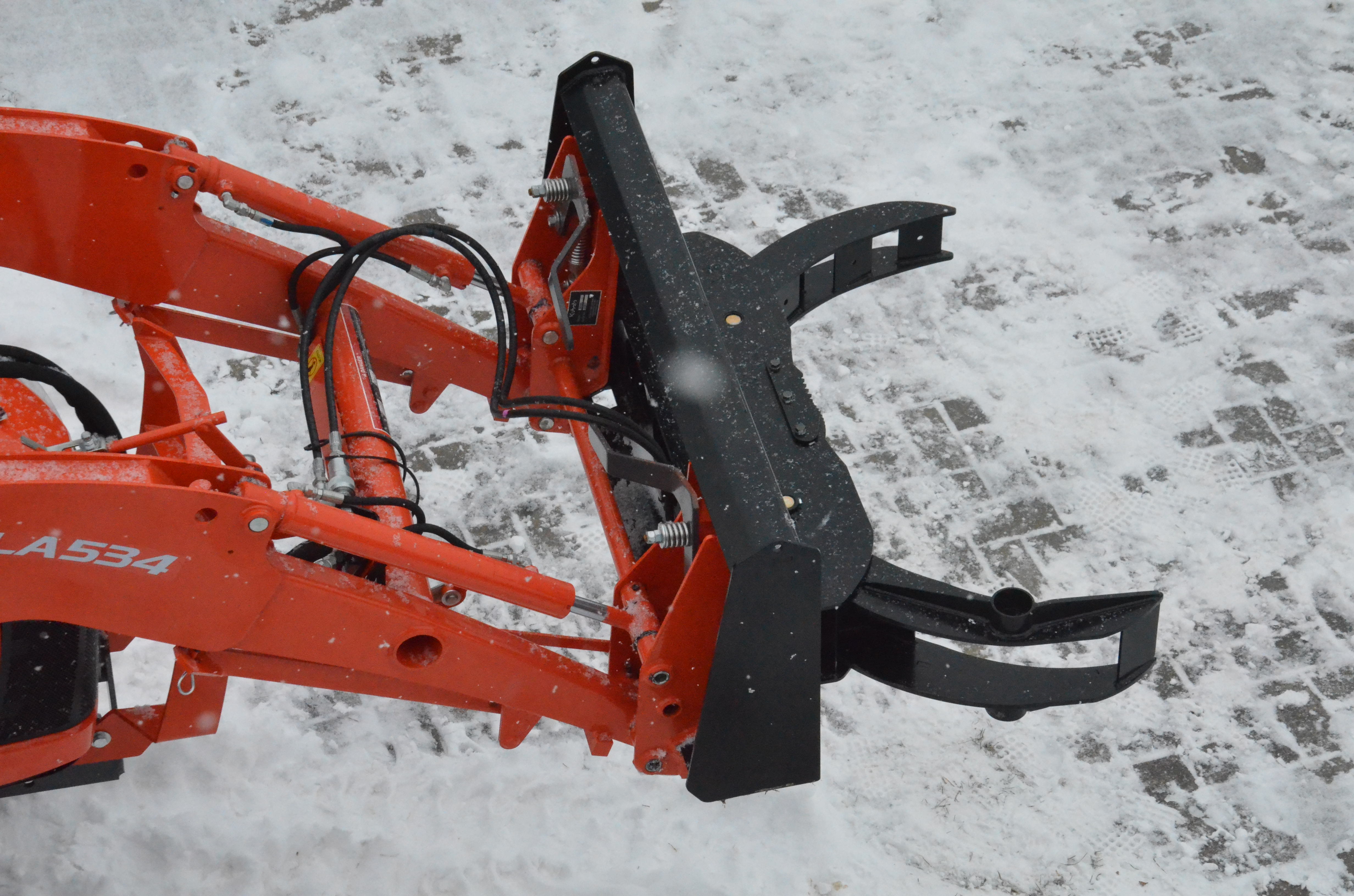

I originally saw this grapple when it was featured by a TBN user JOHNTHOMAS.
https://www.tractorbynet.com/forums...ot-small-tree-remover-grapple.html?highlight=
Because my situation was a bit unique, all of the other grapple and tree pulling options didn't solve my problem. I had tried clearing my camp lot with ATVs and a brush grubber. Took forever to clear a small spot. I bought a BX25 and I worked it hard to clear the driveway around my camp and to clear a couple of spots for a storage barn and parking. I tried clearing the sides of the road with my BX and a tooth bar but it took a long time and it left a mess of the roadside. I didn't want to leave it for like that for the other road users to look at. When I ordered my B2650 I saw the post above and contacted Jery via email.
I had lots of conversations with Jery and decided to order the grapple. I was a little scared of the price - at the time it was $1800 US. But I had a specific use in mind and it was my best option. I've had several knee surgeries over the years and a total knee replacement last year. Getting on and off the tractor frequently is out of the question. When the grapple was done, I drove to Jery's place in WI to pick it up. My wife and I made a weekend trip out of it. When I picked up the grapple Jery was very frank about it's limitations. He made me aware that JOHNTHOMAS had bent his grapple. My B2650 has a lot less power than John's so I felt safer. Even if I had a bigger tractor, I was made aware of how much force to use safely. Jery also made a couple of improvements to his design.
I also thought about what to do with it after clearing my road but other jobs keep popping up. Like clearing some trails on our deer hunting lot on Manitoulin Island. It's rocky ground with hundreds of small balsams popping up everywhere. A rotary cutter just won't work there. I also use it to move my propane tanks and barrels around. Some of my neighbours have asked me to help them out with some things too.
In the end, this grapple is not for everyone, and it is expensive. I am really happy with the way it works for me.
