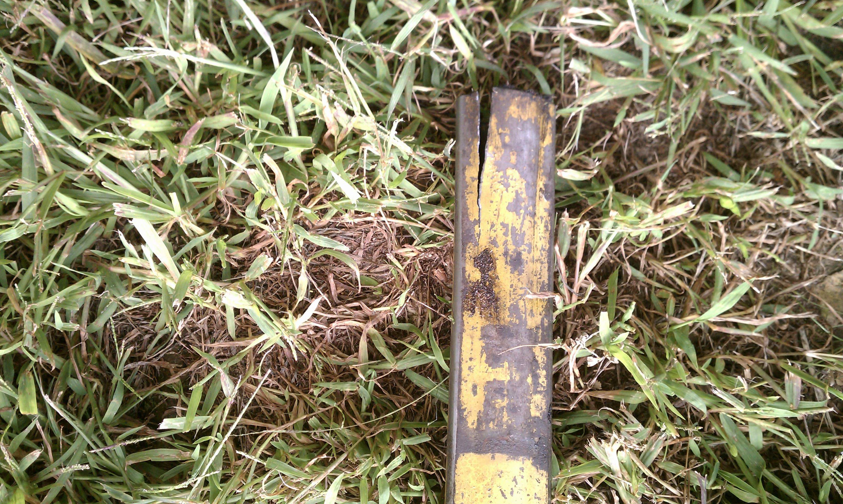

Total rookie tractor owner here. Just bought the tractor and a 5' Caroni finish mower. While testing it out in the field, the PTO shaft sheared. I can not figure out how to remove it from the mower gear box. Anyone have ideas?

The shaft is actually split with a crack running about an inch up the shaft was well.

So, let me correct what the issue is. The tractor side of the PTO shaft cracked and split allowing the two pieces to separate. PTO shaft.jpg
I have removed the bolt that is under the plastic cover near the gear box, but still can't get the mower side to let loose.

So, let me correct what the issue is. The tractor side of the PTO shaft cracked and split allowing the two pieces to separate.View attachment 337479

Please don't forget that when you get your new shaft, you will likely have to "size" it for your tractor. I believe the reason your original shaft faild was do to insufficient overlap of the two halves of the shaft. But if you leave the shaft too long your PTO stub on the tractor and its seals and bearing can be damaged. As you lift and lower the shaft, the shaft extends and contracts at some point in that arc your shaft will be as fully collapsed as it is going to be. You still want some room in the "telescoping" of the two shaft halves so as to not "hit"the stop and cause it to be jammed into your PTO stub. Conversely you don't want it to be too far extended. or the overlap will not be enough to be mechanically sound. it can cause the shaft materiel to "split" as there is too much torque on too small of an area. Good luck
