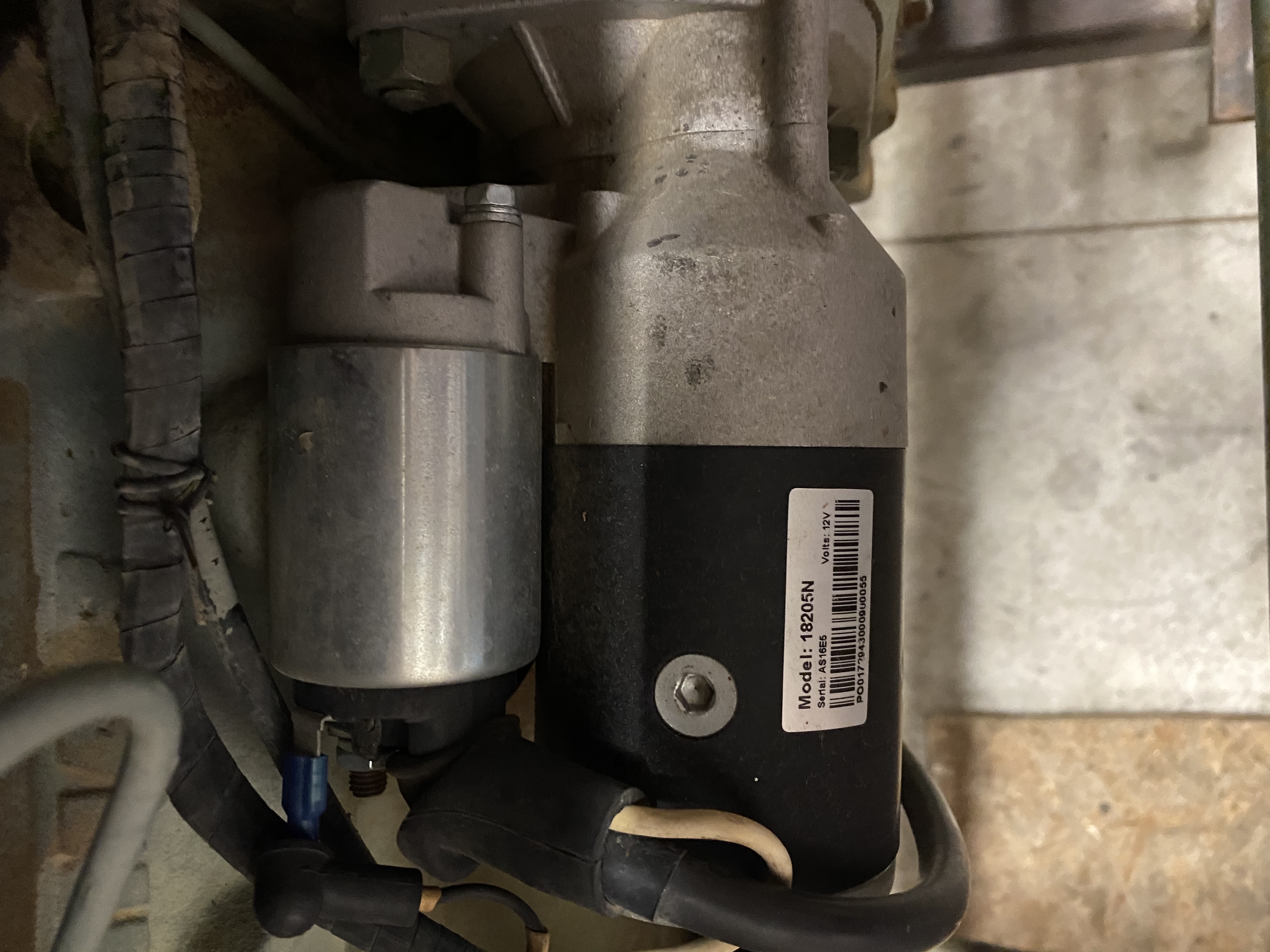

Don’t know that removing the starter is worth the effort? I’ll have to look at that, and if there is even enough room. I could tell there was some sort of plug back there but can barely see it or even get a finger in there to see how big it is. Not sure there will be enough room for the plug coming off of the heater before it hits the starter?

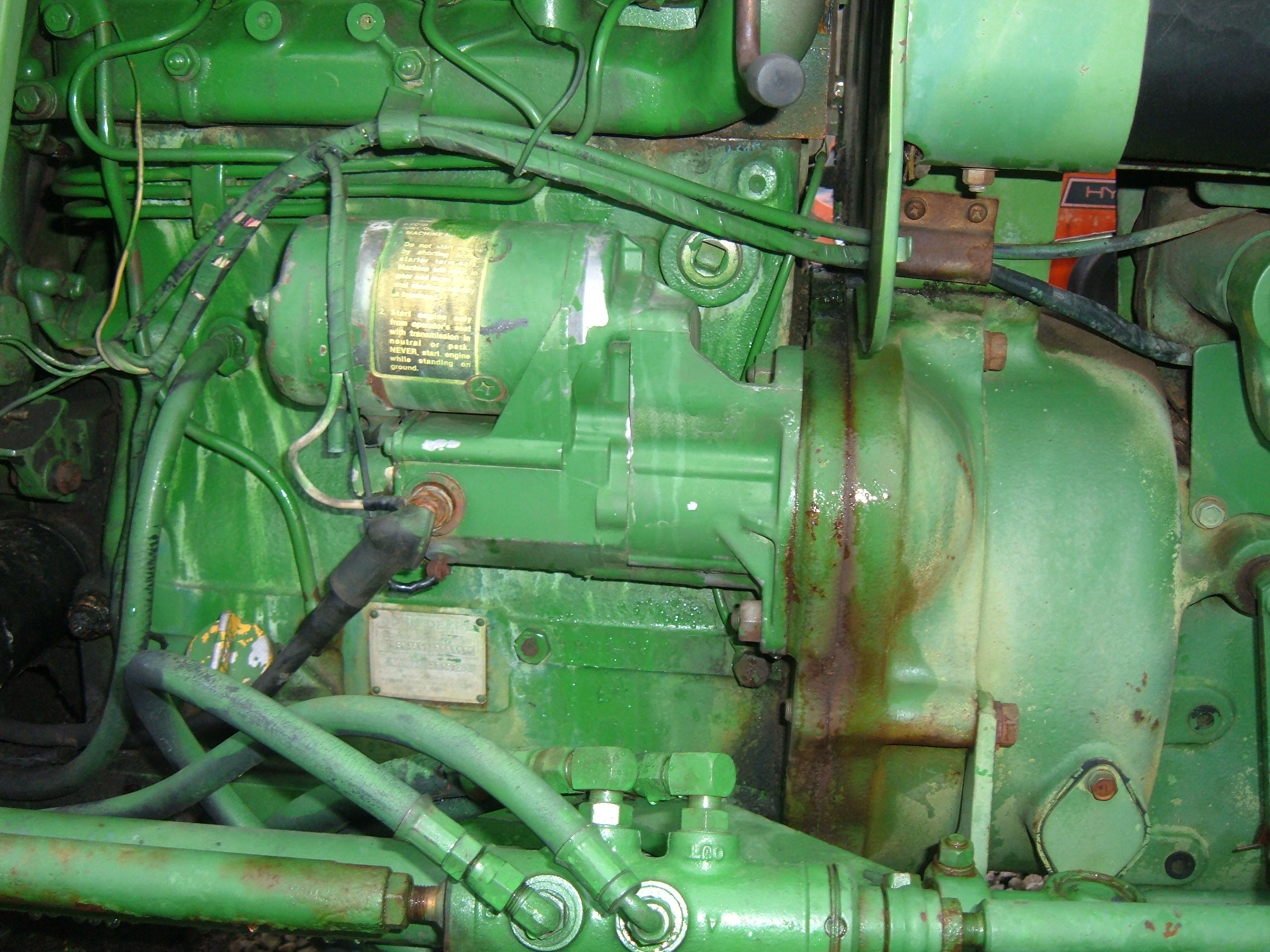

This is the location on the YM336D.
   / Removing Plug to Install a Block Heater - Need some ideas #138
Looks to be the same as behind my starter. My exhaust comes out the right side though (looks like that is on the left side?)
I’ll check for clearance when I get home.
Thanks for the replies all. I’ll keep you updated

Not a chance I’ll get this to fit with the current start that is on there. 13E26252-DAE7-4AF6-8E06-46CA33D528FE.jpeg
