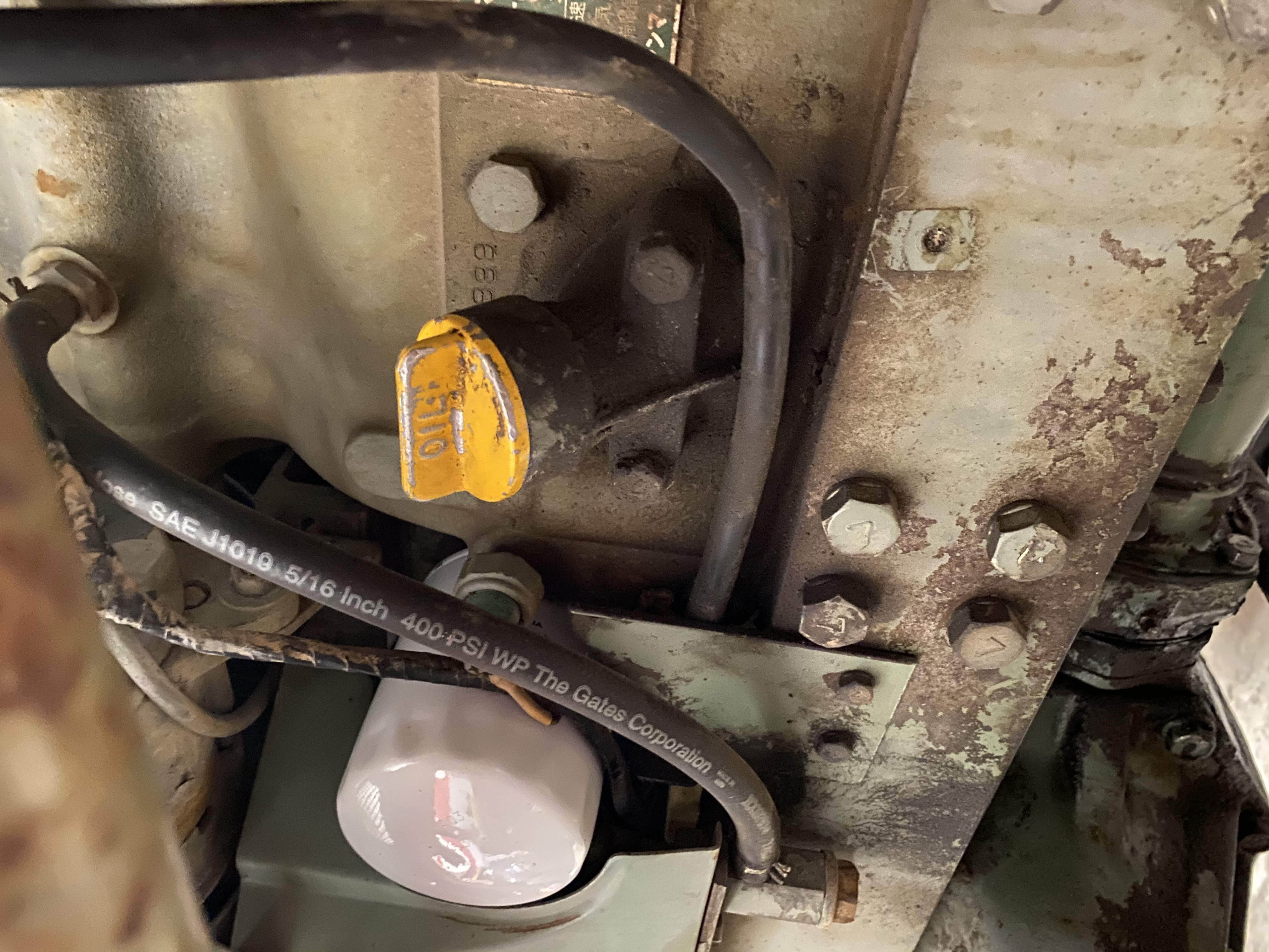

[SUP][/SUP]Sorry to revive an old thread but I cant find an answer any where else. I want to install the block heater as described in this thread, however, in my 3110d there is a hose coming from where the plug should be and runs down into another fitting. Any ideas what this hose is for? I cannt find any info on it. Thanks

Coolant drain.
   / Removing Plug to Install a Block Heater - Need some ideas #118
Coolant drain.
The coolant drain is where the hose is running into?
Is the hose suppose to be there? Seems like every one I have seen so far has the plug in it that is removed to add the heater.
   / Removing Plug to Install a Block Heater - Need some ideas #119
I don't know about the heater plug but that cap at the bottom is the coolant drain. Be sure the cap has an o-ring under it.
The operation manuals for older Yanmars indicate antifreeze is optional and the tractor must be drained for winter, if its in common Japanese use where the tiller stays on permanently and the tilling is done only a few days per year.
I suggest for American use, run antifreeze, install the heater, and securely plug that little hose.
Now the difficulty in getting that plug out is another issue. I see there are lots of comments above in this thread, about that.
