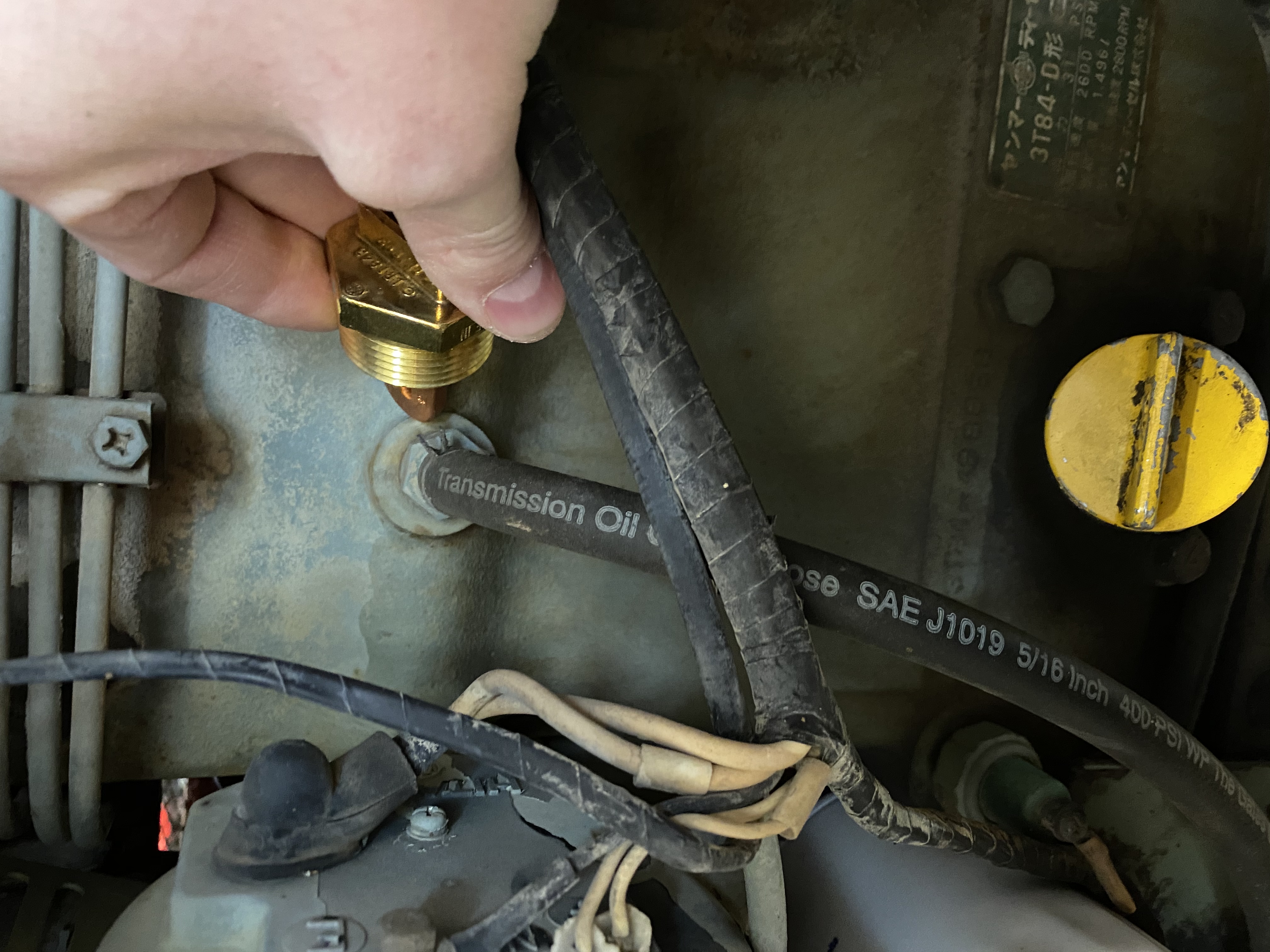

Winston, that second image in the pictures...is that a better spot for a heater?

The second picture is a transmission heater. Yes, you can remove the hose and install a heater.

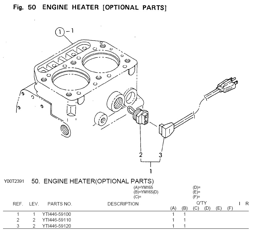

336 manual.
And depending on the Yanmar Engine, it should be very close to plug and play with the ZeroStart devices.
Here is an example with the YM165 as the heater just threads into the block. This is shown in the Optional Equipment section of the Parts Manual.
I've tried and tried to search for these p/n's with no luck. Each p/n is a different wattage for the heater.

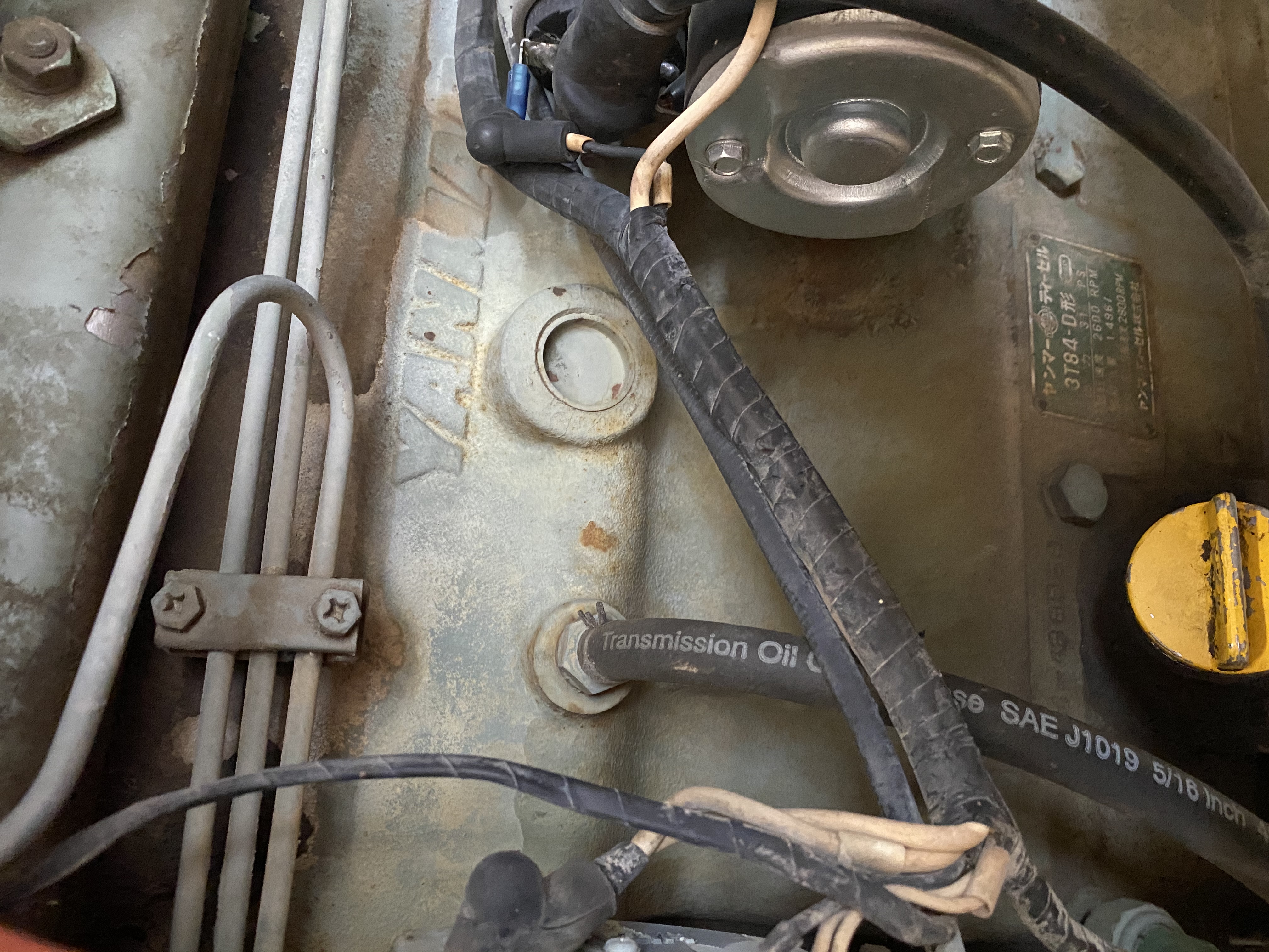

4F0BF497-FC94-41CA-A5E2-8A9E80E83801.jpegF60F2669-583D-4231-8027-4872FFF0E716.jpegSo I ordered the 1 heater that is generally recommended for 3 cylinder yanmar engines and it is way to big for the plug I was referencing earlier! There is what appears to be a freeze plug next to it, just wondering if I should use that with a different style heater? I壇 rather thread it in there than just sitting there in the freeze plug. Any issues with the freeze plug type?
