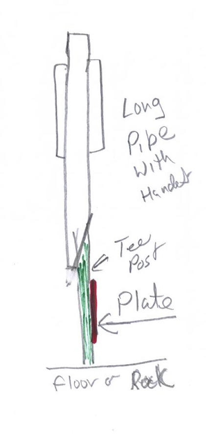

the smart answer is to use them and they will break off when ponding them in.
never intentionally tried to remove them but I would think a chisel and a good support (I am thinking clamp the plate in a vise so you drive the tee post away from the plate) wedge the chisel between the plate and the T post,
and I would think it would just pop off,
as my guess is 50% of my tee posts had lost there plates from driving them in sandy loam earth, for temporary fence use.
but just like any thing else in life if you want it off you can't get it off and if you want it to stay you can keep it on,
if you have many many to do, and it is worth your time to make something,
If you have a log splitter, I would think if one made some fingers that could bolt to the wedge (thinking at least 1/2 think plate, may be heaver 5/8" or 3/4" )and a cup that could clamp on to the Push plate, (cup a short section of pipe to hold the end from slipping on steel) the fingers catch the plate, as they are curved over the wedge, and the cup holds the end of the tee post, and then when the ram is extended it peals off the plate,
I do not know may be some fingers welded on a post pounder or a pipe slide down over the post,
or even a pipe cut at a 60 or so degree angle slide over the post to drive it off, have the pipe longer than the post length to the wedge, and let the wedge hit the plate, if the pipe is short and the top open one may hurt them selfs on the post as the person is driving the pipe down, and it come up out of the top, so make sure it is long enough for safe operation, (my dad about took his jaw off when the top come out of a post pounder he was using).

another veration of the pipe idea is to make the pipe about the lenght of the top of the plate, and then weld it to a flat plate so it will stand up by it self and not sink into the gorund, and then put the bottom end of the tee post in the pipe and wack it a few times with a sledge, may be easier to handle the post and less work, I guess if you needed more or wanted power, put a loader bucket on the post and have some one lower it,
now I have never tryed any of the above Ideas but do not see why they would not work,

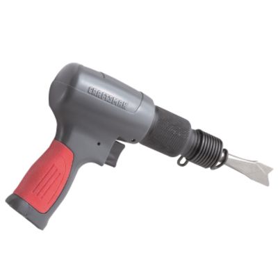

You could buy them from Tractor Supply. I bought 250 last year and over half of them fell off before I got them in the ground. I had to tack weld them back on. They are much needed in this area. The best way to get them off is to lay them at a 90 degree angle over a log. Stand on the t-post and use a air hammer to force the plate off. Good luck.
/ Removing PLATE or ears on T posts easily #13
Use one of these air hammers to strip off the plate.
