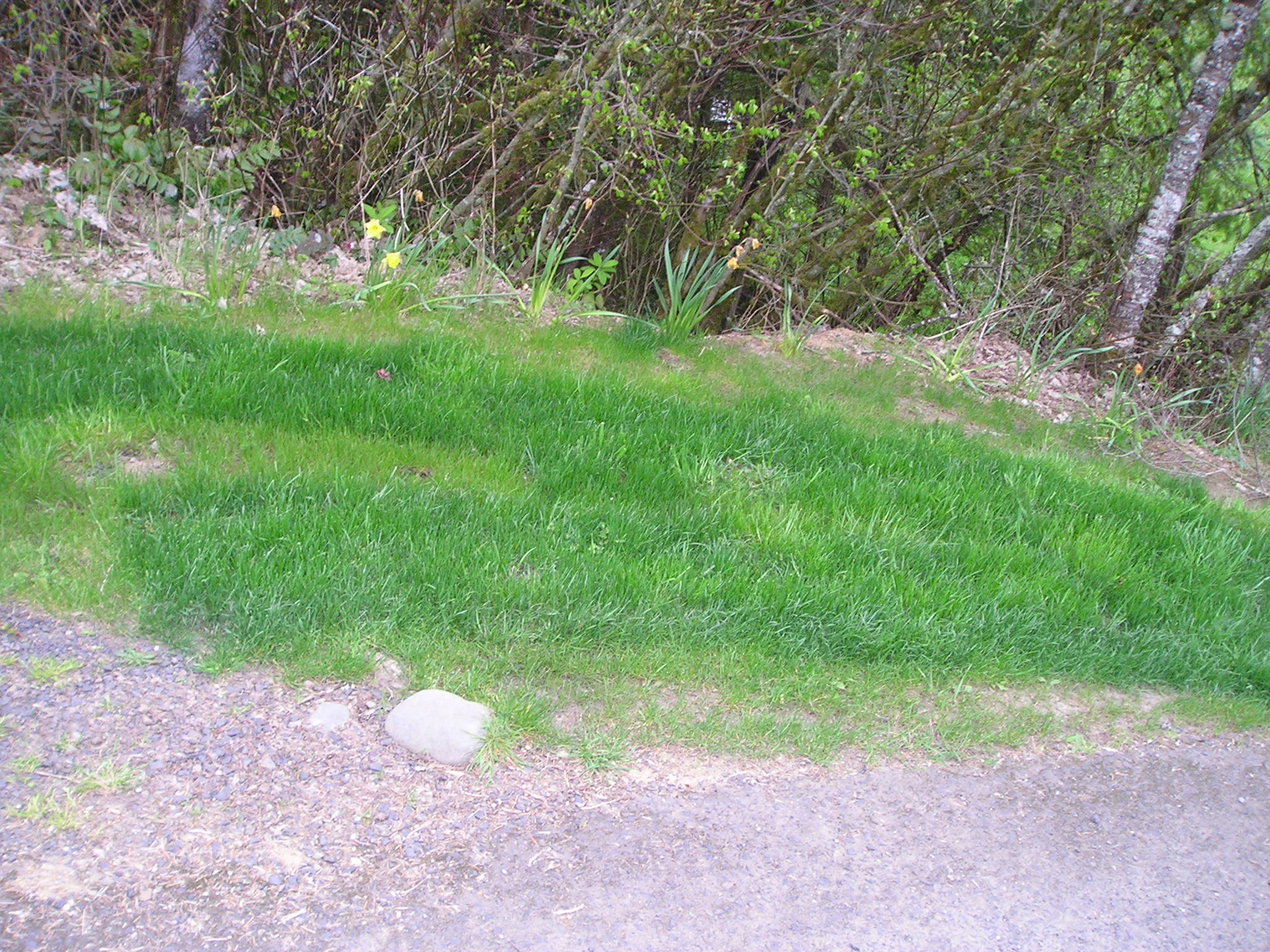

I just took this picture a few hours ago. While it doesn't really show what happens to the moss, it does show the contrast of treated and untreated grass (and why it's important to evenly spread it).
