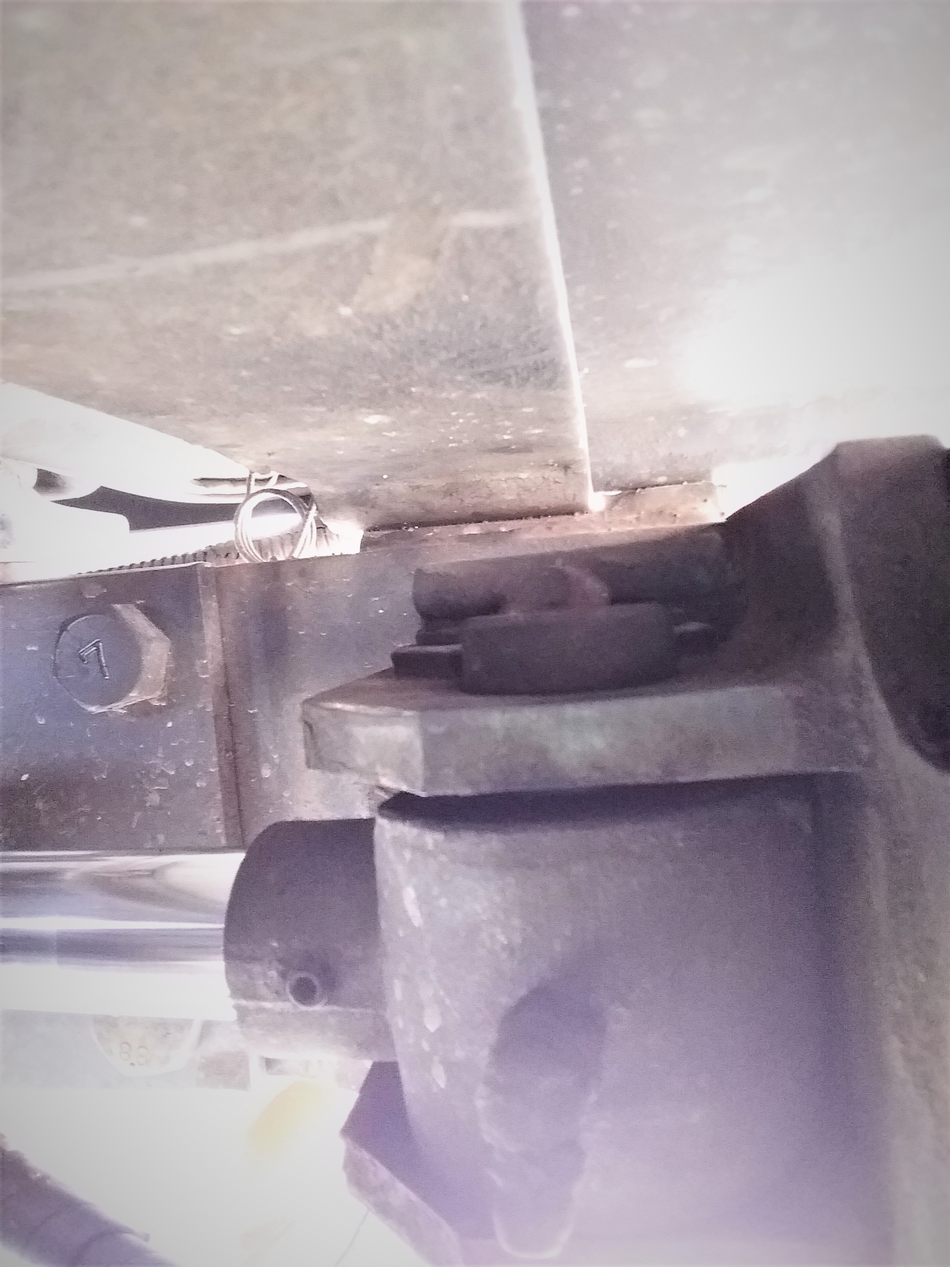

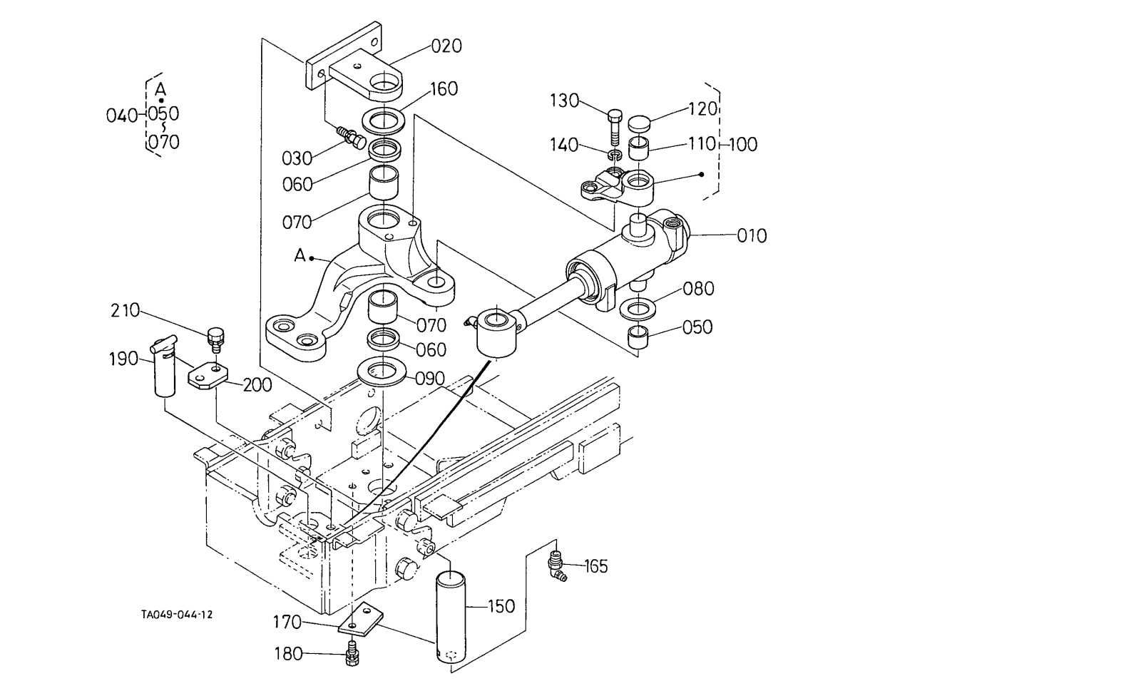

I'm trying to replace the large center steering pin and bushings in a Kubota L4200. I was looking for some advice on how to remove the pins that hold the steering piston in. I couldn't see anything holding them in.

Looks like part #170 holds the pin in
   / Removing Kubota L4200 Stearing Cylinder

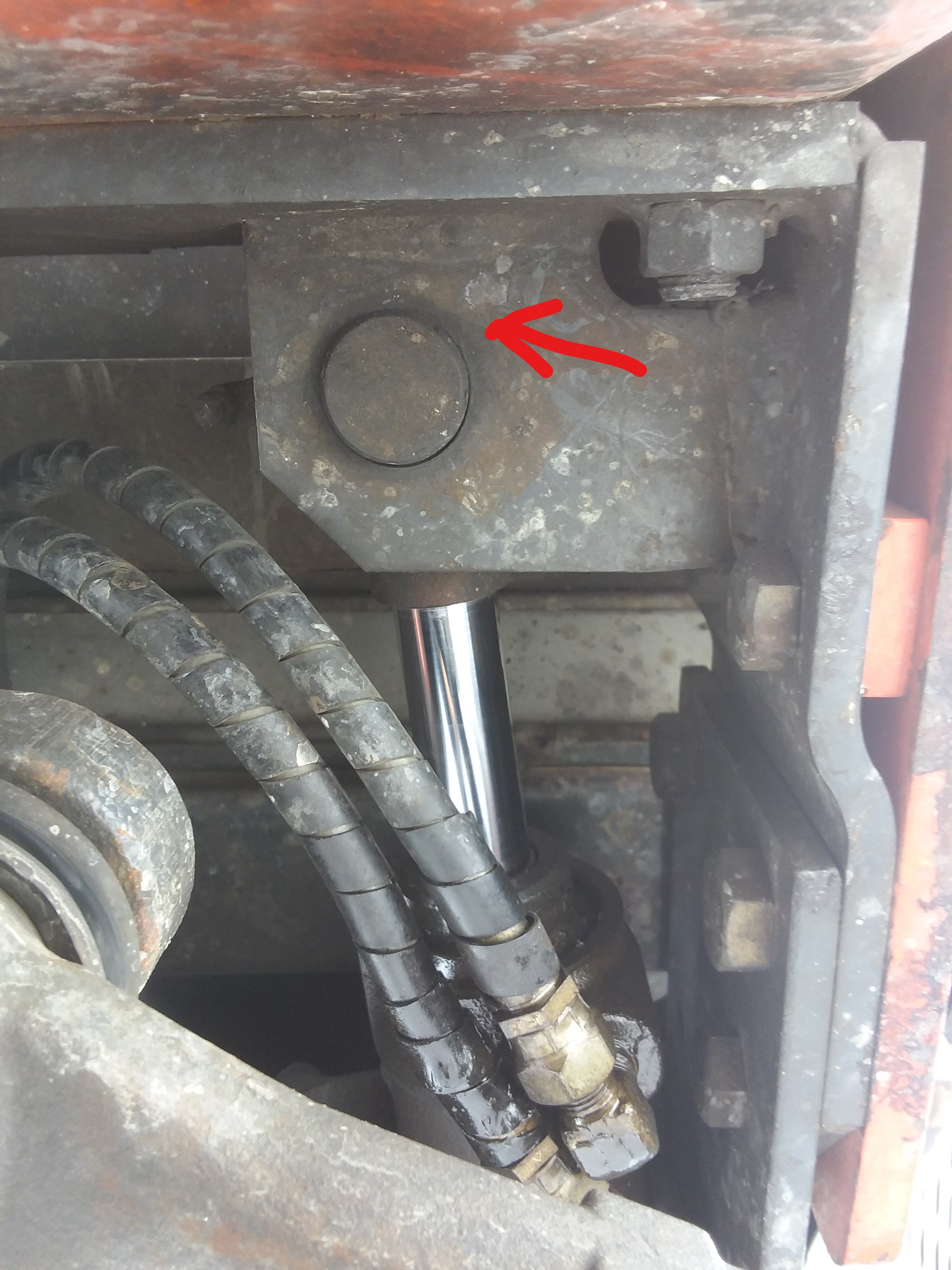

#170 holds the center Pin in but I'm trying to remove the pin that holds the steering piston. It doesn't show that pin in the diagram.

I tried to take a picture of the top of the pin I cant see anything holding it but it won't budge.

On the top there is a plate with 2 bolts take the bolts out and remove the plate part 200
Thank you. I never even see that pin in the diagram.
