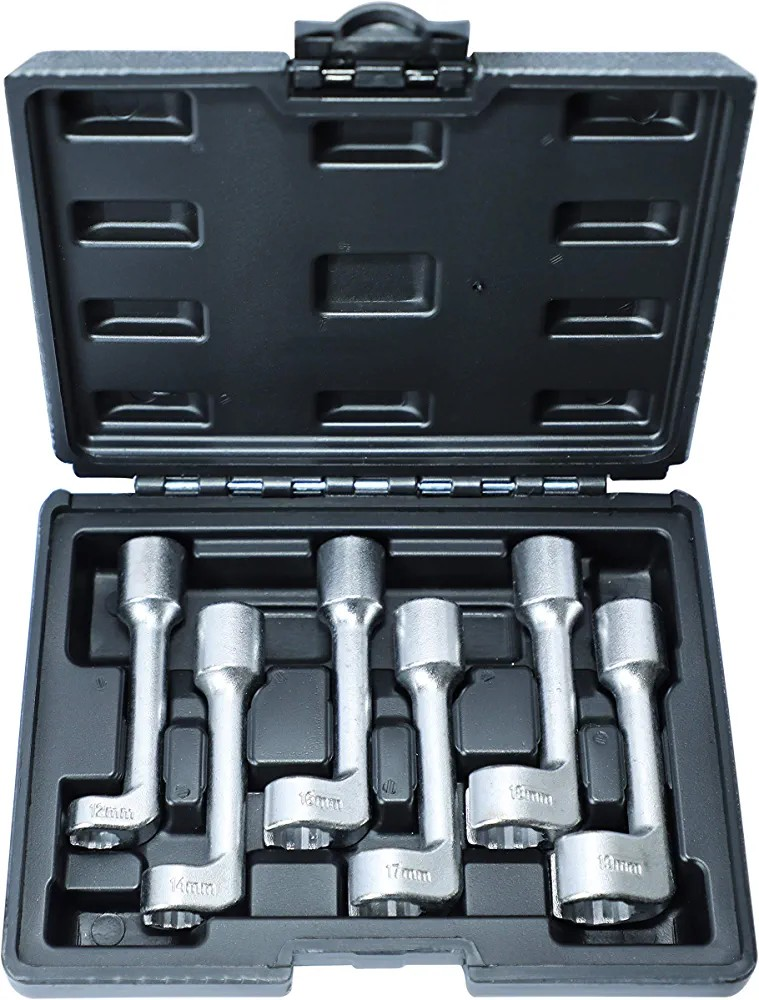

They make some fancy specialty sockets like the ones pictured if like some of us you're always looking for an excuse to buy another tool...

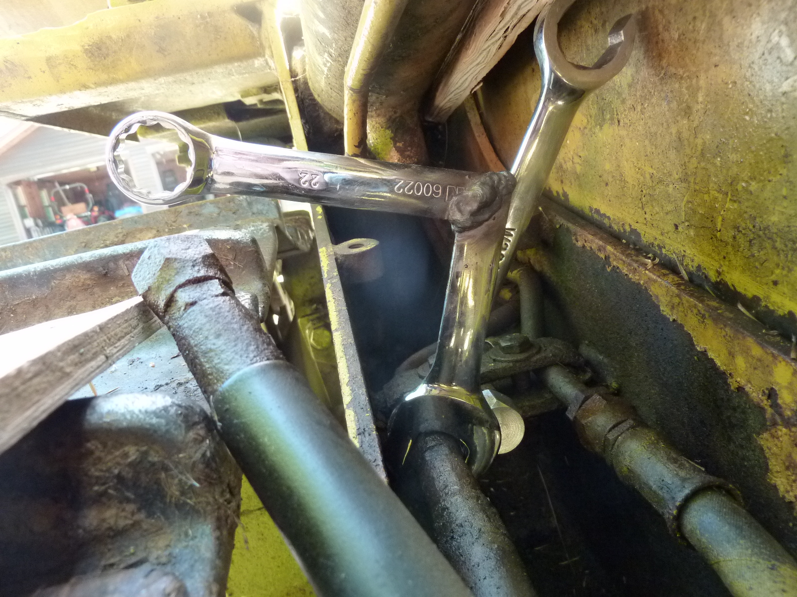

Hydraulic hose wrenches like this are readily available.Or make your own specialty wrenches.
gg

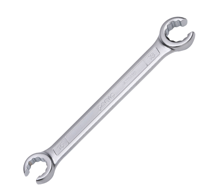

They are a "Flare Nut Wrench". This one is a 12 point:
This is a 6 point Flare Nut Wrench:
