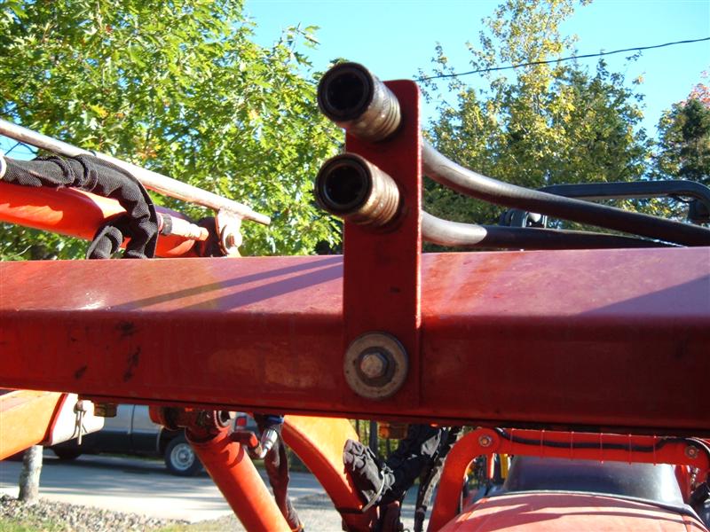

I realize this might be a resurrection of this thread-so be it. When you (or others) rout the hydraulic hoses from the rear remotes and you are now at the FEL post and your tractor has a FEL disconnect feature, do your hoses break there too? Not that a lot of us will ever remove the FEL but what if you ever need to?

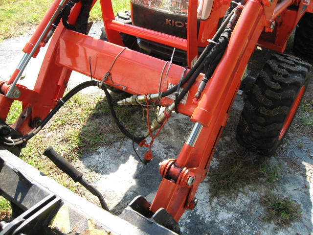

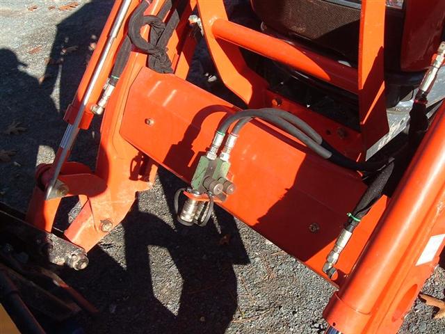

Here is how I made the break at the loader. NOTE: Only showing one disconnect as I was waiting for the second one as it was backordered.

Nice job srs, I see a hex nut that appears to be locking down the QC on the bracket. Does that allow the QC to go through a larger hole and then nut down? Silly me-I thought that maybe I would have to take the bracket to the hydraulic shop so they could thread it on before swedging???
When detached, do you have plastic caps covering the connector-I don't see one.
NP, just like J_J said and I do have the plastic caps now installed but not shown in the pics.

I would say it depends on whether you intend to remove your FEL more than once a season or so. If removing the FEL is a more common task then you can easily break the line right at the FEL support post and have a set of quick connects there. The downside of doing that is the cost of four quick connects and four extra hose fittings as well as a rather bulky collection of these things on your support post. Been there done that. I'd guess it costs $75-100 extra for this option.
The alternative for a one piece hose if you need to remove the FEL is to just remove the whole line by clipping the zipties under the tractor and storing the hoses with the FEL when it is not attached. That is what I would do next time if I were to use the rear remotes to control the grapple/4n1 etc.
