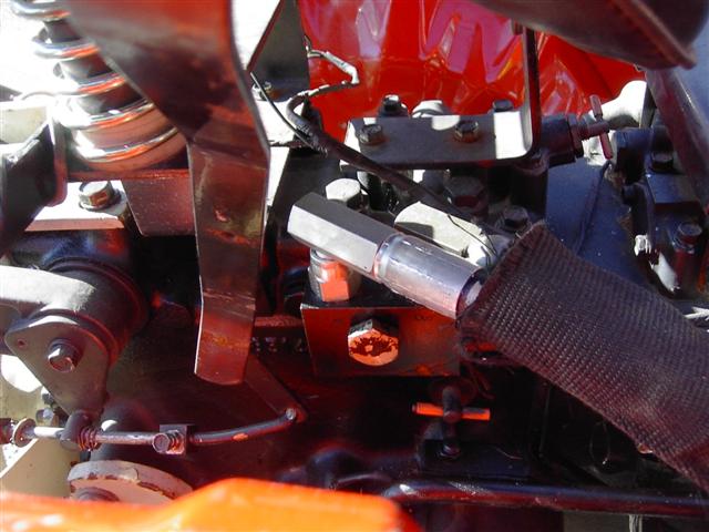

Hi Eddie,
Attached is a picture that should illustrate what I was trying to describe. I have several others pictures and some scans from my YM2310D parts manual and my YM276D service manual (very similar US market equivalent tractor) that give more technical details.
If you look closely at the picture you can see a faint 'O' near the top hose connection and a faint 'I' near the bottom hose connection.
HTH.

/ REMOTE HYDRAULICS #12
Thanks John.
I don't find anything like that on my 2020.
I have a couple of 3 port hydraulic manifolds ordered and am going to make manifolds for mine.
/ REMOTE HYDRAULICS #13
The YM2020 should have the existing inlet/outlet ports To make them work properly a headless plug needs to be screwed in the back of the inlet port to block the passage between the IN & OUT ports. This is described in the YM276 & YM226 op manuals

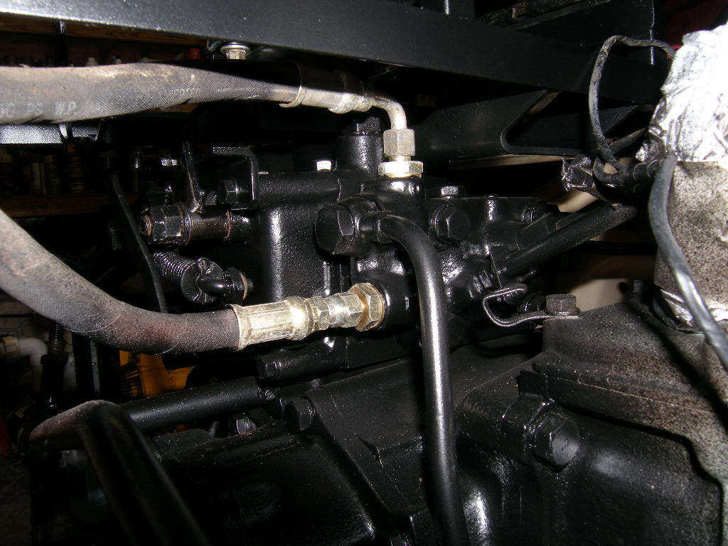

Eddie said:
John
Could you post pictures of what you are talking about. I'm trying to look at my 2020 to see if I have anything like that.
I have a picture of mine i'll post, but it wasn't taken in the best light. My hydraulic block is located under my seat, on the right side of my tractor. If you can locate your high pressure line, you should be able to follow it back to where it will flow into your rear end. I too set out to add remotes with a three spool valve on my US spec YM186D. I read here many times "cut your pressure line, cut your pressure line, cut your pressure line". Luckily, a member here, Deanbro , steered me straight ! He photocopied and mailed me hard copies out of his manual (from the UK !!!!) which clearly show how to tap into your hydraulic block. THANK YOU AGAIN DEANBRO !!! I guess if you have no block.... then its back to cutting into your pressure line. There were two plugs on my block clearly marked "IN" and "OUT". After removing the IN plug, you then thread a 1/4" headless pipe plug into the bottom of the block. This blocks pressurized fluid from going directly to the 3ph and diverts it out the OUT port. The OUT line is then plumbed to your IN port in yout aux spool. The OUT line from your aux spool is then plumbed back to your sump. Your PBY port on your aux spool is then plumbed back to the IN port on the hydraulic block (the same one you put the plug in the bottom of). I can get some pictures for you if we get some sunlight around here. I strongly advise you to only do this if you have the correct manual, or deal with someone who is farmiliar with Yanmar's hydraulic system, as you can destroy your hydraulic pump very quickly. I have been through this within the past couple weeks when i added a front end loader to my tractor..... only difference is my aux spool is up near my steering wheel instead of mounted on the fender or where ever you mount yours. Also..... do a little reaserch on this site. There is actually plenty of info here on hydraulics. I was also lucky enough to get a little advise from MadReferee !
