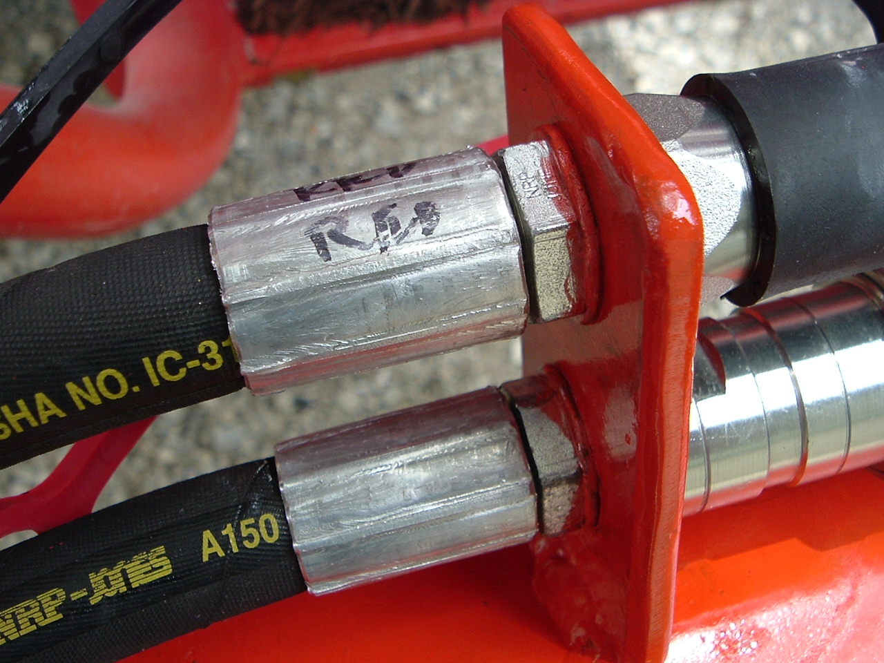

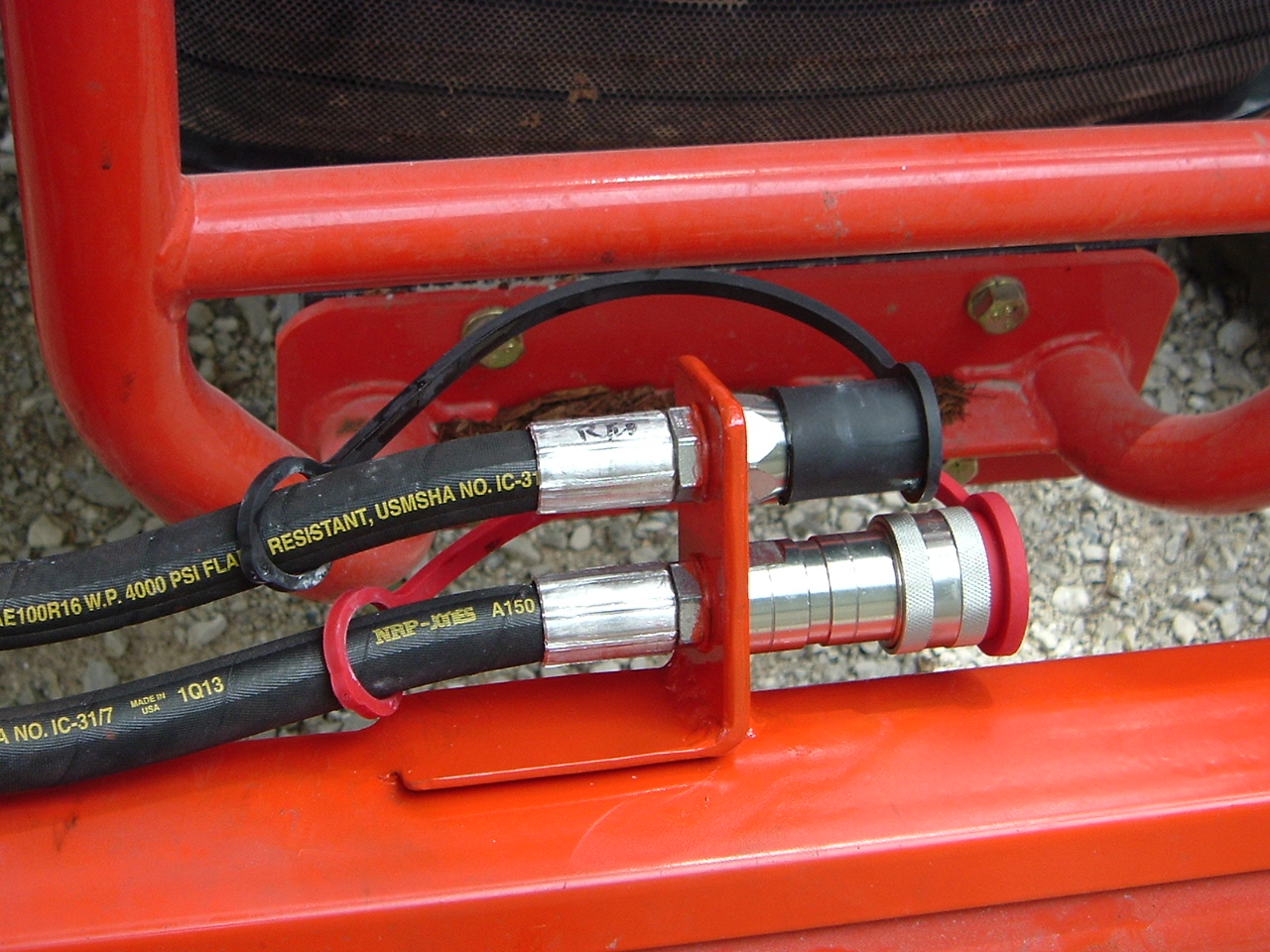

I didn't see a need for custom hoses. My dealer supplied me with 20' of hose. I ended up going to TSC and getting 2 5' hoses. I mounted the qd on the torque tube and the 5'ers from there to the thumb. I don't plan on taking my loader off so I saved the cost of mid point qds. I put 1 male and 1 female paired so I wouldn't mix the hoses up. As far as which one goes where just plug them into your remote. Operate your lever and if you would rather it work opposite then switch them.
/ Remote Hydraulic Hoses #27
This is the qds mounted 1 male 1 female.

Hmm - in looking at your pic I see you have your lines terminating to some sort of a plate with the quick connects mounted to that. My layman's idea was just to run the hoses to the front and connect them directly to the grapple hoses - is that wrong?

I used 1/2 inch, but if I had it to do over I would use 3/8 hoses with adaptors and some 3/8 connectors in the middle to make it easier to take the loader off. I uses 1/2 inch there too, but they are kinda big.
All told, I had about $150 in hoses and connectors

One advantage to using one male and one female up front is you will not mix up the directions of the open and closure of the lid, and has one other advantage, it allows you to plug the grapple hoses together in storage so you don't get dirt on/in the ends.
