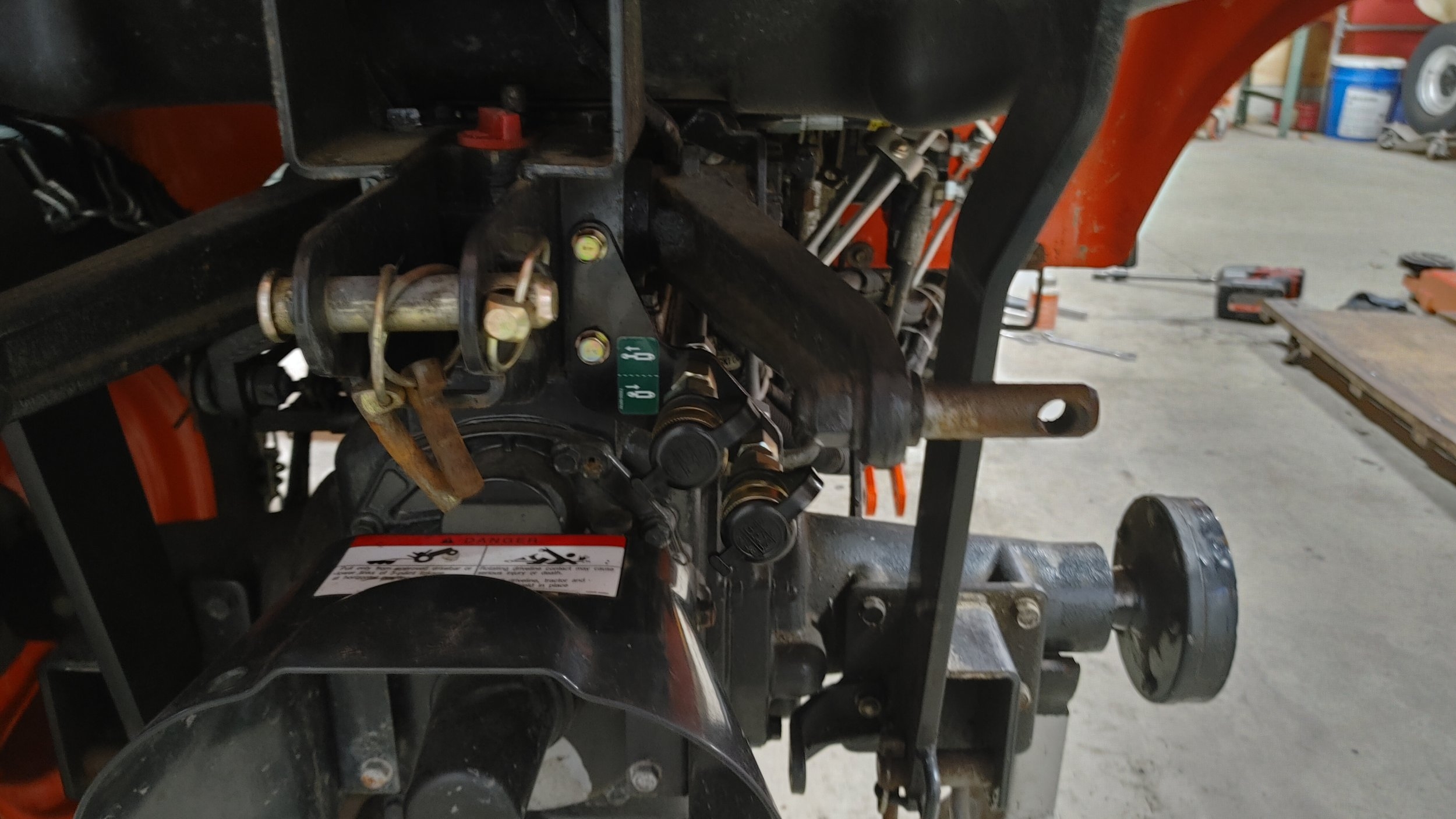

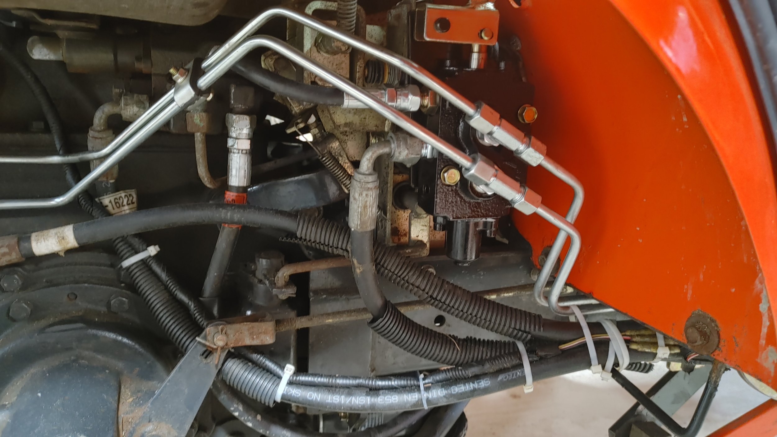

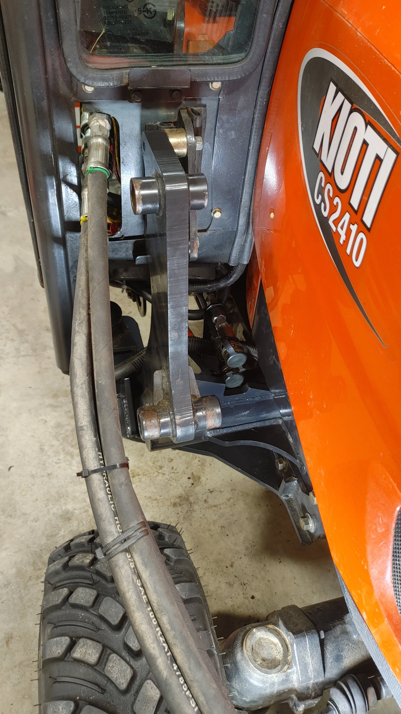

I needed an extra set of hydraulic ports to be able to adjust my top chute deflector, but I also wanted the possibility of rear remotes as well. So I ordered the optional rear remote kit and then also ordered the extra parts for the front kit, as well as pipes and front disconnect mounts. I then got a couple of tees from Discount Hydraulic Hose online and put it all together. It came out well, and I was happy with the result. Had to do a slight modification to the loader frame so the lower front port can be accessed. the frame is way overbuilt, so the notch won't be an issue.

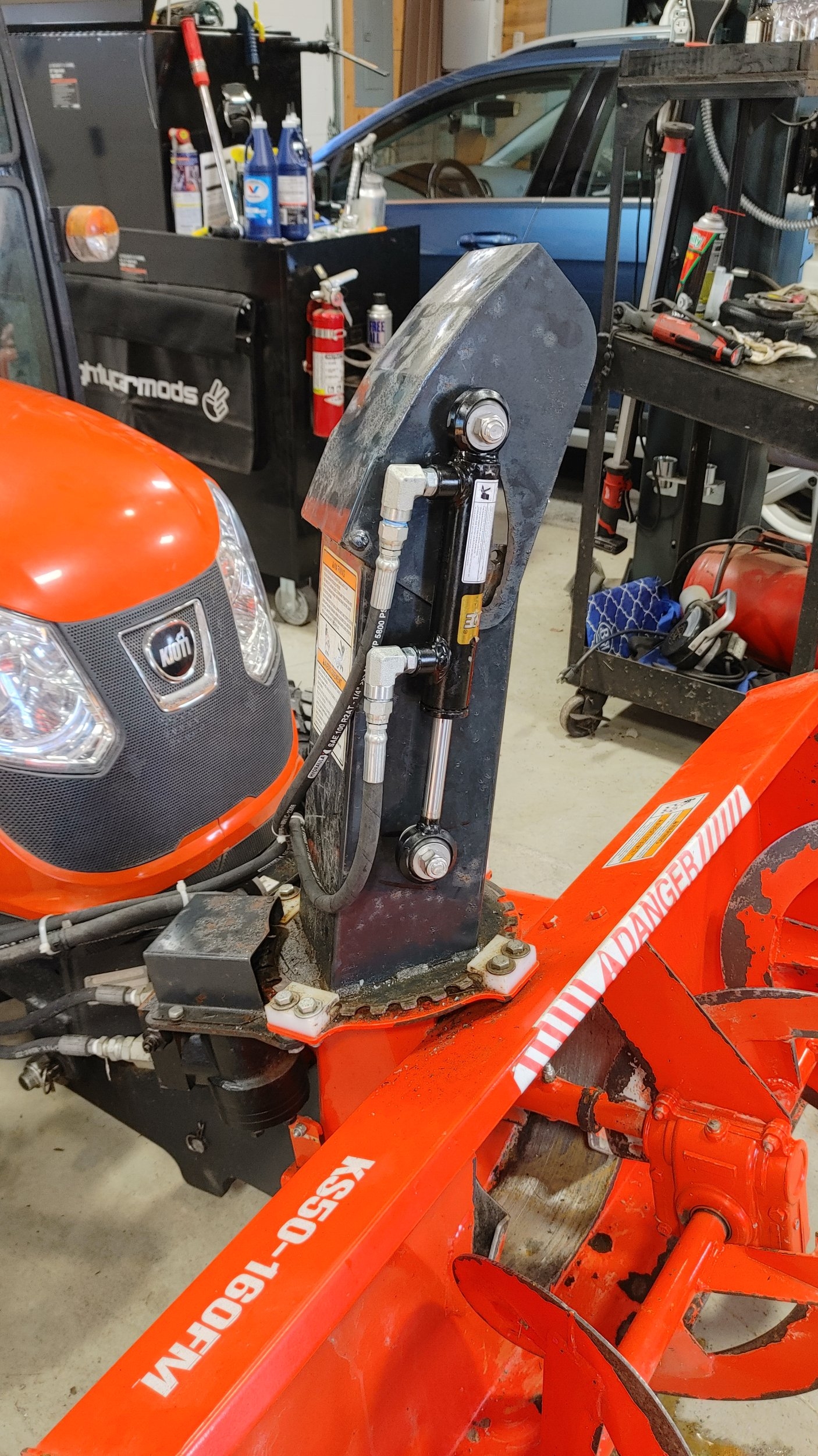

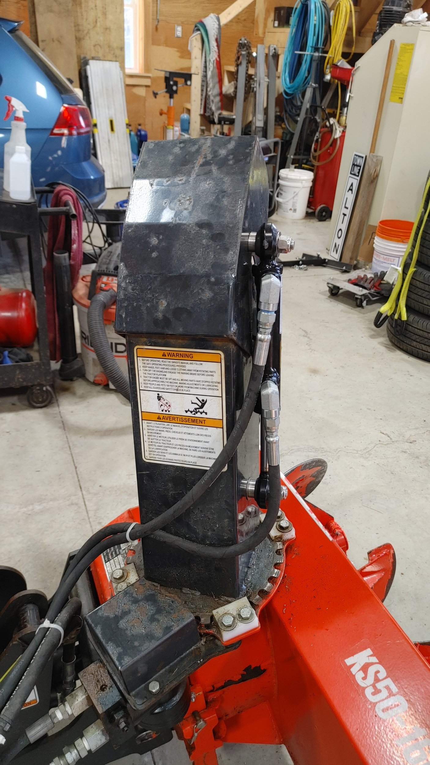

Got my front chute deflector all installed. I used hoses with built-in swivel ends so the hoses wouldn't twist. It looks like I will get to put it all to the test this week with another spring storm with 12-18" on the way!!
   / Added front and rear remote hydraulics to my CS2410 #3
Loooks good! Did you add the cylinder on the shute or is that a factor cylinder? If you added it I'm curious about the dimensions? Might have an application for a cylinder like that..
Thanks,
E.
Purchased the cylinder, you can find it at surplus center item number: 9-12228-4
