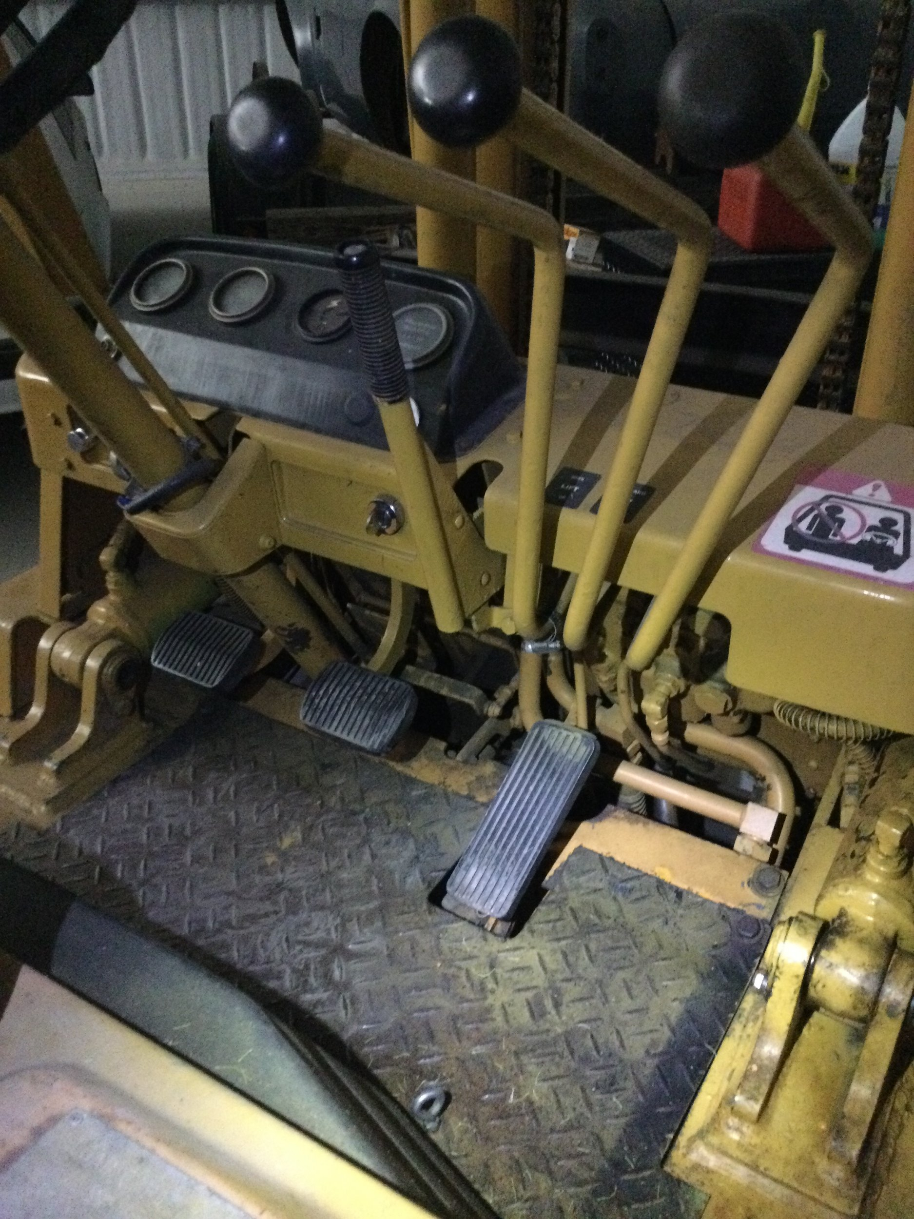

I figure this will be done at idle and speeds should be slow with just a minimum of lever action. And my finger would be on the ready button.
/ Remote control forklift mast ? #24
I've used a long stick in the past. Two ropes would also work and make it more flexible.
Although, if you want something more "civilized", you could use some sort of actuator and a remote control like those used with winches.

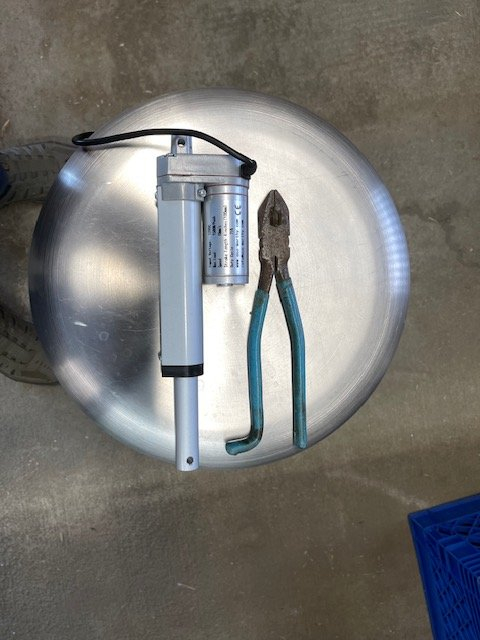

I got a small linear actuator and remote control on Amazon. The actuator has 2' travel (this is minimal. 3" would have been better.) The unit exerts 13.5 pounds of force. This is good force. I bench tested with a 12v battery. The remote has an auto stop mode with a forward and reverse button right next to each other. Handy. The lever I want to operate has a big neutral or off zone. So I clamped a piece L metal to the front ROPs and clamped and wired the actuator into position when the arm was in mid-stroke and the lever in the neutral position.
After a little fooling around I turned the machine on and the actuator did crack the valve and slowly raise and lower the lift.

Can you post a link to the actuator you are recommending? I had this unit on and working but it is at the limits of its travel.

I need this to be quick attach/detachable. I ordered a larger actuator (4" stroke) and I will construct some different attachment.

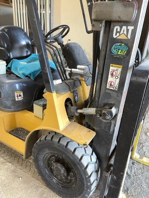

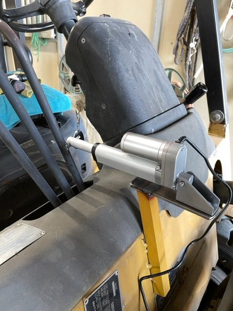

Completed 2nd attempt at this today... Didn't take long. Basically I got a bigger actuator. 4" instead of 2. In hindsight 3" may have been ideal but this will work. I have to be able to easily put this on and off.
I used the same remote control. So far tests are good.
Here are some pics

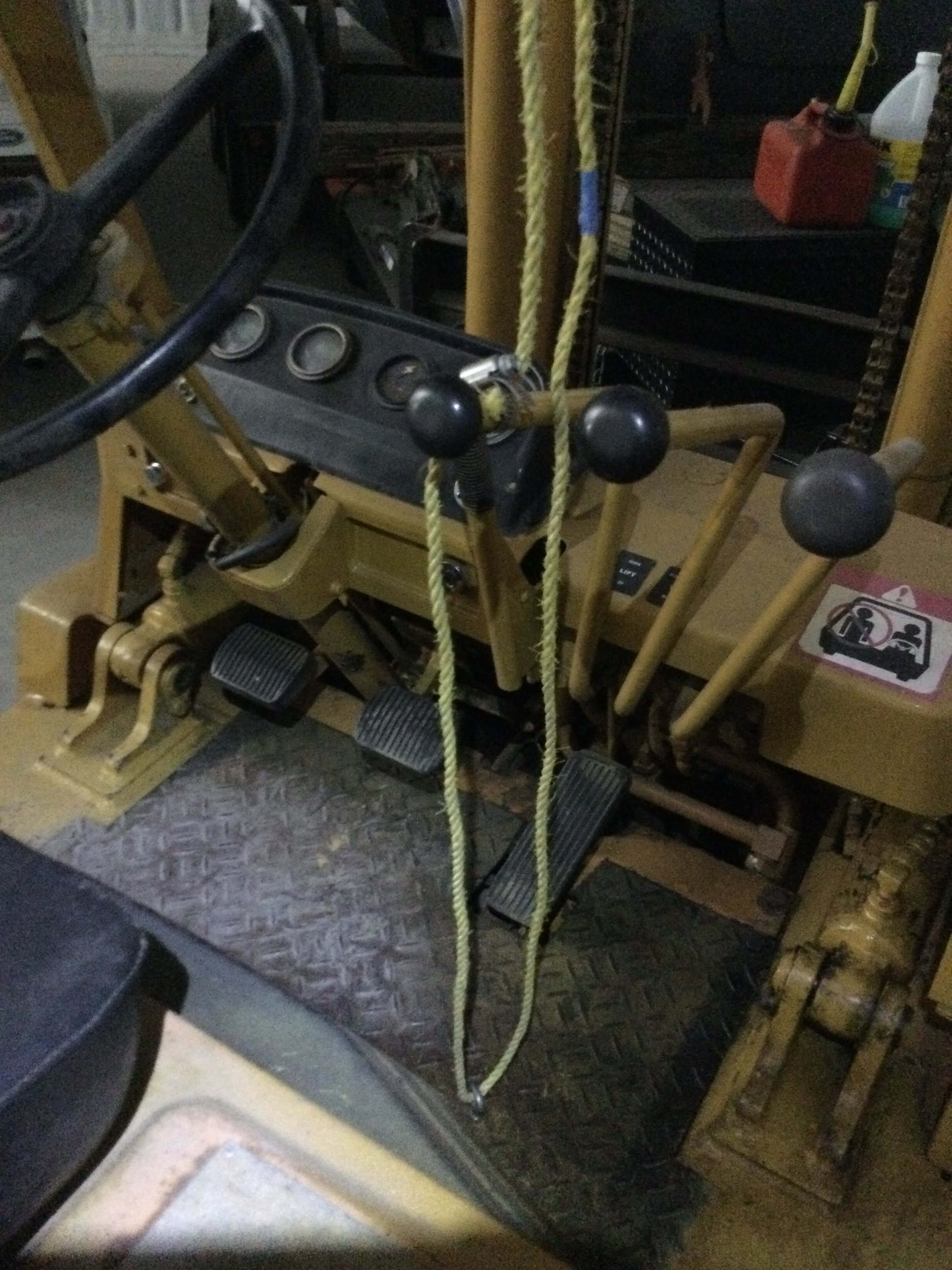

I needed to install a ventilator fan 14 ft off the ground into the back of one of our buildings. It wasn’t incredibly heavy but I just didn’t want to do it on a ladder. I didn’t have any help but for some reason just had to get it done.
I just drilled a hole in the floor and put in an eye bolt. Ran one end of a rope through the eye bolt and used a hose clamp to secure both ends to the “lift” lever.
Neither are in the way, so I never bothered taking them off.

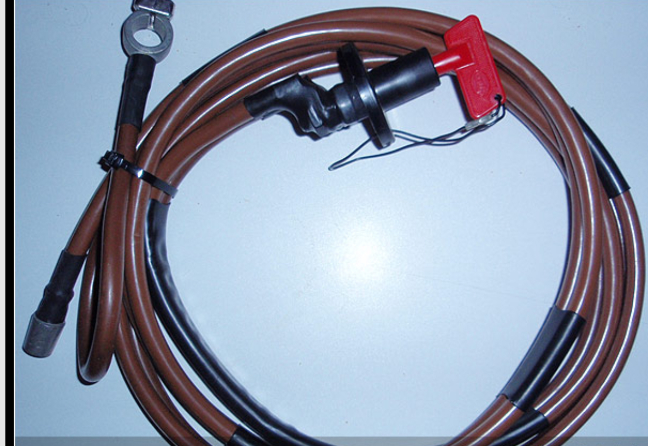

I also had a neat battery shut off a friend gave me (used on an import car during shipping) up there with me so I could shut off the forklift while I worked.

Hi JW - I thought about that but I didn't want a rope. I'd prolly drop it or worse get it stuck in the boom - but it looks like your rope rig worked good. Like you said - sometimes you gotta get er done.
