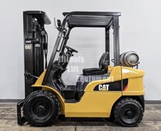

I'm using a CAT P25 with off pavement capability that we use for business and ranch work.
