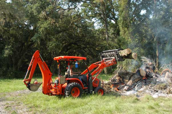

Our L-39 handles an 850 pound hydraulic grapple without any problems and is extremely stable (lower to the ground than the other AG- Utility L- Series tractors).
Here's a pic of our L-39 grapple with about half a ton of logs in it:

P.S., one of the reasons that it is so stable is due that that nice heavy BH counterweight on the rear end.

Looks like a DELUXE chainsaw caddy in the photo :)
