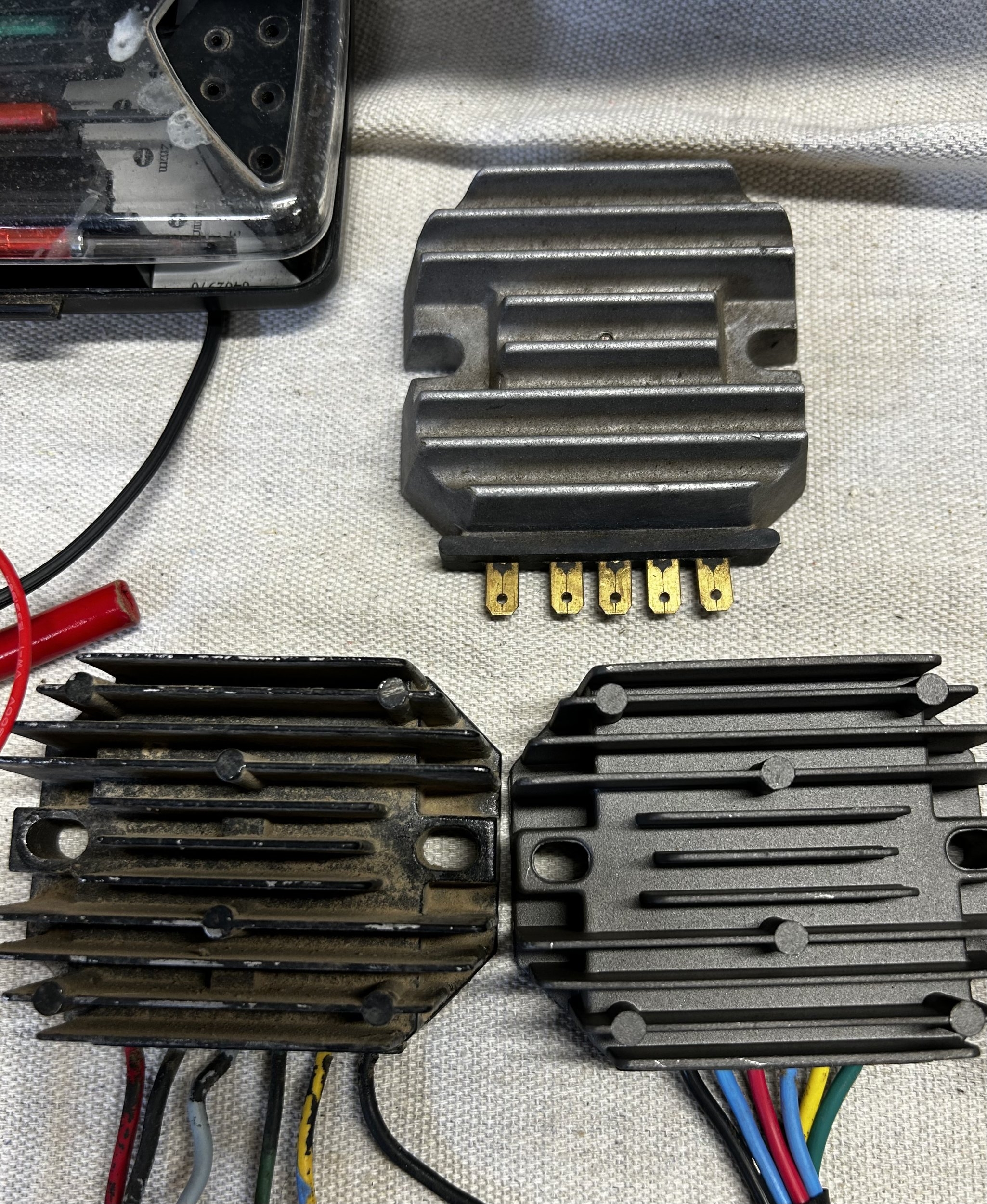

With this last charging issue I wanted to replace the regulator and the dyno. When I look up the regulator on Hoye is shows a 5 terminal setup. The regulator on the tractor is 6 wires with a connector. See attached photo one off the tractor in lower left. One from Hoye top. One I ordered from eBay bottom right. IMG_3591.jpeg

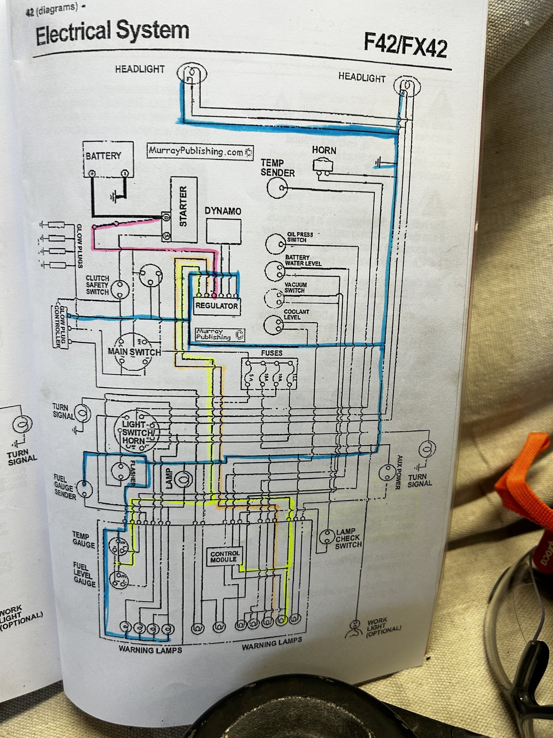

Looking at the wiring diagram for the tractor it clearly shows 6 wires on the regulator. But now my problem is what color wire goes to what? As you can see from the photo the one off the tractor and the one from eBay have the wire colors in a different order.

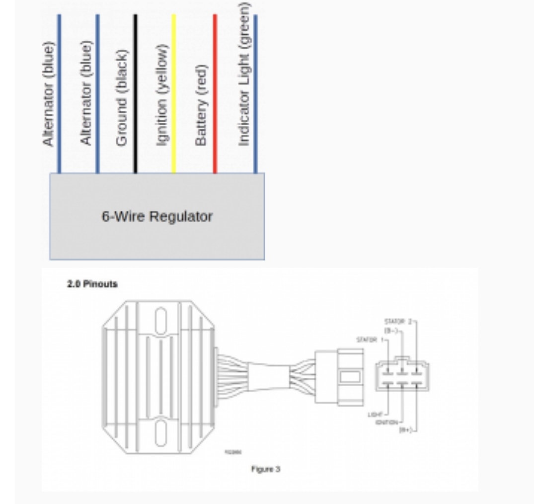

From some of my digging around and looking at other Yanmar wiring diagrams it seems the black goes to ground and the two blue go to the dyno. But I have no idea what the other three go to.

Attached wire diagram highlighter colors are not right just all I had on hand to follow the wires. IMG_3592.jpeg

Does your old and new regulators have plugs on the end of the wire. Can't tell from picture, or does each one plug in separately?
/ Regulator help
Yes the old and new regulations have connectors on them.
/ Regulator help #5
If the plugs match I would plug it in and see what happens. If plugs match my guess they are wired the same, just different colored wires.

I looked over my original post and see I forgot a key element as to why I need the wire colors and where they go. The connector on the tractor side when I pulled it apart fell apart and most of the wires came apart too. They are all the wrong colors looks like some scrap someone had laying around. So I have little to know idea as the what goes where. 😡
Wish I had taken a photo before I had pulled it apart. But I was not expecting this result.

This looks to be wired the same. Same wire colors from what I can see. It's on a YM2000. The Org. old style Reg. is still there and works. VR. 550

I was able to get to the tractor yesterday and today. Installed a new regulator, dyno, belt, and replaced some wires and connectors.
I am very happy to report that she is charging again. Wiring is cleaned up for the most part.
Thanks for the help.
