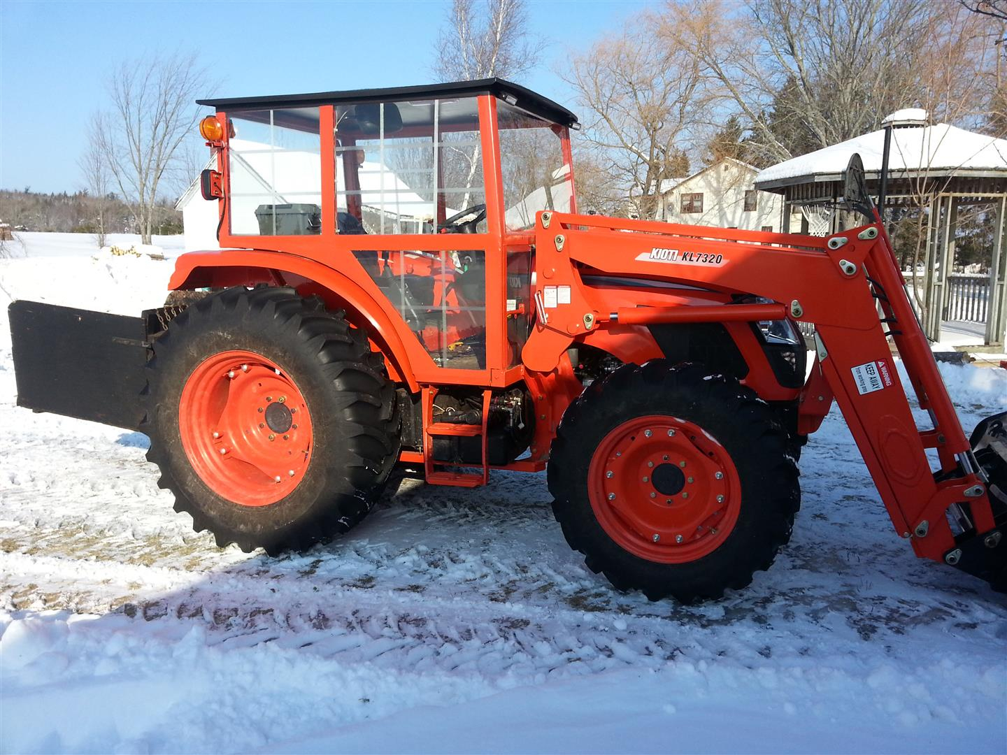

I live in Michigan and have an open Tractor that I use year round. The snow blowing can get a little annoying when you have wind blowback, but if you dress properly it is not too bad. I would base my decision on how many hours you are going to be sitting on the machine. If I have to blow snow 5-10 times a winter, at an hour each time, I can't really see the need for the cab for 10 hours a season. Use it more in the summer but a sunshade takes care of the worst of it.
/ Regret a cab tractor? #82
Try five times a week and you’ll be singing a different tune.

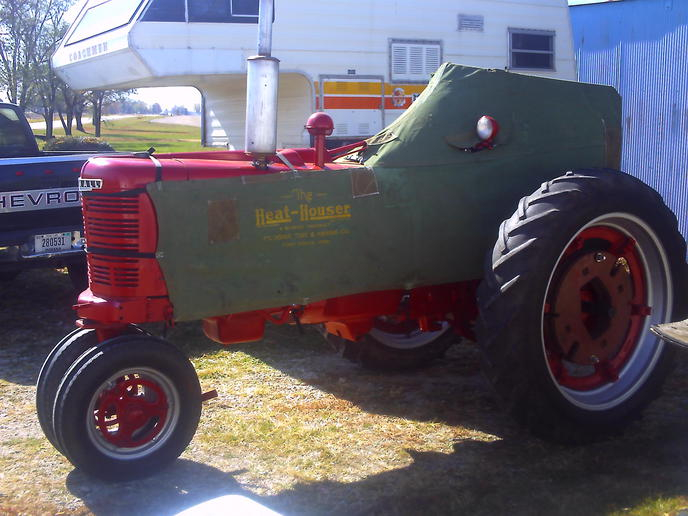

60 years ago, when all we had to move snow was a home-built snowplow on our Case SC tractor, my grandfather bought an enclosure something like this, shown here on a Farmall H. Ours had a plastic windshield mounted on top. It did the job, cutting most of the wind and providing some heat back to the operator.

60 years ago, when all we had to move snow was a home-built snowplow on our Case SC tractor, my grandfather bought an enclosure something like this, shown here on a Farmall H. Ours had a plastic windshield mounted on top. It did the job, cutting most of the wind and providing some heat back to the operator.View attachment 719237
I have something very similar for my JD 2020 except I also have a plastic windshield that goes with it. Closest thing to a cab tractor I ever drove until yesterday when I bought a LS tractor with a cab. I wasn't willing to pony up the extra cash for a cab but my wife chipped in the extra bucks for my birthday. Thanks for all the responses to my question. Still have the JD 2020 open station so I now can choose dependent on the weather and the job.
