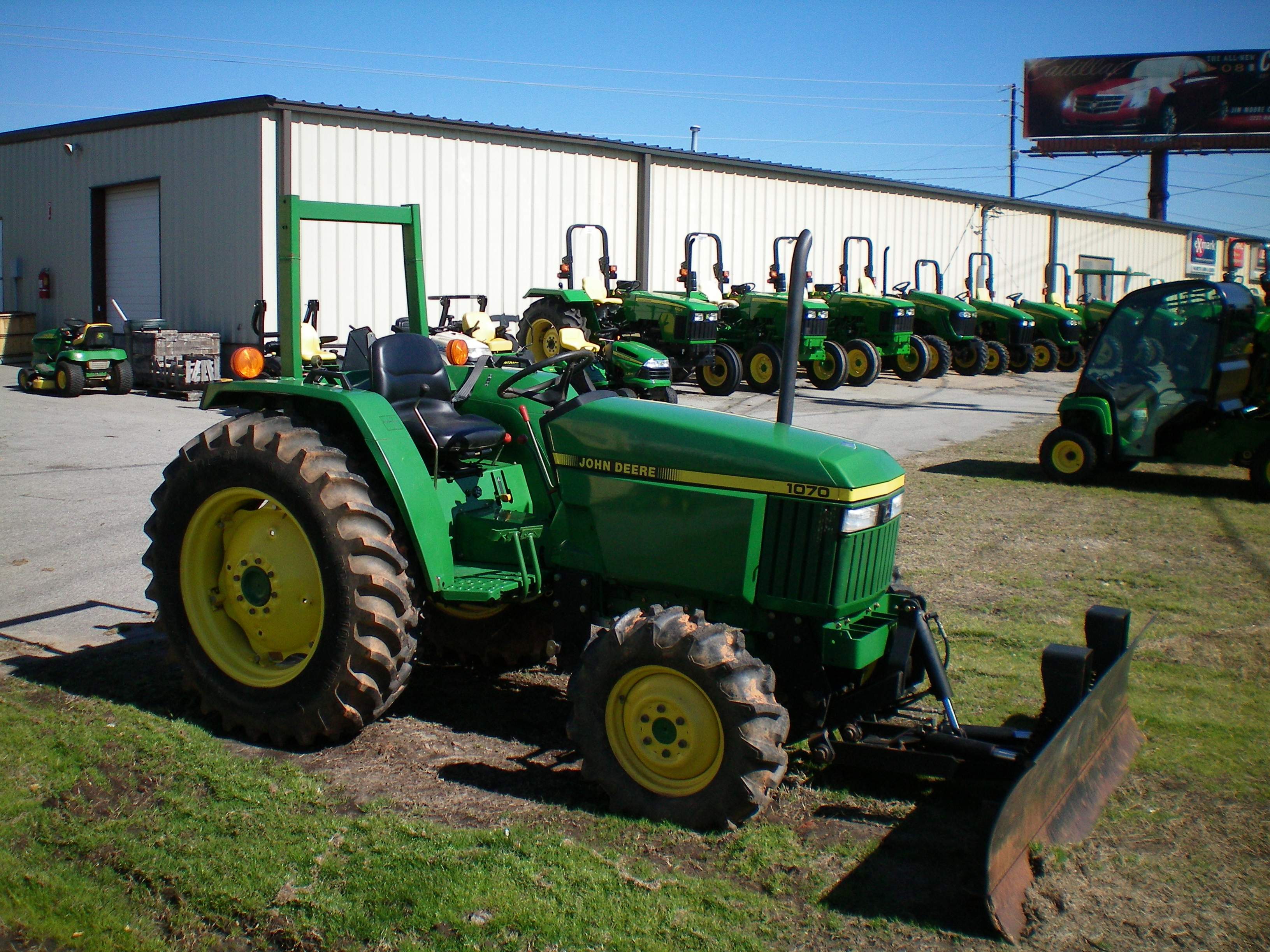

This tractor has regen and the cylinders are single action, just dont push the valve all the way over into the regen area and you wont have a problem. If you do push the valve over to far it will cause the cylinders to jump but you wont get any real movement out of em. This front blade is still setting up at the dealer as far as i know if anyone is interested in it. I told him to see if he could sell it and never asked him about it again.
