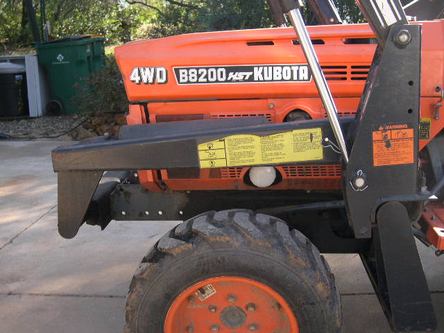

Many newer tractors have their mufflers inside the engine compartment. My NH TC40 does.
My previous Kubota B8200('85 vintage) had the muffler outside the engine compartment. It was vertical, with a pipe going about 2' past the end of the muffler. Because I hit it on branches, and for noise, I was able to unbolt it from the manifold, and turn the whole thing 90 degrees. It faces out towards the front now. The tube coming off the muffler was shortened and had a flare to direct exhaust downward.
In the picture, the muffler is just visible behind the loader arm.
This helped on both accounts.
Maybe you could have a muffler shop reroute the exhaust pipe to help.
Others who posted are right though; these tractors have lots of sources of sound/noise. Muffler is only a part of it. Good set of earmuffs...
