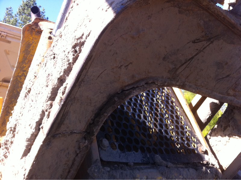

I assume that is a pretty thick member. If you can get to the opposite side it would be good to vee both sides rather than one side. If the cracks go all the way through; can you block the two pieces so they wll not move? If not you may have to put on a temporary splice to hold it in place. Make sure you cut out all cracked/flawed material. If you don't, you may build the same flaw into your new work. Be sure to grind out all bad materials. If it is say 1" thick material grindig the vees(s) can be tedious. I would burn out with a scarfing tip on the O/A cutting head and then grind it bright. On the vees(s) leave as much thickness in the bottom as the diameter of the rod. I would use 6010 for the first pass or 2 passes if it is over 1/2" base material. and finish up with the 7018. 6010 is easier to control in the bottom of the groove and get unflawed full penetration. As shieldarc said; keep a short arc for good puddle control. It never fails that if you have a minor flaw in the root pass it will carry through on every subsequent pass. That is why pipe welders always are meticulous on the root pass (always use 6010 unless the approved procedures different) and even grind it well before starting the next pass. A leak in a 24" pipeline can get you sent back to the hall.

DITTO: 6010 best first rod choice. You can adjust heat so it kinda freezes making it easier to control and is a deep penetrating rod. Then cap with 7018 .JUST RETIRED UA FITTER WELDER TOO

Thanks guys, I just picked the welder up. I'll update on how it turns out. It's gonna take 2hours prepping I'm sure.

Needless to say... Pictures!!

Geez my arms are tired! I just finished up by the light of my iPhone! It turned out pretty good, not my prettiest work but it'll do. Man whoever welded on it previously shoulda hired it out, pretty bad! I took a couple pics when I started but as I saw daylight fading fast I didnt have time or light for pics at the end. I'll snap some more tomorrow. I burned about 5lbs of rod and used up 3 grinding discs getting the cracks and junk welds out. Thanks to all for the tips! I'll add one of my own- put your rods on top of the welder by the exhaust to keep em warm! Btw wish the bobcat was mine, welds almost as good as the old Dialarc!

That 4th picture, I think I seen Ray Charles working on that! :laughing:

Yeah tell me about it! It was actually alot worse than the picture shows. I'm kinda surprised the thing didn't fall off already. i ain't claiming to be a welder by trade or anything but some of those old welds were pretty lame attempts. I just about burned up my grinder cleaning em out. It actually was a little tough between the rust, mud, awkward position, and fixin their bobos. Also the frame is tubular but the bottom piece is thinner than the sides. At first I was too hot but once I got my amps good it went smooth. The little dozer is back in business!
