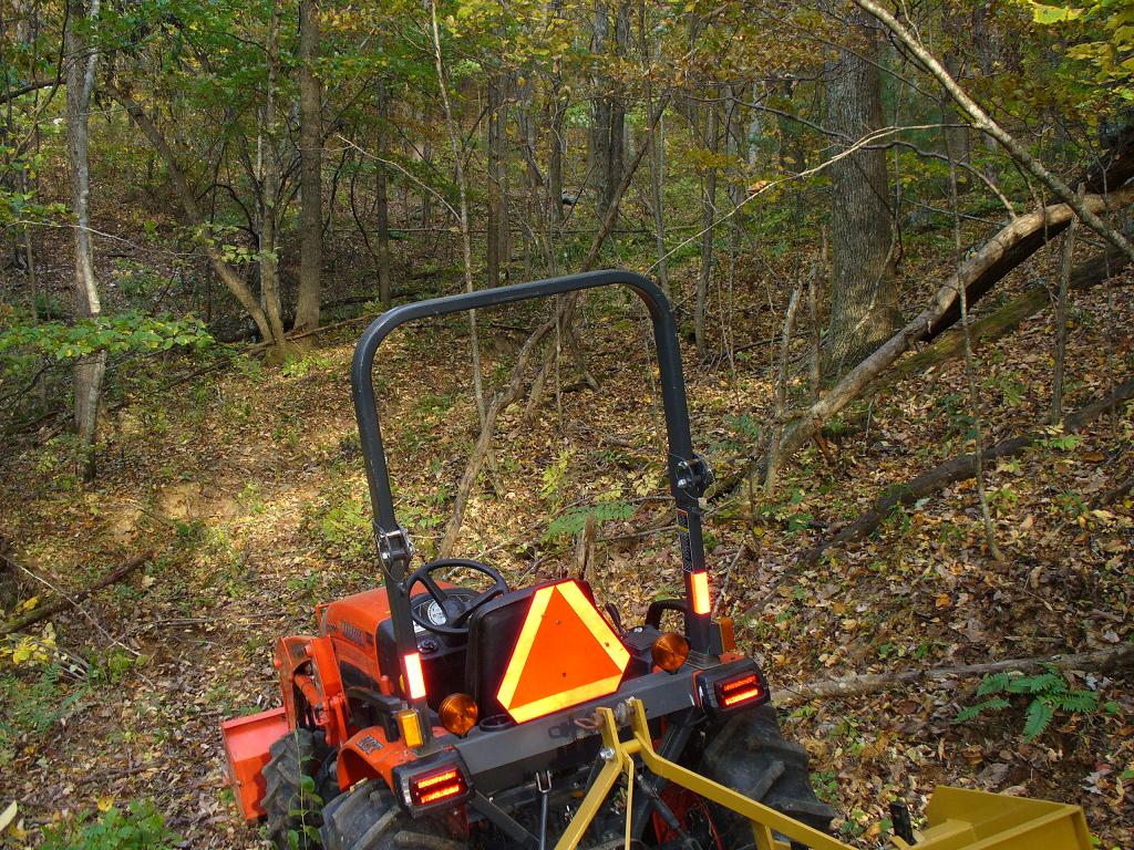

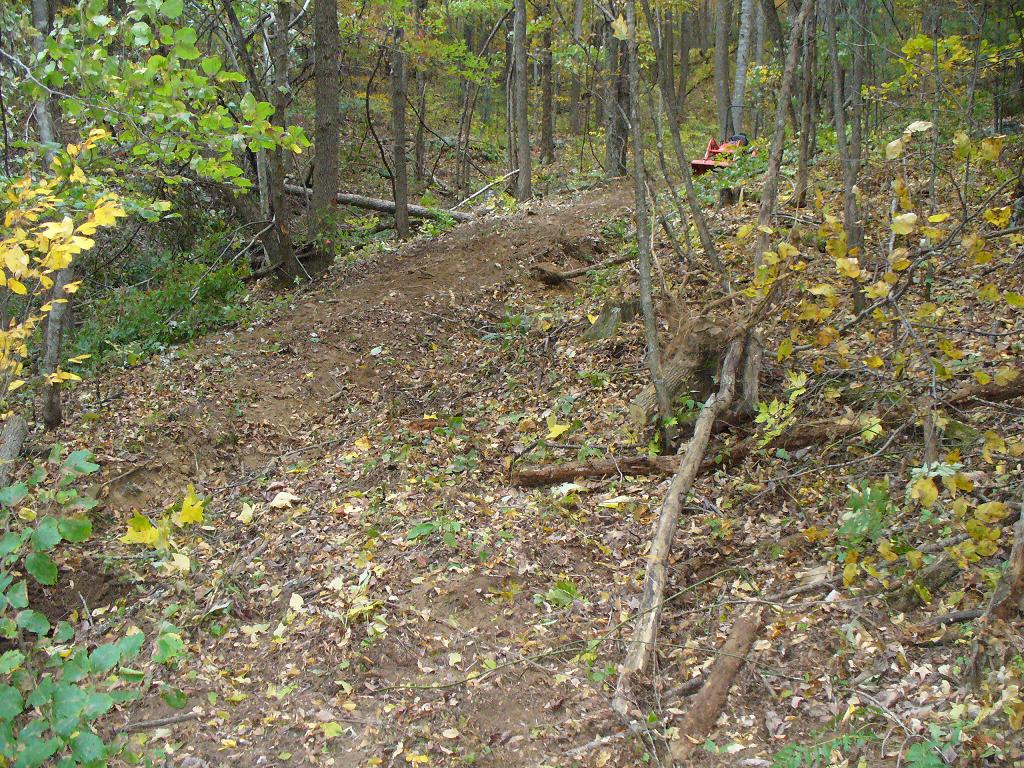

I've been out the past couple evenings working on a new project so I thought I'd post some pics of my progress. We have about 150ac of woods on this farm and most of it was logged about 40-50yrs ago, so there are quite a few abandoned logging roads. I've been working on clearing them out over the past few years and keep finding more. This road was about halfway up a decent size mountain and there was no access to it, aside from a small ATV trail that I blazed years ago.
This first pic shows the ATV trail (I've already pushed out some trees) and a few of the trees at the start that need to go (the three on the left and one on the right).

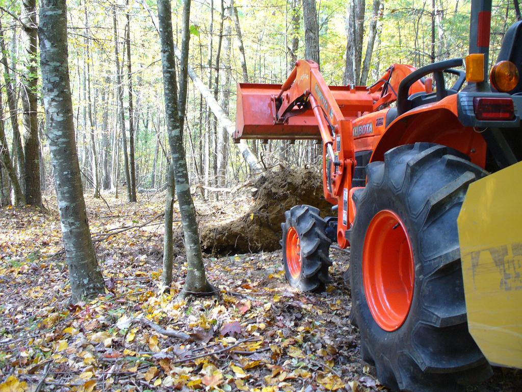

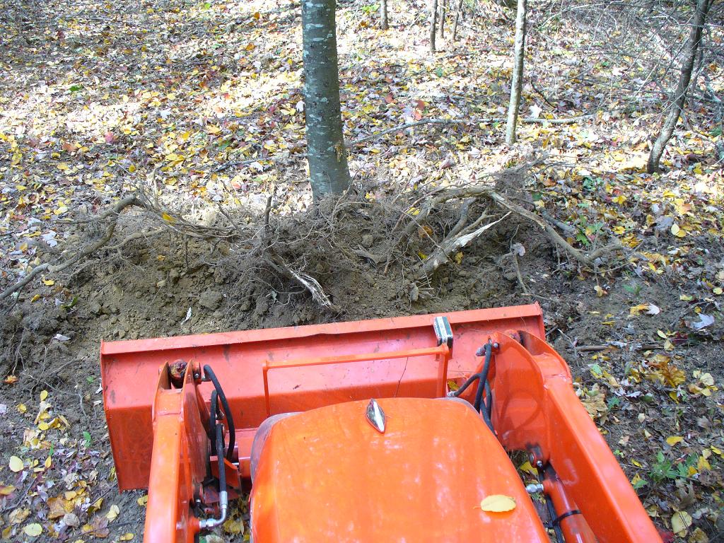

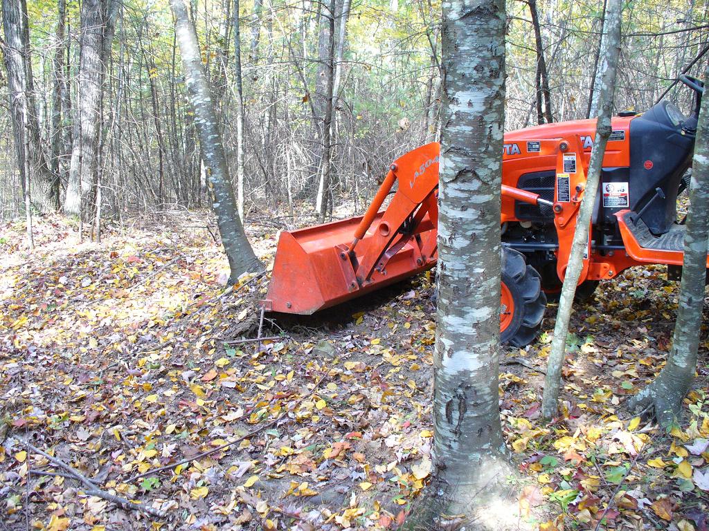

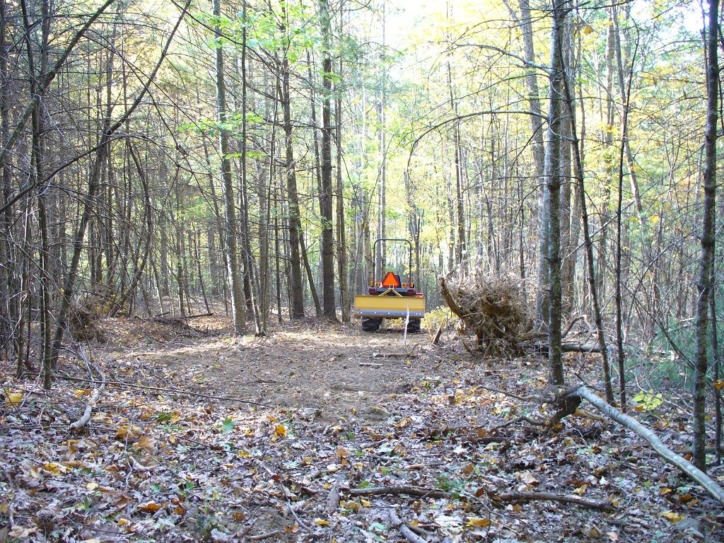

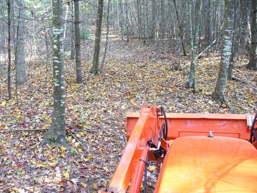

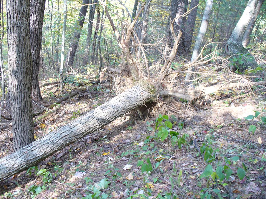

This is my technique for pushing out trees.
Start pushing up high on the trunk, watch the ground around the base to see where the roots start to move. Take the bucket and tear out some of the roots on the front and sides of the tree. Then push a little more up high, pry some from below. Once the tree goes over I take the bucket teeth and pull all the dirt off the root ball to fill the hole. Then I engage the teeth in the root ball and lift/push it out. These trees are about the biggest I would tackle with this tractor, the conditions are good right now (soil not too dry/hard) so they came out easily. If a tree doesn't at least move a little and a few roots don't pop up with the initial push I go get the chainsaw. Not worth tearing up the tractor fighting them.

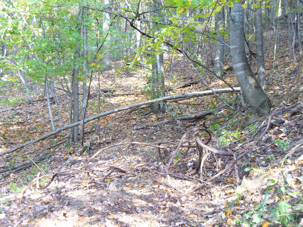

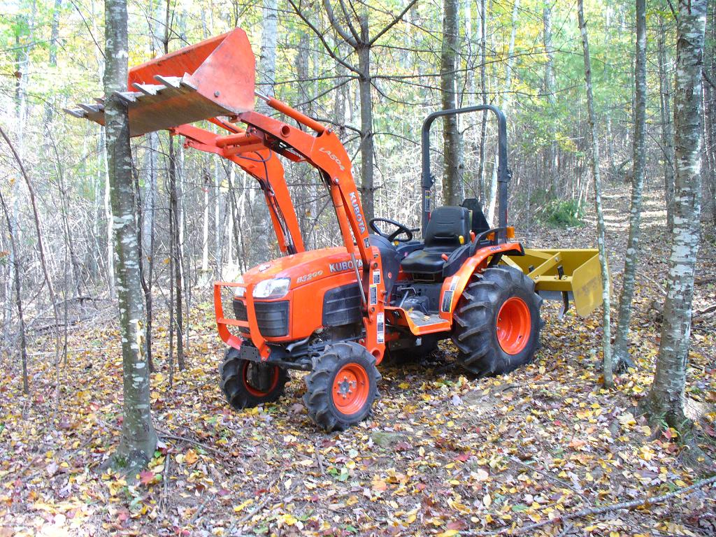

Here's a couple more pics. First is of the tree out and pushed to the side, second is the area now cleaned up looking down hill from the ATV trail. More to come in a bit...

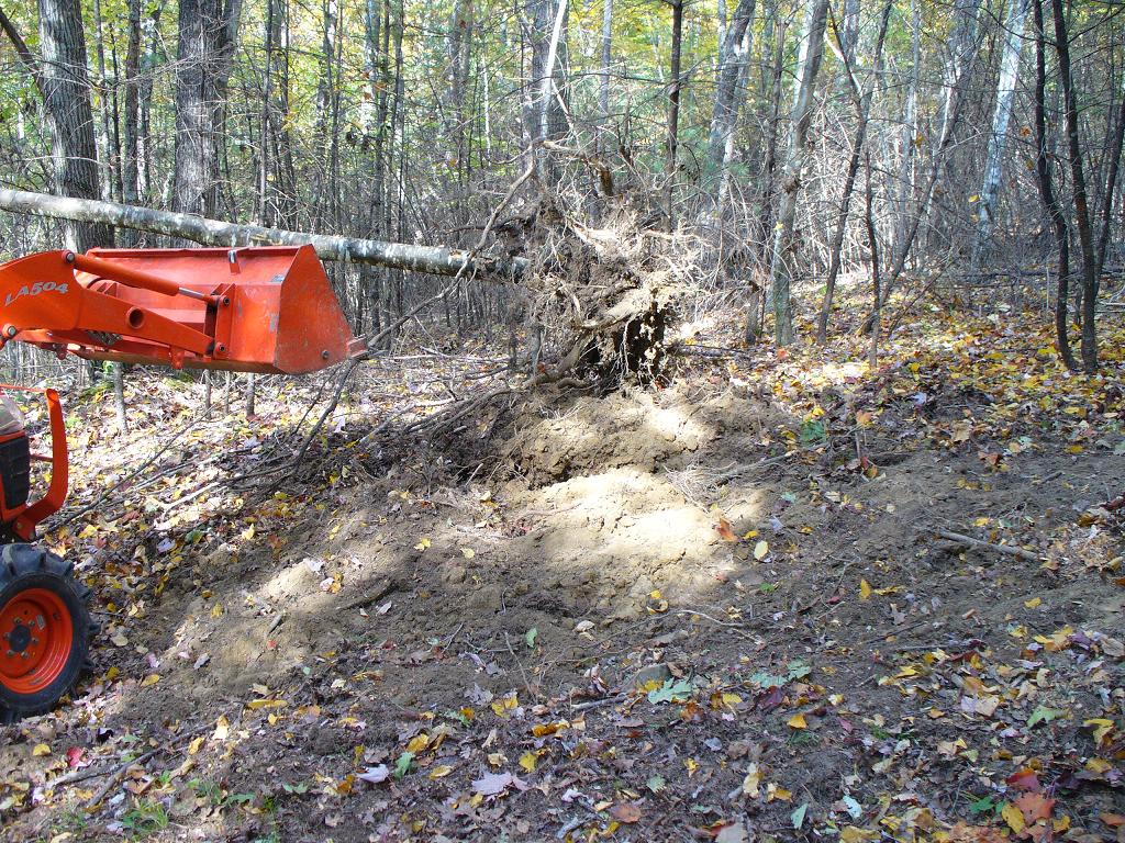

The next pics are from the start of the actual logging road, this is about halfway up the mountain, roughly 3000' elevation. First pic is of a locust tree I pushed out, this is about the biggest I've ever done with this tractor, 8" DBH and about 50' tall, I don't make it a habit to take out trees this size but this one came out pretty easily. Next pic is on the old road bed. The area right in front of my tractor had been washed out so I cut out a little fill dirt and rebuilt that section. I'd also already been through and push out most of the sapplings.

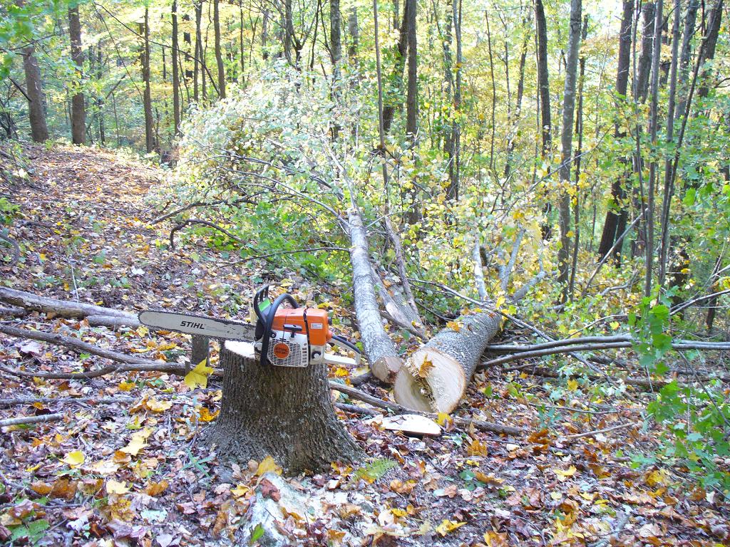

So I was going along pretty good and had gotten a few hundred yards cleaned up when I got to this mess. A pretty good size poplar right in the middle of the trail, time to get out the saw. I made the cut on the small tree but it wasn't leaning the right way and too small to wedge over. Luckily I was able to drop the big one on it and knock the whole mess down the hill. I started to flush cut the stump but my chain was marginal, so I decided to leave it. I'll bring one of my larger saws out and cut it flush in the next day or two.
