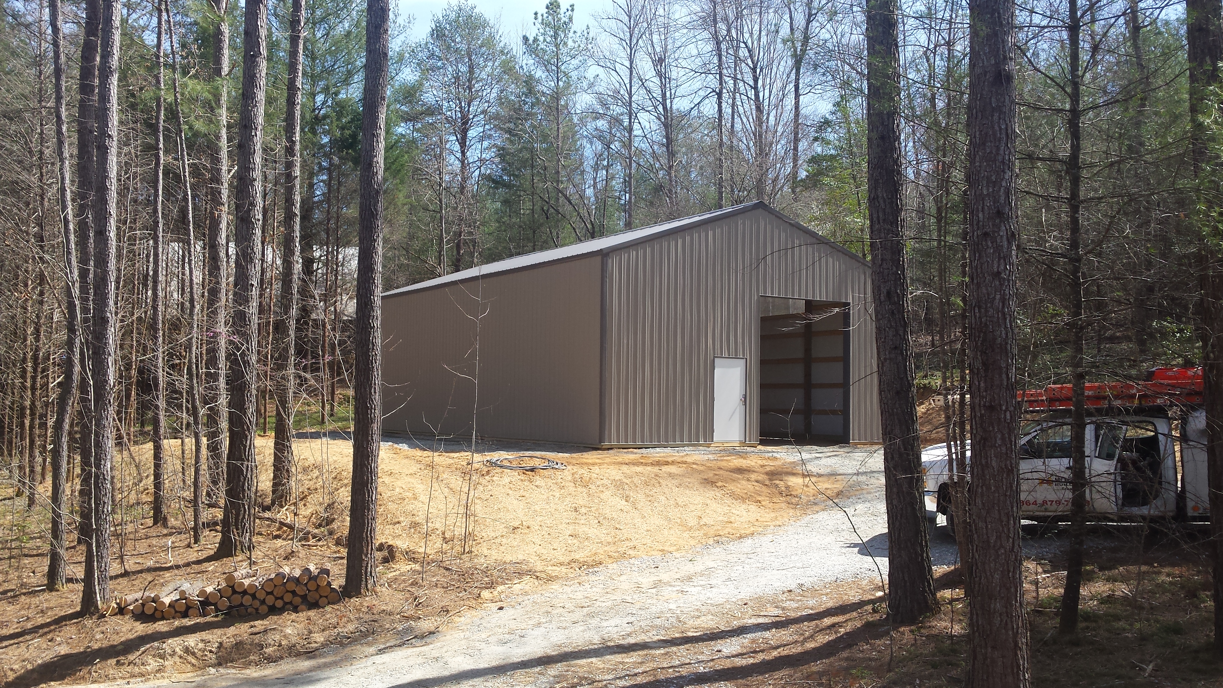

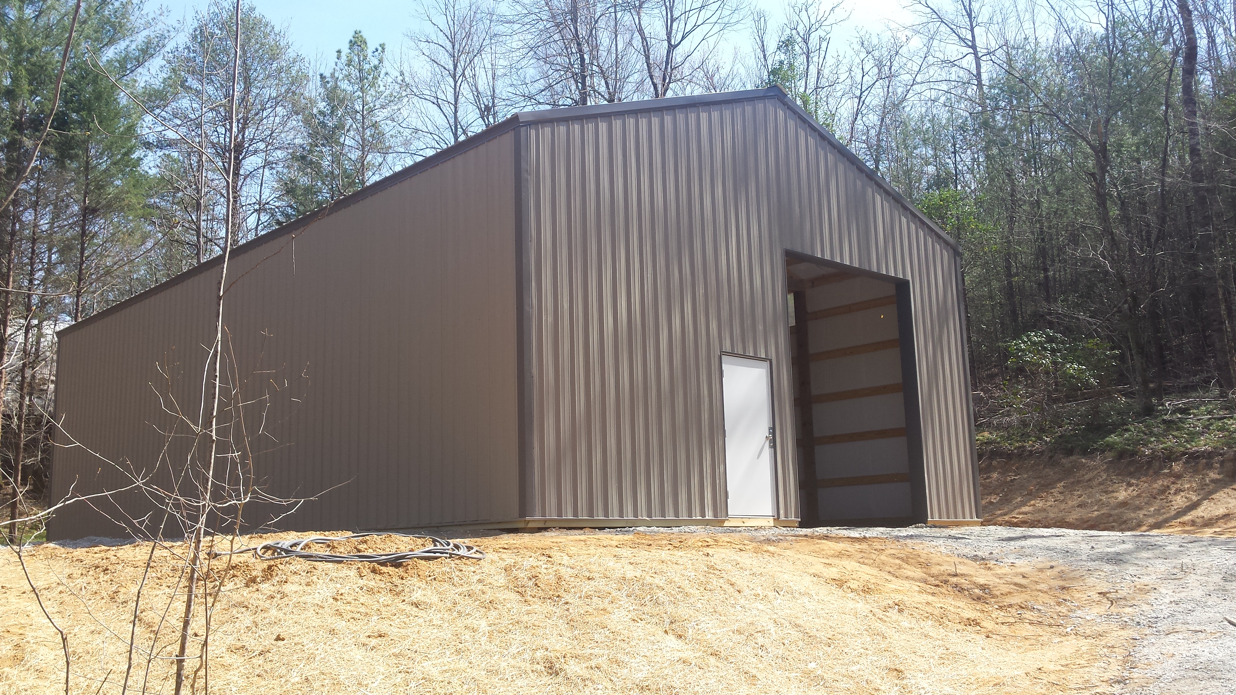

Thanks for the advice. I'll have to address the compaction issue first. As of now, I plan on watering the soil 3 times a week for the next 1.5mnths, and then will rent a plate compactor and spend a good day compacting the 4in of crusher run. The psi rating, which I had not thought of, will get increased as well.
Short of pulling the soil back up and compacting in lifts, this is the best I can do. You can see the grade and building in this pic-
A plate compactor is not capable of penetrating 4" of gravel to compact the underlying soil. Watering, while it might cause soil to erode and fill voids actually is harmful because it moves the soil particles apart. This results in less bearing capacity and settlement when the soil dries out. You need enough moisture for the soil to form a ball when you squeeze it in your fist. Any more and you have to dry the soil out before compacting. The best (only) way to compact soil is in lifts. 3-4" for a plate compactor and 12" for large ride on equipment.
