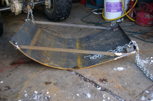

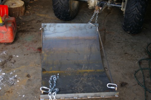

Heres one I had made gor my ATV and would work as well with the tractor. Works well for me......

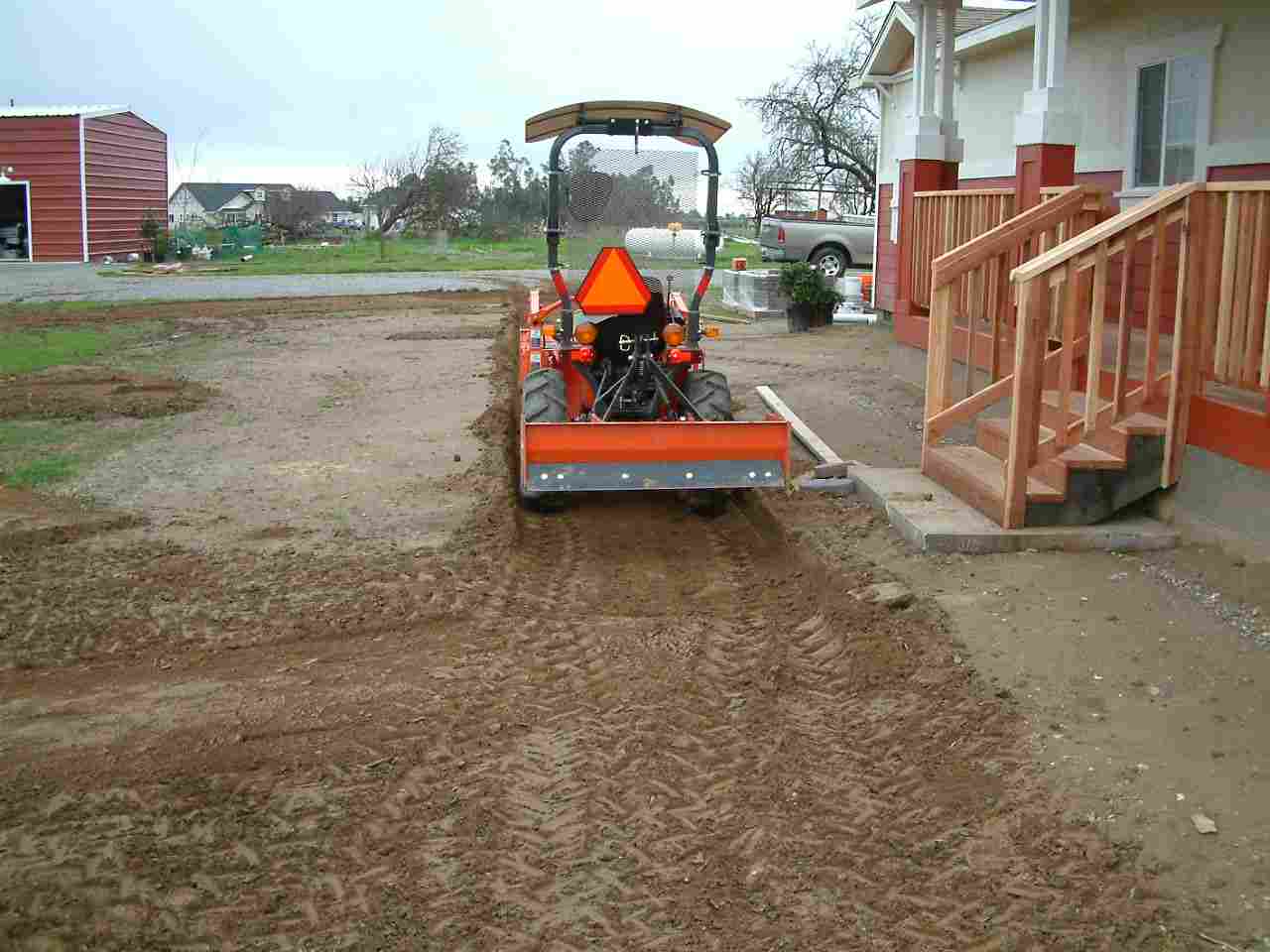

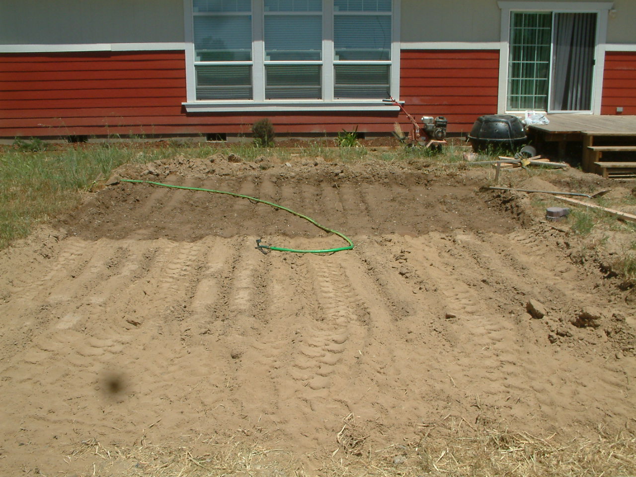

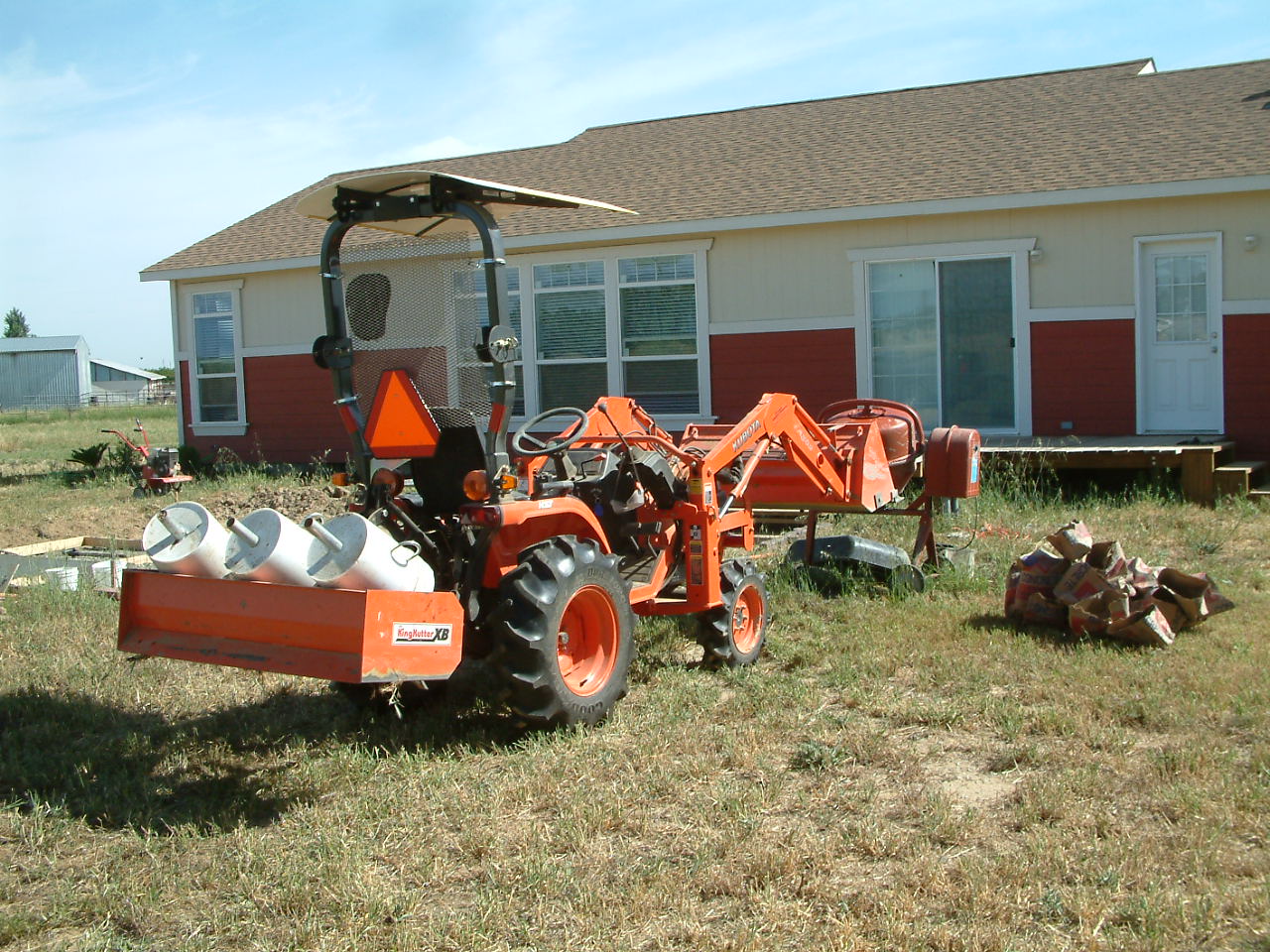

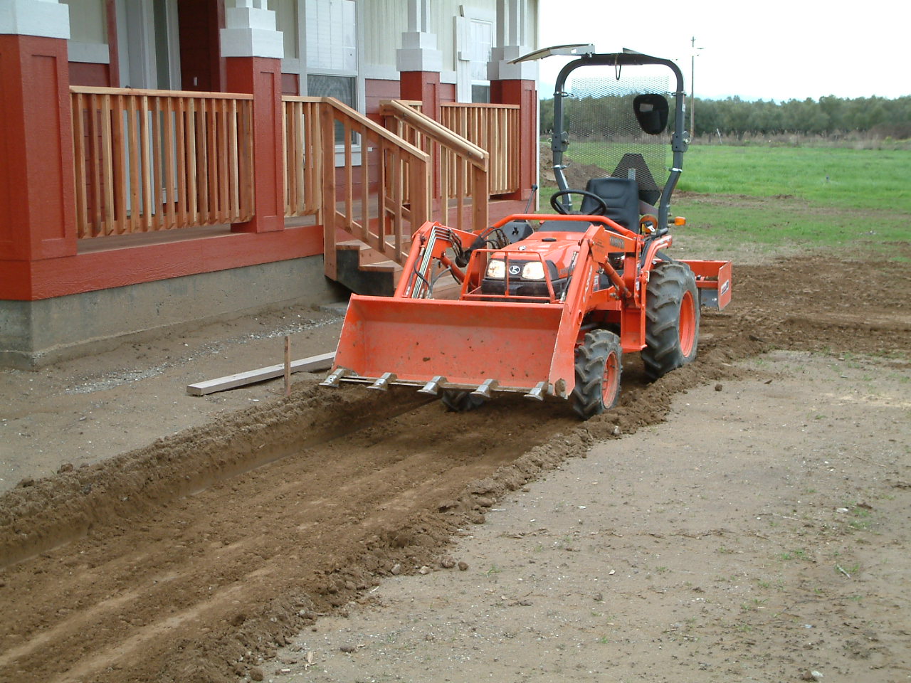

Here's a couple of photos showing my B7510HST and LA302 FEL (4-ft wide) doing some excavating around my new house.
The first two photos show excavation for a paver block walkway. The last two show the FEL work done for a backyard patio.
The box blade and FEL are a good working combination that makes this kind of job go quickly. I add about 360 lb of concrete weight to the box blade to make it bite better.
