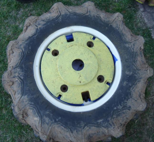

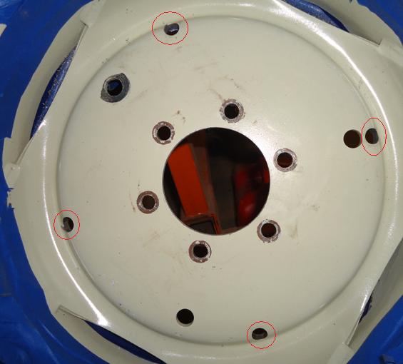

I made a weight bracket to hang 5 42lb suitcase weights on the front end and purchased some wheel weights designed for the rear of a John Deere 4400 combine which weight a whopping 158lb EACH.
Needed to drill a new set of holes in the rims (in a ribbed section, using a mill and 1/2" end mill, goofy spacers etc). Weights fit the depth and diameter of the rims perfectly!

/ Rear Wheel Weights? #9
Those look terrific, and the difference in performance will be impressive. Great work, and nice find.
How do you mount that assembly? Do you attach the wheel and then install the weights, or put the weights on the wheel and install that?
Wheels to tractor then weights to wheels with long 1/2 bolts.

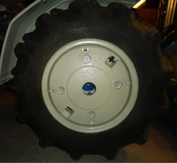

Weights are all painted up, will let them dry for a couple of days then mount them up.
Will post pictures of them on the tractor when I get to that point.

Wheel weights mounted up and DONE tonight.
Attached a pipe to my loader with some chain and clamps and just drove up to the wheels with the weights on the pipe. Worked out real well.
