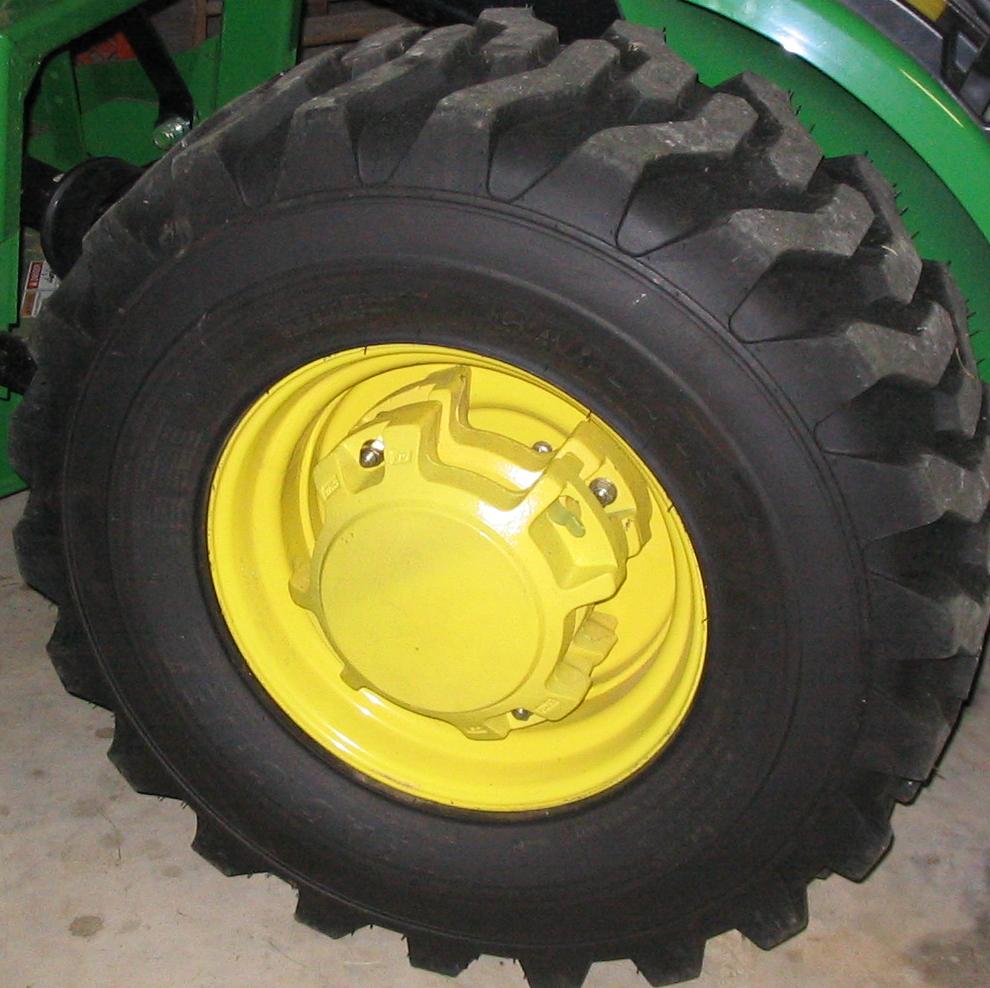

I would imagine that the 2720 uses the same weights that they sell for the 2520. These are 60 lb weights and use two carriage bolts apiece.
Deere says you can use up to three weights per side. I have three weights per side on my 2520 and they are working out fine.
