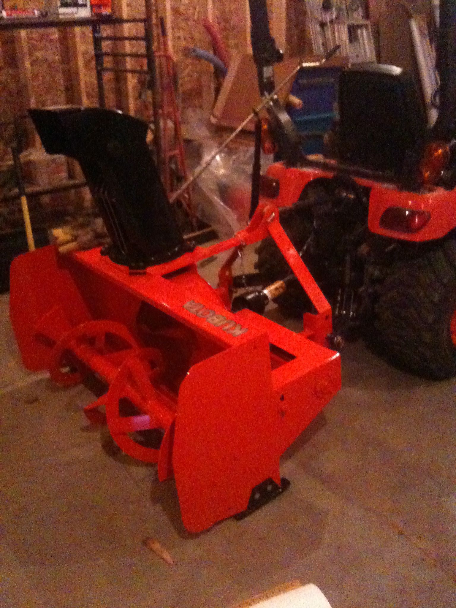

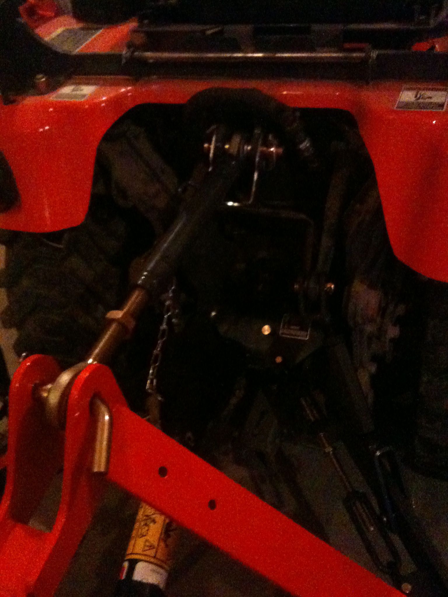

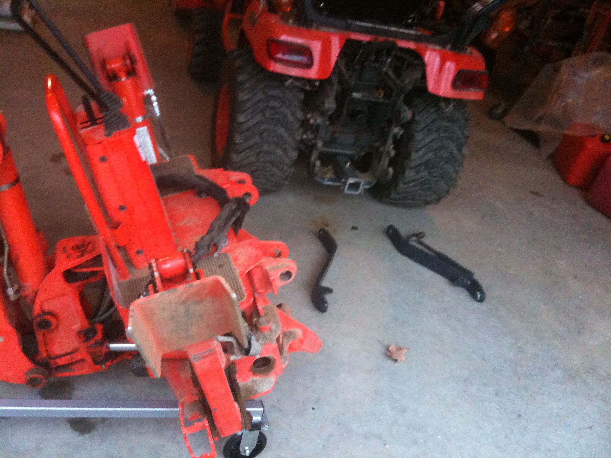

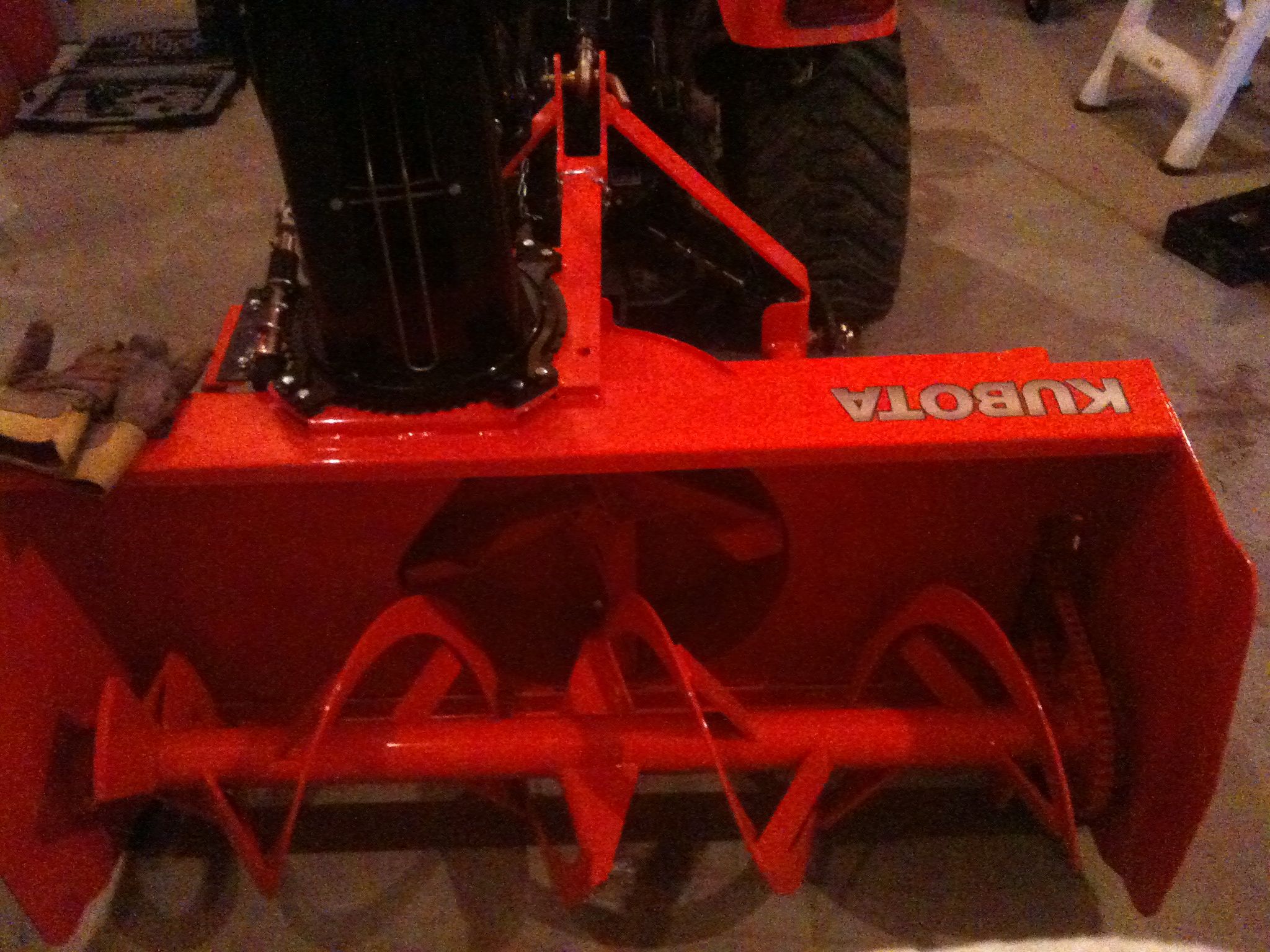

OK, as promised, here are a couple of photos of the installation of my B2789 snowblower. First, taking off the backhoe and installing the 3-point hitch for the first time, and then, the blower itself. (Warning - you need to get your own hitch pin for the top link where it attaches to the blower. The 3-point hitch comes with one for attaching the top link to the tractor, but not for the other end - and make sure you get one that is (a) 3/4" in diameter, and (b) long enough.)
It was a learning experience for a first-timer to be sure, but I think that next time will be a cinch! (It helps to have a floor jack so you can adjust the 3-point hitch arms so as to make the blower level from side to side.) It was also a bit of a surprise to find that the grease nipples had been painted over at the factory (had to scrape the paint off), and so I am suspicious that they never put any grease in at the factory. (So don't forget to grease everywhere they tell you before using it.) I'm also glad the dealer cut the drive shaft to length for me, as it seems to be a bit of a job to get it right.
The instructions for the blower, overall, were not very detailed, but we got through it. We'll see how it works soon enough!
BTW, the one photo showing a receiver hitch is the hitch I got from BXpanded.com, which fits great. I will be using it in the spring (after the blower and 3-point hitch come off) to pull my (3000 lb.) pontoon boat out of its parking spot. It is parked on a slope, on somewhat sandy soil, so we will see if my little 2700 lb. BX25 will do the job without spinning the tires!:cool:
