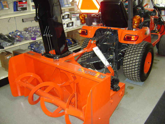

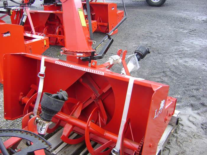

OK, so here are photos of the Pronovost Lynx 52 versus the Kubota B2789 (51"), and they both look very sturdy but the Kubota is about $600 cheaper after tax. (Both with manual chute rotation - just ignore the hydraulics on the Kubota photo - it was the only one I could find.)
So the question for me is, whose is better for a weekend cottager like me (thus minimal long-term wear and tear), and if the Pronovost is better, by how much? (I.e., is it enough to justify $600 more money for the Pronovost, which I could maybe use instead to buy the hydraulic chute rotator for the Kubota?)
I am also planning to have a look at the Pronovost myself (once I find someone close by with and in-stock model), which will also tell me a lot.
Out of those two, I like the looks of the Kubota better - looks like a stronger design in the area of the hitch mount.
There seems to be a big following of Pronovost blowers on this site, and I have no personal experience with them. However, since blower designs are all pretty much the same, quality can be rough-estimated by looking at weight...heavier is better, and Pronovost blowers are some of the lightest made in a given size class.
JayC
